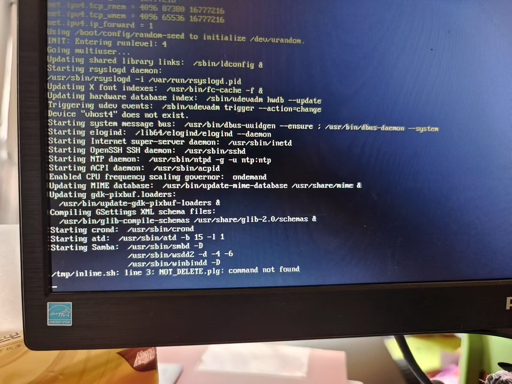

I have been stuck in "/tmp/inline.sh: line 3: NOT DELETE, plg: command not found" after booting up
Please help, I have been stuck in "/tmp/inline.sh: line 3: NOT DELETE, plg: command not found" after booting up, and cannot enter the login interface. Please refer to the following figure for details:

Thank you. I can log in in in safe mode, but in GUI mode, it remains stuck in the above code interface and still prompts "/tmp/inline.sh: line 3: NOT DELETE, plg: command not found"; How to log in normally in GUI mode and how to handle it?

That message is from the Unraid Patch Plugin, it is benign and safe to ignore. Will be fixed in a future update.
But for @husthuyx... Getting stuck there is odd though. The Patch Plugin is unlikely to be the problem, rather it is whatever is running next.  But if you want to rule it out, put the flash drive in another computer and delete this file from the drive:
config/plugins/unraid.patch.plg
Then try booting into Unraid.

It's a completely harmless message and it comes from the patch plugin, and no issues what so ever are related to that.
