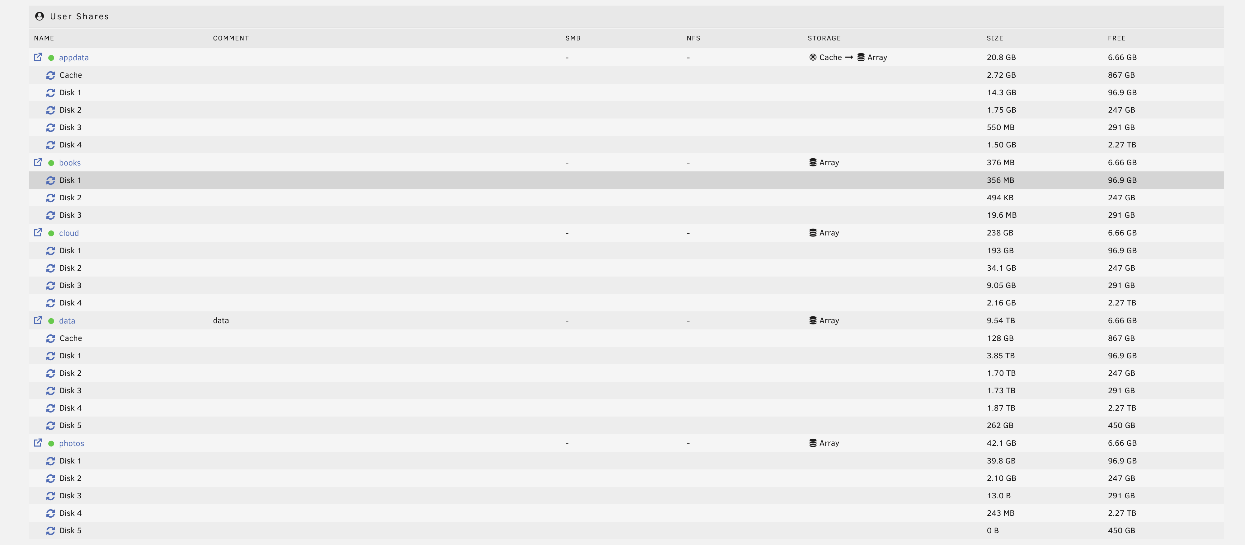

I'm having trouble and I can't seem to figure it out. Last night the power went down and the server obviously shuttted down. Once the outage went off, I started the server and found this weird error: (I'm using unraid 7.0.0)
I have my data user share (/mnt/user/data), and 5 disks containing the data. The thing is, for some reason the contents of my user share are in the disks shares but not on my user shares... which is what my docker containers use.

Is that normal? Could someone help me figure out what is going on?

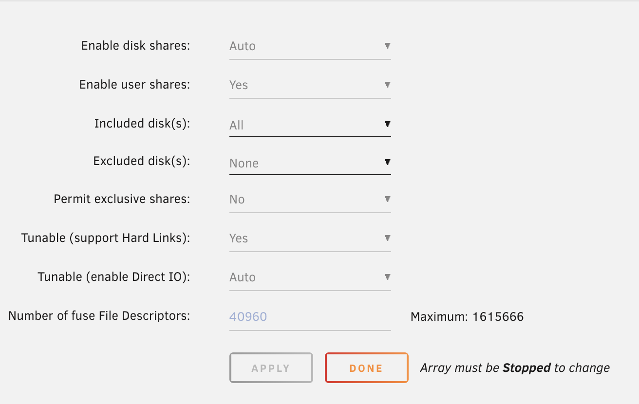

I don't really understand what you are asking, user and disk shares can both exist at the same time, but start by posting the diagnostics.
The diagnostics seem to show that an expected share,cfg file is missing.    I suggest you go to Settings->Global Share Settings and check that User Shares are enabled.   It might be a good idea to make a dummy change so you can get the Apply button enabled so that that file gets regenerated.
Hi @itimpi, thanks for your answer. User shares were enabled.
I'm stopping the array to make some change (idk, maybe set enable disk shares directly to yes). Notice that when stopping the array this pops up:
Which makes me think there are some issues with the mounted shares.

Probably not the cause of your problem, but I don't recommend enabling Disk Shares in Global Share Settings. You can lose data if you attempt to mix Disks and User Shares when moving or copying data.

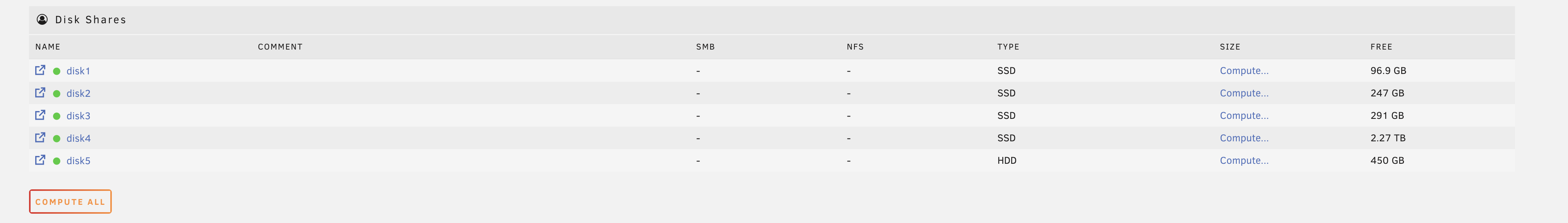

Hi, update here. I tried doing some change (I sleected all disks indiviudally instead of putting all on the global shares) and started the array (had to reboot it as it was stuck). data user share is still empty but it is inside the disks.

I still have the 'disks shares' on Auto, if I put 'no', might that it bring the user shares back? I don't want to loose the data that is under mnt/disk*/user
