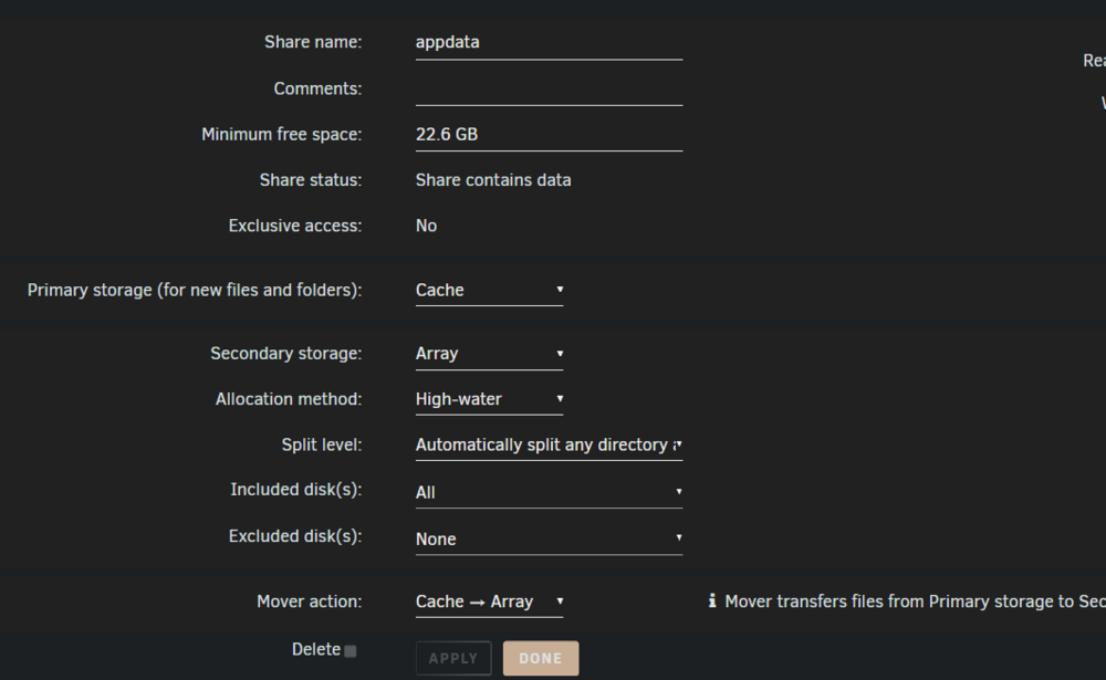

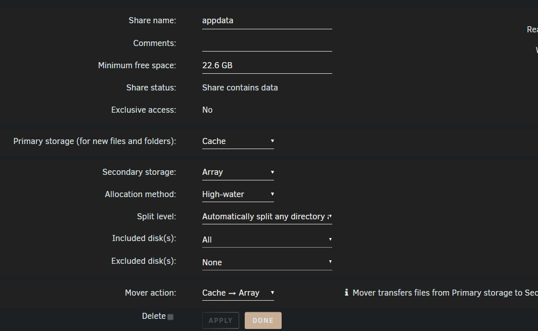

There are definitely files there. Im looking and comparing the files left on the cache vs what is on the array. The files are the same. Not sure why they aren't being moved. Here are my appdata share settings: image.thumb.png.da90e7450a2bb35c3a23cb08f263da28.png

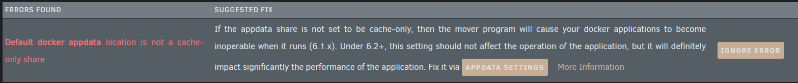

I had another question. Whenever I set the appdata share's secondary storage as array I get this error from the fix common problems plugin. Any ideas?
image.thumb.png.3a072163ce2d7ca6f28700d5e82e8446.pngimage.thumb.png.3a072163ce2d7ca6f28700d5e82e8446.png
Just noticed that your screenshot of the settings for appdata is definitely wrong. It says you are going to move it to the array.

So do you mean you removed them from cache, and not from the array? That is not what I intended.
You definitely don't want appdata, domains, or system shares moved to the array.
If you have Secondary set to array, you must also have Mover action set to go from array back to cache. That will allow them to overflow to the array if cache has less than Minimum Free.
But mover won't really be able to move them back to cache without disabling Docker and VM Manager in Settings so the files won't be open.
After you are sure these shares have no files on the array, the simplest thing to do is set Primary:cache; Secondary:none and just don't allow cache to get very full.
