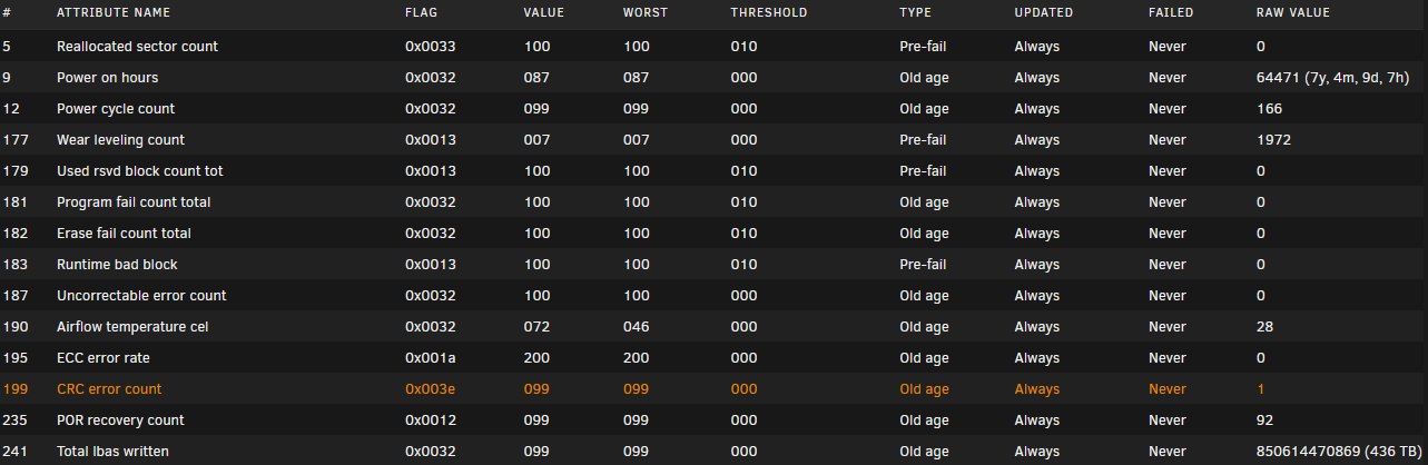

My questing is what king of life can i expect from these nvmes if I'm writing hundreds of gigabytes to it and than having it moved to the array.
Let me put it this way, my old  250GB 2.5" SATA SSD has over 400TB written to it and its still healthy.
Edited by MowMdown
