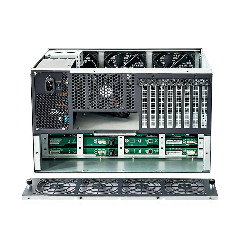

  2. I ended up requesting 2 custom cables 16awg 1st cable 330mm - 1st Molex at 215mm the next one at the end 2nd cable 330mm with a Molex at the end Im going to give this a shot and hope i dont have an issue. If i do i will order andother cable and use all 3 outputs of my PSU I wanted to keep one output in case i decide later to use the internal caddy of 4 Sata SSDs
  3. Im getting slow download from unraid to pc, it starts well than slows down. ggonxhi-nas-diagnostics-20250318-0315.zip.crdownload
  4. Hey appreciate the feedback, Yes these do come with sata on the motherboard side. I purchased these case with the cables so they are included. The SF750 only come with one cable that has 3 Molex headers, and unfortunally its short cable. But my question is can i run this with one cable to 3 Molex outputs? or should i use 2 lines to the PSU? Thank you

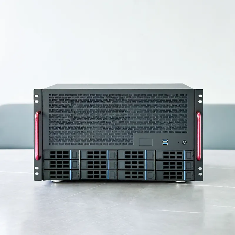

  5. Can someone please make the JMCD 12S4
  6. Hey Guys i recently purchased this JMCD 12S4 case with 12 Bays. I plan on running unraid and currently have a corsair SF750W. The NAS backplane uses 3 molex inputs for power, SF750 Rating +5V is rated at 20A 130W +3.3V is rated at 20A 130W +12V is rated at 62.5A 750W +5vsb is rated at 3A 15W PSU also only have 3 Sata/Pate connecters Will i be able to run these 12 drives from this? Do i need to run individual Molex lines for each of the Backplane? or Can i use 1 or 2 lines. Thank you
