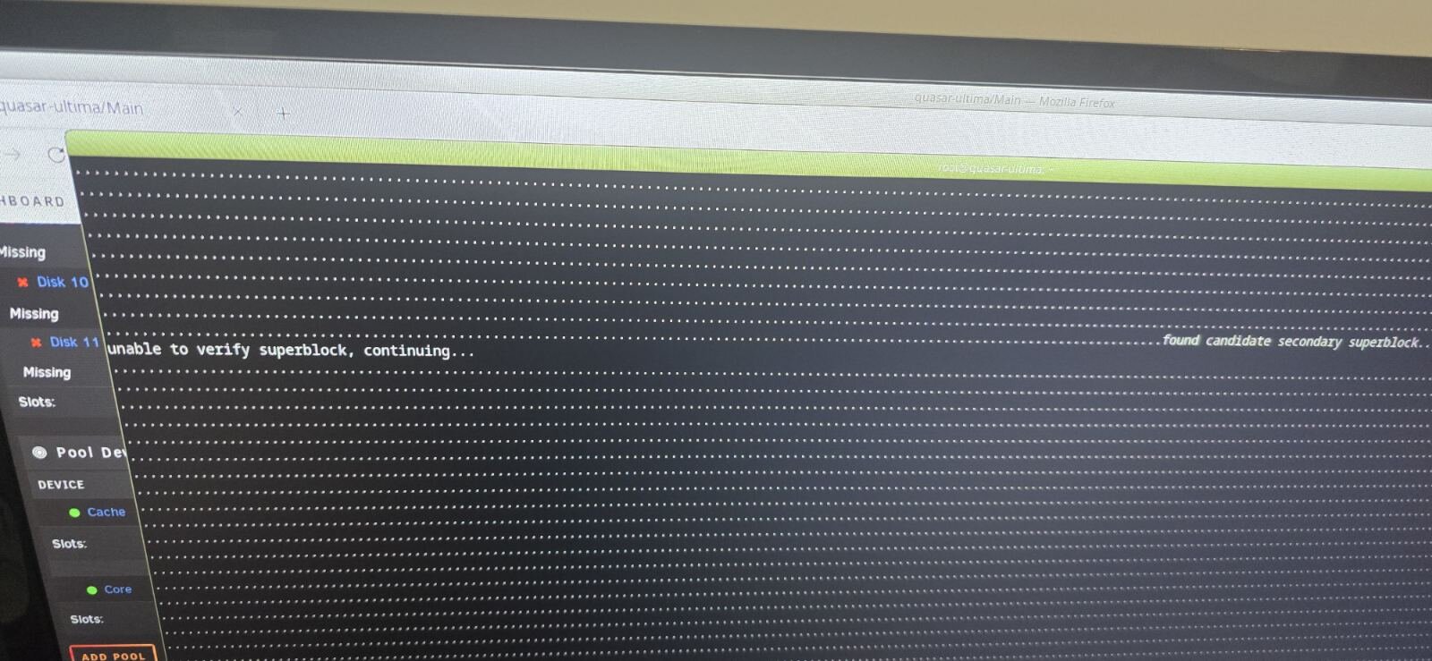

13 hours ago, NLS said:
If someone can suggest a specific live rescue distro and specific tool within it, that can help me do the recovery work from within Linux
If Unraid doesn't work to repair the filesystem, it should be the same with any other Linux distro, sorry but this thread is rather long, can you post the exact command you used and the output you see when trying to repair that filesystem using an Unraid trial key?
I will try to re-do it but check if the following already covers you:
The exact command was xfs_repair -v and the path of the device on that specific computer (/dev/nv-something).
The output was all dots (scrolling pages and pages), with sporadic "found candidate superblock" followed by "unable to verify superblock".
Which I think was also the final ending of the output.
Here is a casual photo I got when I tried originally, a few days ago.
I take it that we "fight" to not use the Windows already recovered data because the lost attributes make real use of the data very difficult?

2 hours ago, NLS said:
(/dev/nv-something)
By that output looks like you didn't specify the partition, e.g., if the device is nvme0n1, the command needs to be
xfs_repair -v /dev/nvme0n1p1
Also, if the command was correct, and it still didn't work, you can be pretty sure it will be the same in any other Linux distro.
Have you checked for nvme firmware update?
When I was building a Photoshop Windows PC for my wife a few years ago, I had to update the firmware before I could reliably get both nvme going at the same time.
Yes that was correct. I did specify properly what to scan.
I find it very weird that almighty Linux (the light irony is not targeted towards anybody here or even UNRAID - I am not leaving UNRAID, I have promoted it to so many people), cannot recover anything on a supposedly very resilient fs like xfs, while a simple tool I bought on-line in Windows DID (most probably) recover the files and didn't even whine it had an issue or difficulty.
If that is correct, and the device was connected to an m.2 slot, not using for example a USB enclosure, it's basically certain that you will have the same results with any other Linux distro, with the exception of possibly older or newer xfsprogs making a difference.
For everything except appdata, New Permissions will make owner and permissions as they need to be. I think some containers might even fix their own appdata permissions when they start. Might have to take each container one at a time, maybe compare them to the permissions set on a new install of the container.
Yes, on board a PCIe card or directly on-board (I don't remember), not USB. Will do it again though (my most "serious" of the two NVMe is just sitting waiting for the best treatment of recovery - the Windows based tool just read it, didn't write anything on it).
I did try an older (apparently) xfs_repair using a live distro, and it didn't even attempt to fix the disk, claiming I need a newer version because of I don't remember what. The version that produced the result above (i.e. attempted to fix but failed), was the one within UNRAID 7.0.1.

So for this thread, a weird thing. I now have managed to boot UNRAID on a new motherboard (details on other thread), so I thought I should install my two NVMe.
One large NVMe was formatted, used purely as cache anyway (so no static data I care about).
One small NVMe very important to me, as it holds appdata (which I had backup though), domains (of which a single VM mattered much, which I DID NOT have backup of the whole VM, although I do have backup of parts of the VM taken from inside the VM) and system.
If you read this thread you will see that I had various issues to recover the data etc.
Well in unassigned devices on my "new" server, I did see both NVMe. The big one was expected (as it was re-formatted), the small one... well it showed up properly as XFS, free/used space... so I clicked to see the contents. AND I SAW THE CONTENTS!
Not really sure what to think, I made a new configuration (preserved only array, not cache pools), and so I assigned cache to my big NVMe and the second pool to my small NVMe...
And started the array (with docker and VM stopped).
Array started fine!
I checked my shares and it still remembered that appdata/domains/system should be on my second cache pool.
So I started docker. It started! I saw my containers and the few auto-start containers DID start!
Then I started KVM. It started and started my VM!
Apparently Windows was right to believe the xfs disks where ok.
They just worked.
So after huge complications I am back to a working server!
Thanks everybody that tried to help.
