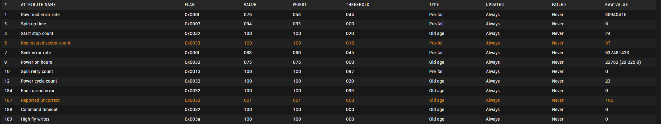

I've got a server with 4tb drives or smaller and having read errors on one of my data disks.
would it be possible to replace the parity with a new 12tb drive, then once the parity has been rebuilt on the new drive,  replace the bad data drive with the old parity drive?
Thanks in advance!

That would be a Bad Idea™️
Replace the failing drive first
ok, thought so. the idea of buying a new 4tb drive doesnt fill me with joy!
If you can get the data off of it, you can just new-config parity with the new 12tb parity drive - assuming you trust the rest of the drives
The parity swap procedure is designed for this exact Use Case as long as you only have 1 parity drive.
if you have 2 parity drives it might be a little more complicated - and if so (or you have questions) post diagnostics so we can see your exact configuration.

That is normally the way you would do it. In fact, the only way you can get parity swap to work when no disk is already disabled is if you disable the disk first. From that link:
IMPORTANT!!! This procedure REQUIRES that the data drive being replaced MUST be disabled first. If the drive failed (has a red ball), then it is already 'disabled', but if the drive is OK but you want to replace it anyway, then you have to force it to be 'failed', by unassigning it and starting and stopping the array. Unraid only forgets a drive when the array is started without the drive, otherwise it still associates it with the slot (but 'Missing'). The array must be started once with the drive unassigned or disabled. Yes, it may seem odd, but is required before Unraid will recognize that you are trying to do a 'Parity Swap'. It needs to see a disabled data disk with forgotten ID, a new disk assigned to its slot that used to be the parity disk, and a new disk assigned to the parity slot.
