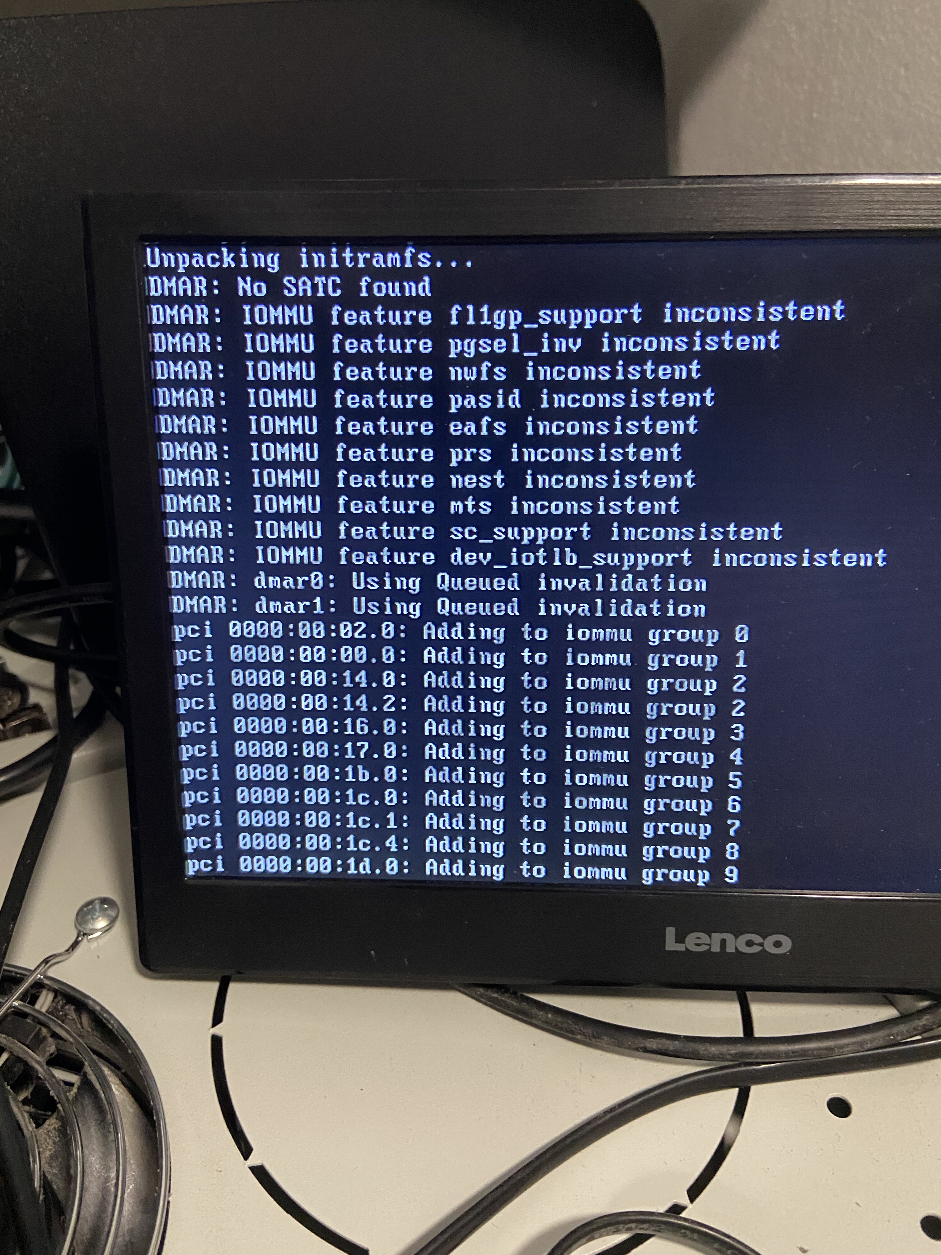

my UNRAID server (which was happily running the last couple of years) seems to have restarted over night and now doesn´t boot anymore.
It starts with the boot precedure, but then it´s stuck at the screen you can see attached.
I am able to successfully boot into non-GUI safe mode, but I don´t know where to go from there.

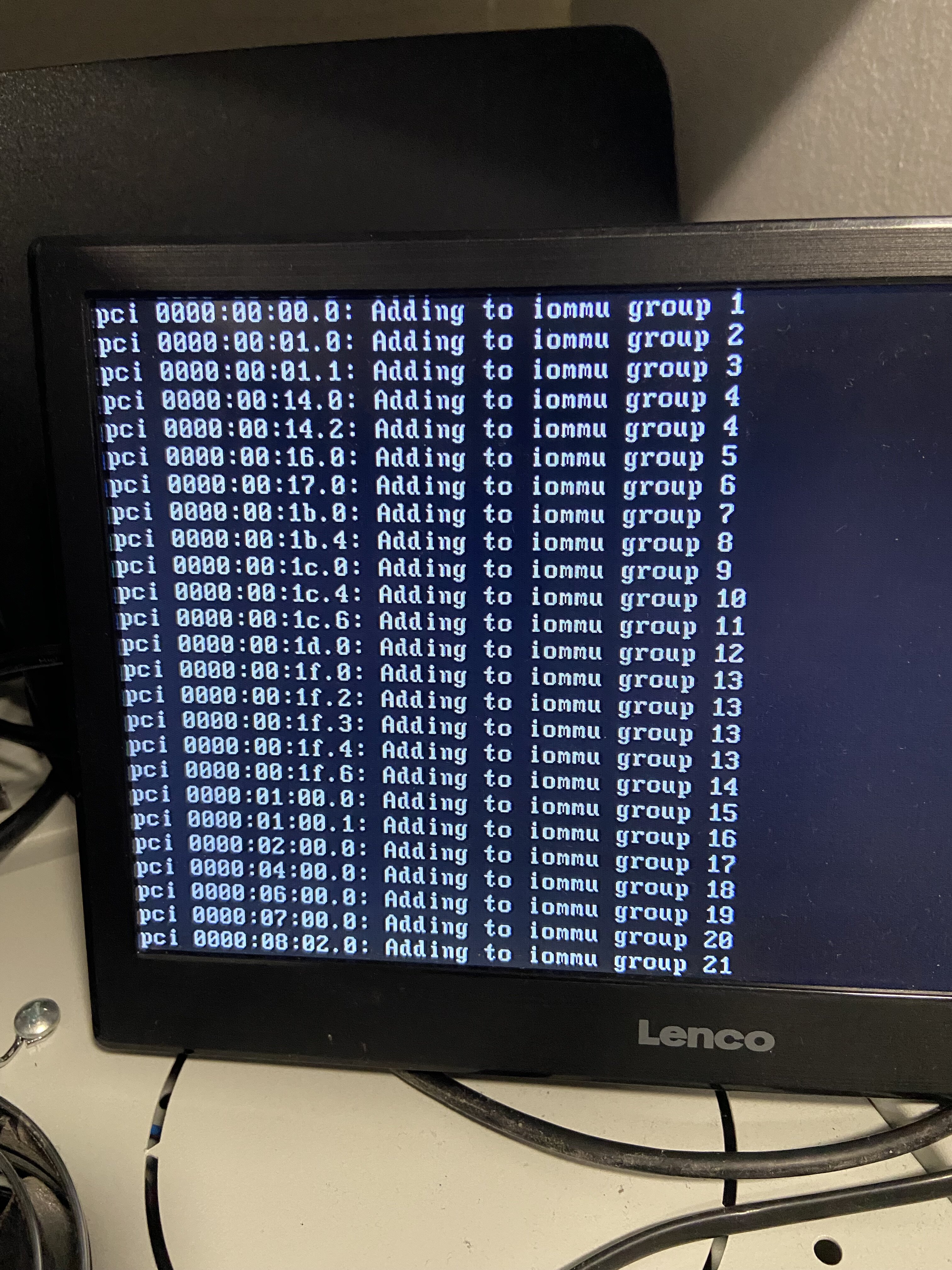

With all the cards removed, trying to do a standard boot gets stuck into this screen now:
Try booting with a different flash drive using a stock install, no key needed, that will confirm if it's a server or config issue.
OK, that works.
That suggest the config is the problem, but in case it's your flash, try recreating the flash drive, first backup the current one, then recreate it using the USB tool, confirm that flash drive also boots with the stock install, and if yes, restore only the /config folder from the backup overwriting any existing files.
Seems to be the issue is a mixture of hardware and config issues.
I managed now to boot up the system will all drives attached and the array´s running fine.
However, the network config seems to be screwed up as I´m not able to ping the server from the outside and also not being able pinging from inside to the outside.
I think there´s some routing mismatch from configurations from the past and I´m not able to change it.
You can delete/rename /config/network.cfg and reboot, that will make the server go back to default DHCP settings.
Thank you - that fixed it! We´re back in business!
