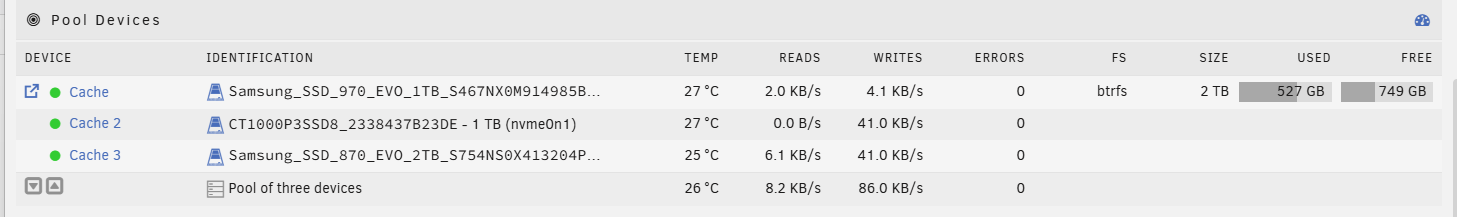

Hello !
back on the subject :
I have added the 2T SSD, and here the result :
It seems that USED and FREE representation are not correct.
Size is 2T, but if add USED and FREE space, i don't have my 2T of space ?!
mayeb i'm wrong ?

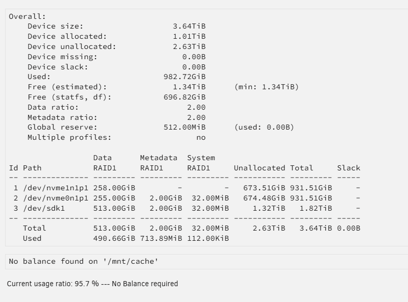

What's the pool configured as? RAID1?
BTRFS can technically work with different sized drives but will lead to quirks like that not really knowing what space it has available to work with. Also tends to be less reliable.
Did you click on Cache and do a Balance?
yes it is RAID1
it seems taht balance is not necessary ?
That a btrfs issue when used with an odd number of devices, but you will be able to use the 2TB, and the stats will get closer to real as the pool gets filled up.
Thanks.
As i'm using mover plugin (with % for disk used from moving data from cache), i guess it will based on false free space estimation ?
It will depend on what is uses for the check, I would guess df or similar, and in that case yes, it will be based on what you see.
