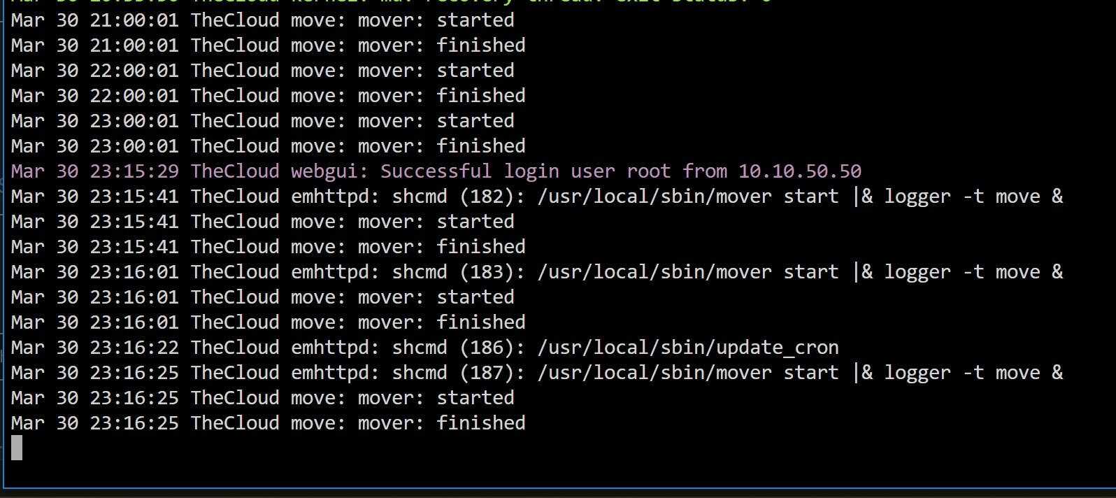

I had it scheduled to move daily and it appeared to not have moved. I changed it to move hourly on the hour. That setting appeared to have saved, but still it's not moving. I've tried clicking the Move button at the bottom of the Settings page to immediately invoke the Mover, but nothing happens. When I go to Mover Settings and try the Move Now nothing happens.
I've checked the logs and it says the mover has started and immediately finished.

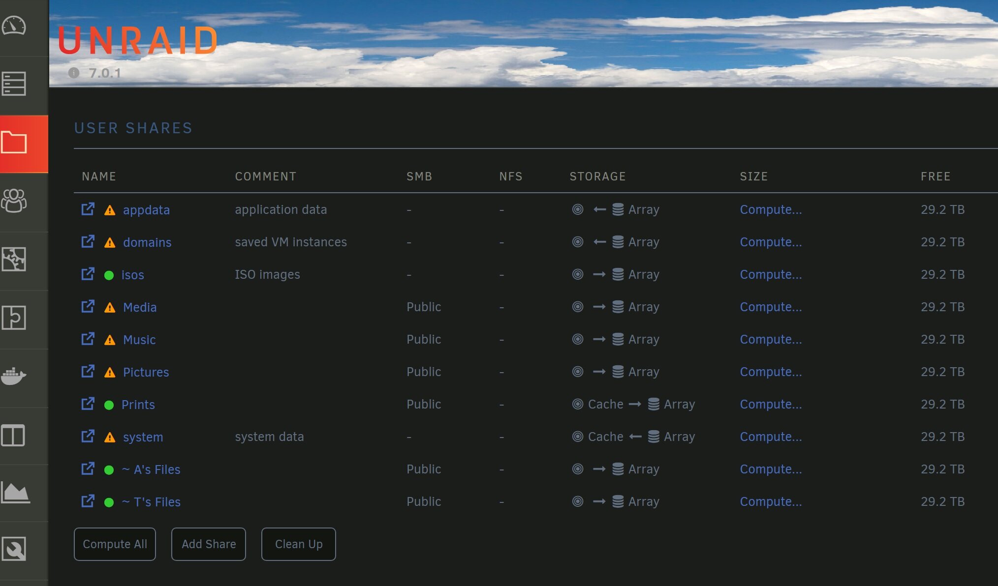

Looking at the diagnostics it look like there is no Primary Storage configured for shares that have files on the ‘cache’ pool.    Check the settings, and if necessary make a dummy change and then hit Apply to cause the configuration file to be recreated and then post new diagnostics.

Here's my Shares tab.  I've basically ripped some movies and then saved them to my Media share.  But looking at the Storage column, it appears that it goes right to the array.  Even though my cache drive was filled with every transfer.
@itimpi I'm not following.  "no Primary Storage configured for shares that have files on the ‘cache’ pool" makes since I think since I've moved files over to my Media share.  But if that was the case, why is the Cache filling up?

I'm basically using the shares that go straight to the array as backup.  I don't really plan on accessing on the regular.  But reading the link you attached, should I have everything go Cache->Array?
No, you want appdata, domains, system shares to stay on cache. And those are already all on cache.
Set them to Primary:cache; Secondary:none.
The only other shares with files on cache are Media, Music, and Pictures.
Set these shares to Primary:cache; Secondary:array; Mover action:cache->array.
Okay, I changed all the shares I created to Cache->Array and the mover started moving.  That fixed my initial problem.
Just for clarification, you said " appdata, domains, system shares to stay on cache." but unnless you're looking at something I'm not, I see appdata and domains are on Array and system is Cache <- Array.  Just to confirm, I should change all these to Primary: Cache and Secondary: None?

You are probably looking at that screenshot you already posted, which is based on incomplete settings for your shares. And even if they were complete, it would only be the settings you see there and not where files actually are currently.
17 minutes ago, ARAMP1 said:
7.0 upgrade?
Seems upgrade didn't always complete some share settings that were not needed on previous versions.
