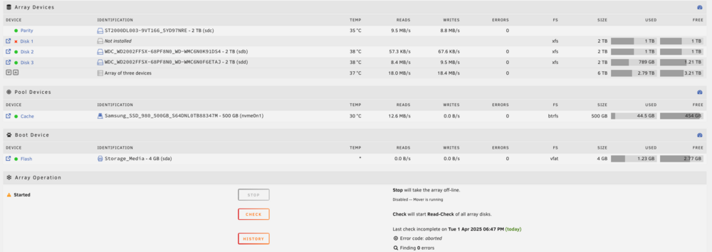

Unless I'm missing something, all disks mounted.
Disk is mounted, it's also disabled, but that's a different issue, I don't see an extra disk being detected, what happened to old disk1?
I don't know what append to Disk1, it is still physically in the server and I din't do any thing but rebooting the server and starting the array in maintenance mode since the disk has been disable. I got a message with quite a few errors for the disk but has I came it was already disable.

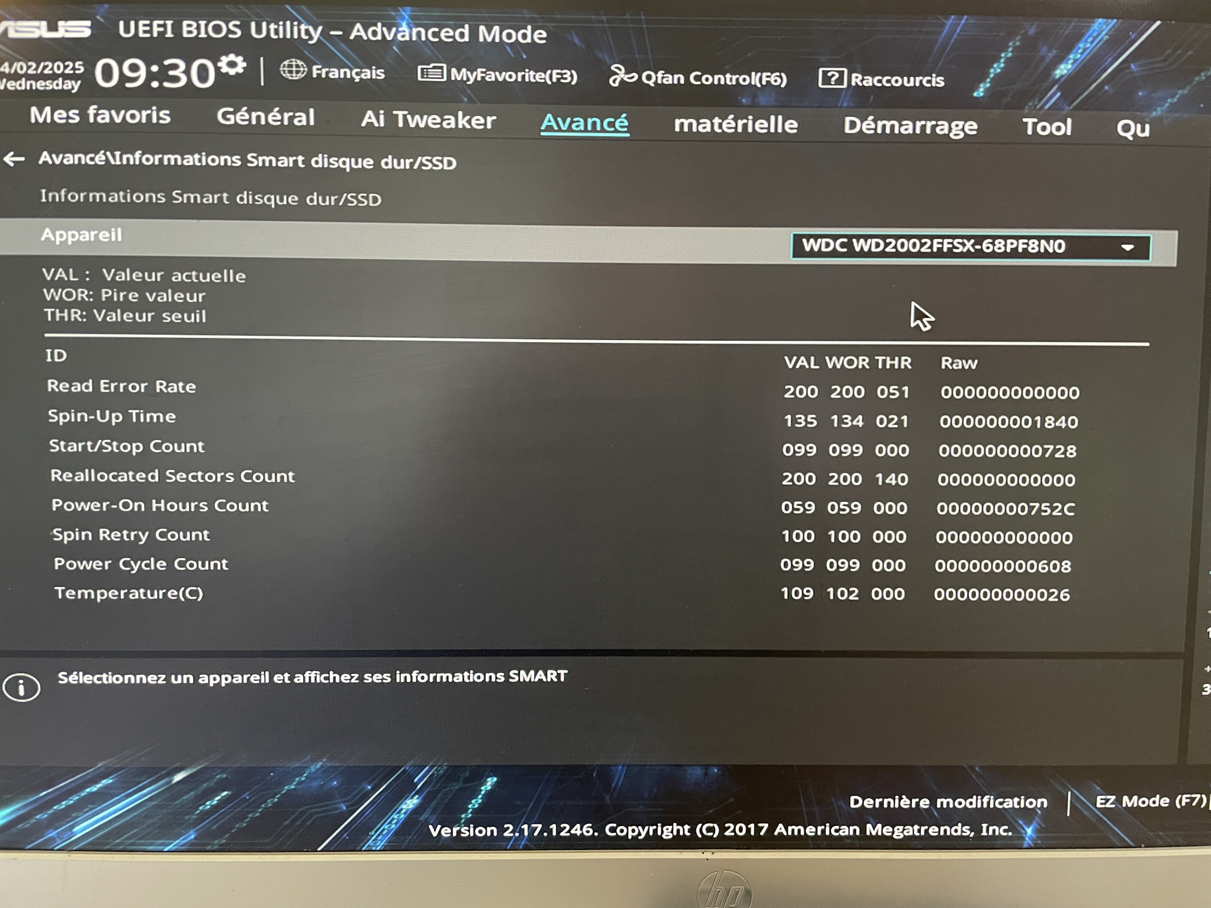

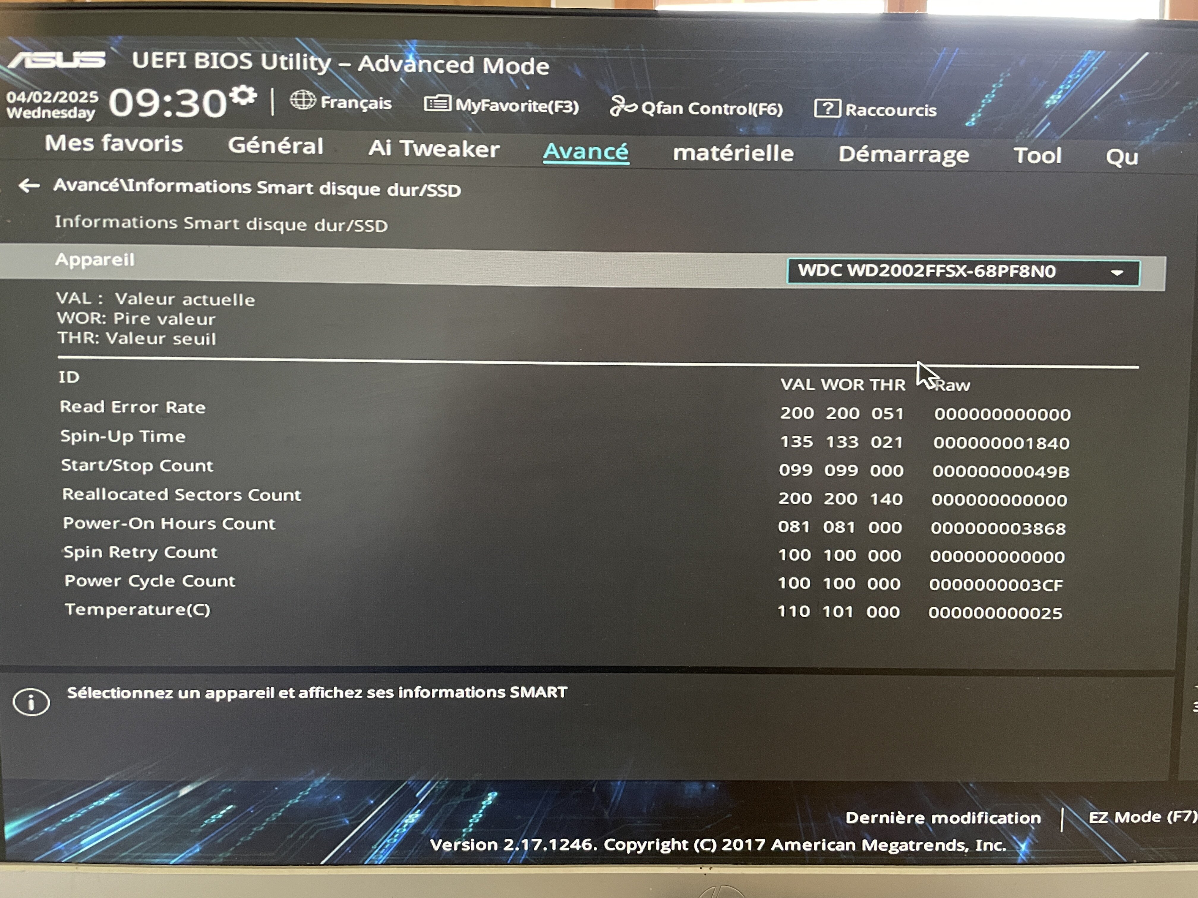

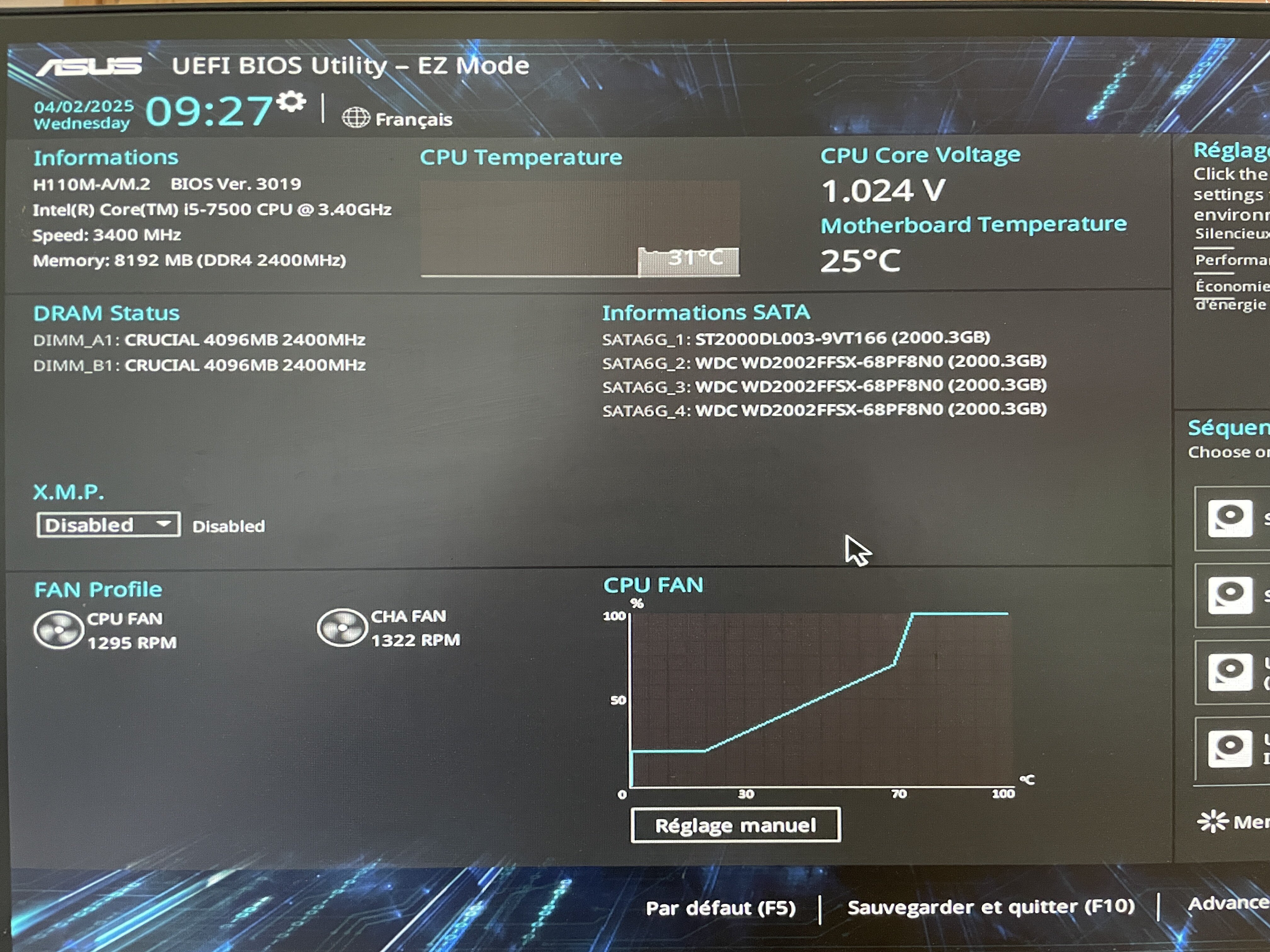

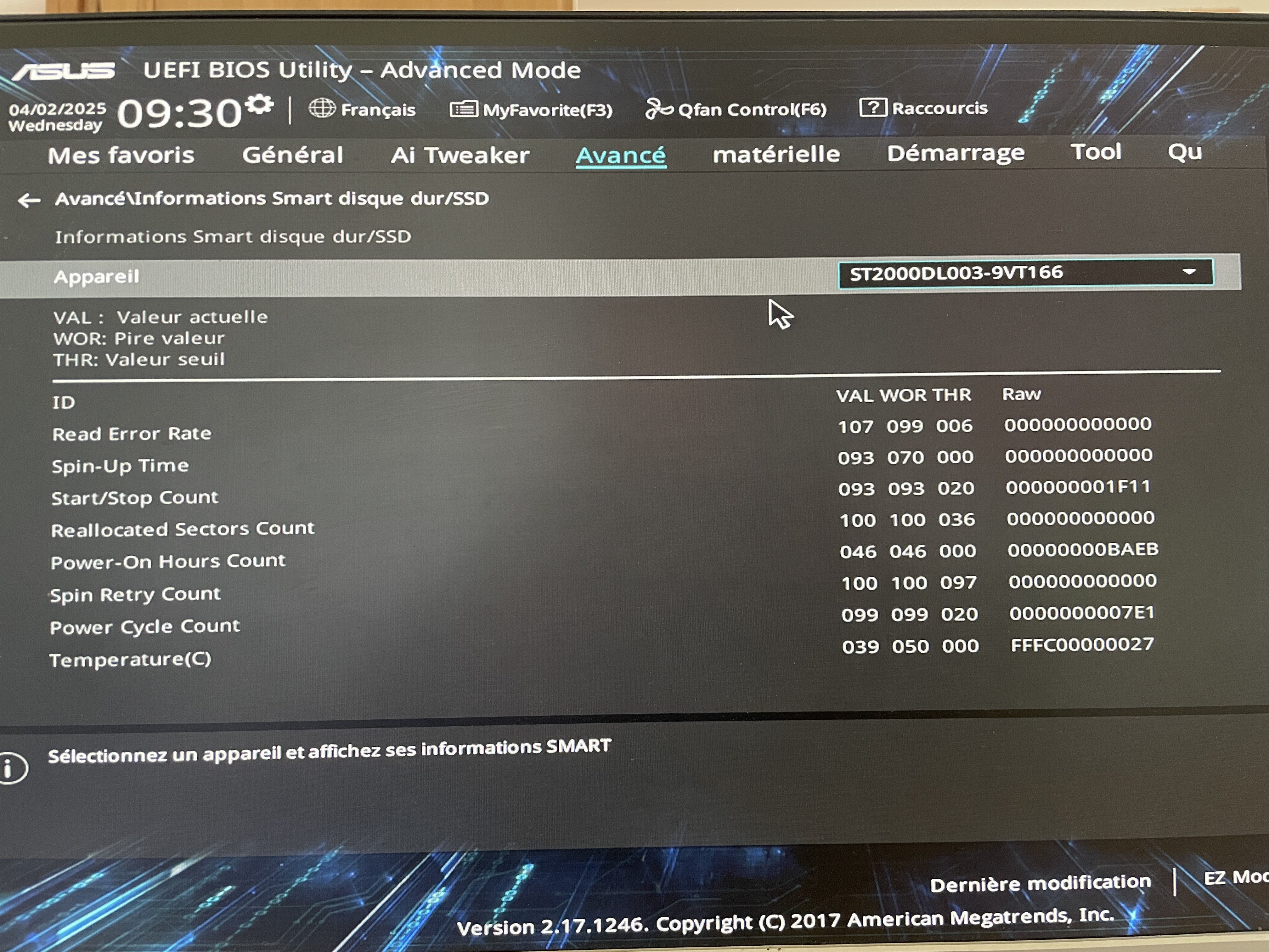

I have checked each connection wich seems to be fine and also switched every single cables and ports on the mother board ti see if the failure moves. It didn't changed any thing.
unraid-diagnostics-20250402-1025.zip
Swap cables between the missing disk and another one, then see if it's detected in the board BIOS, if not, it's likely dead.

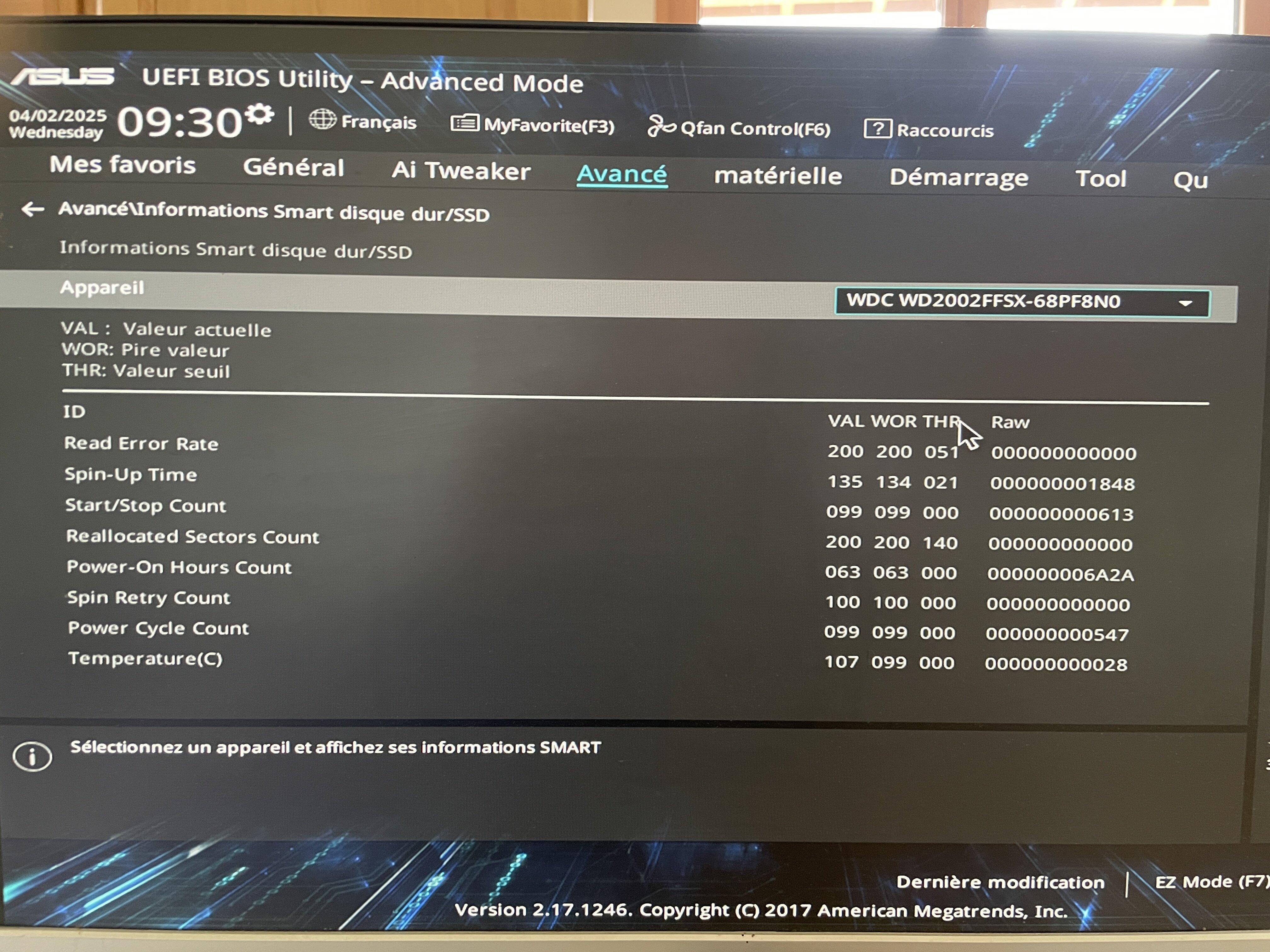

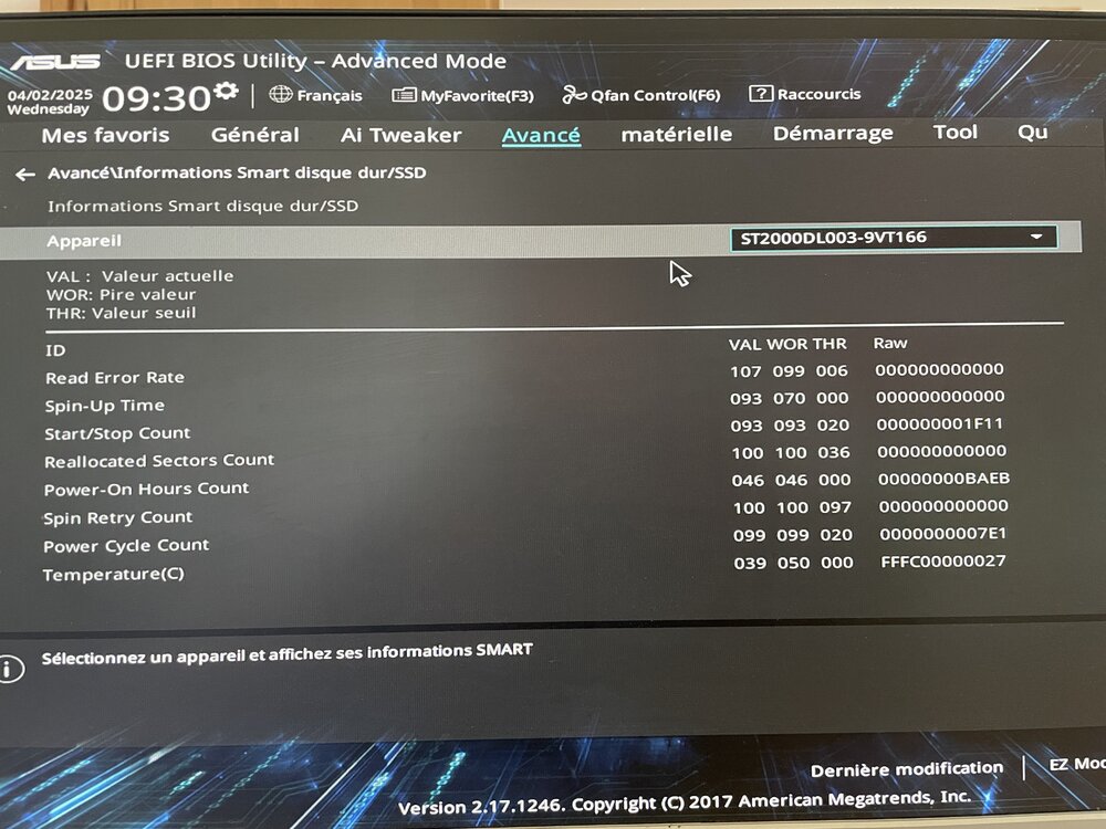

I have swap every single cable, and took pictures of the bios drive statuts:
According to the last diagnostics you posted Unraid is seeing disk1 and the SMART information for it looks fine.  If so then you can check that the data in the emulated disk1 looks correct, and if so clear the disabled status by Rebuilding the disk onto itself.   If you have a spare disk then you can rebuild onto that drive instead keeping the original disk1 intact in case the rebuild fails for some reason as that gives additional recovery options.
