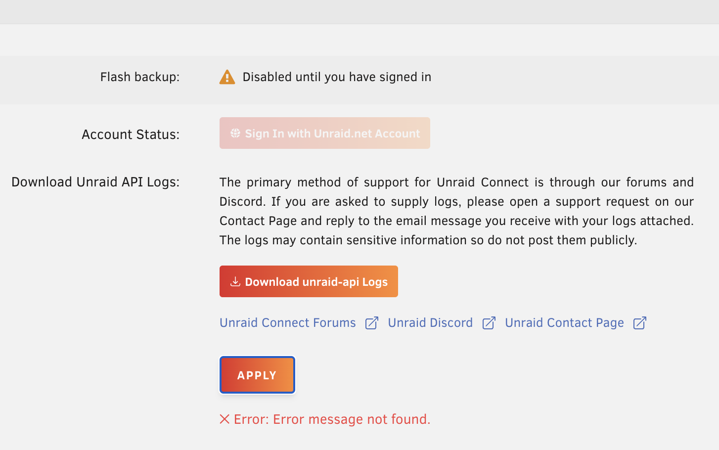

Ditto for me. Tried redownloading, no success. Rebooted and the plugin seemed to be working, but unconfigured. in the process of configuring it, specifically at inserting my user UUID from the online account settings page, it returned to the same "API is offline" error that started my down this path. Also, interestingly, in the settings, it says I am not signed in, but won't let me actually sign in either. It also throws a weird "Error: error message not found" error on that page when I tried to apply the UUID (also does it now whenever I hit apply.
After the second error, I also deleted any browser cookies and re-logged in, hoping it was a retained login issue. No help.

Uninstalled, made sure the config was blank and default, reinstalled and sign-in is still grayed out with unraid-api is offline error.   Worked fine until the last update for me.

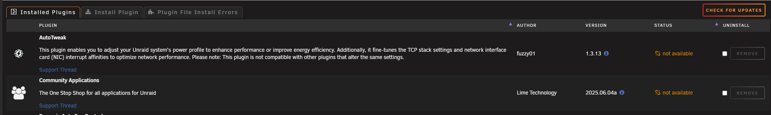

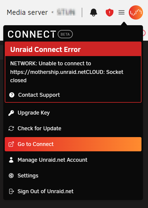

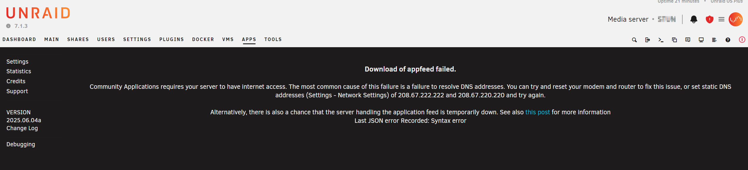

Hello, I have this issue since I updated from 7.1.2 to 7.1.3 this morning.
Plugin's page status not available:
Apps page not available:
Download of appfeed failed.
Community Applications requires your server to have internet access. The most common cause of this failure is a failure to resolve DNS addresses. You can try and reset your modem and router to fix this issue, or set static DNS addresses (Settings - Network Settings) of 208.67.222.222 and 208.67.220.220 and try again.
Alternatively, there is also a chance that the server handling the application feed is temporarily down. See also this post for more information
Last JSON error Recorded: Syntax error
What it does not fix:
- Reboot
- Reinstalling the Connect plugin
- Sign out and sign in again your machine to https://connect.myunraid.net/
Apps and Plugins page working again as soon as machine is signed out from connect.myunraid.net
Any ideas?
