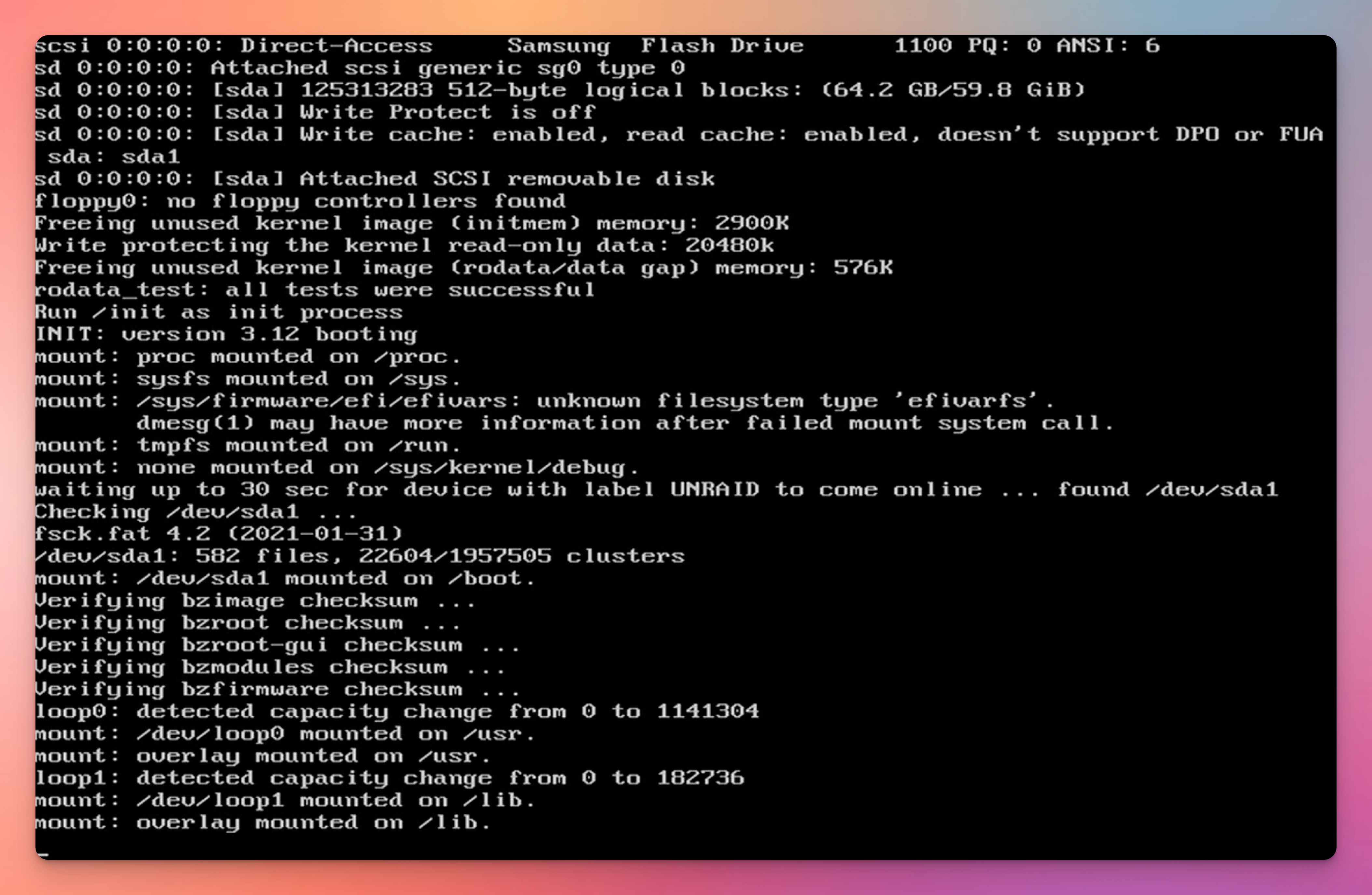

When I attempted next start up i first saw the below screenshot.

Any Ideas on how to bring the server back form the dead?

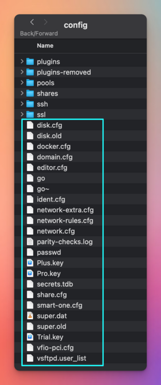

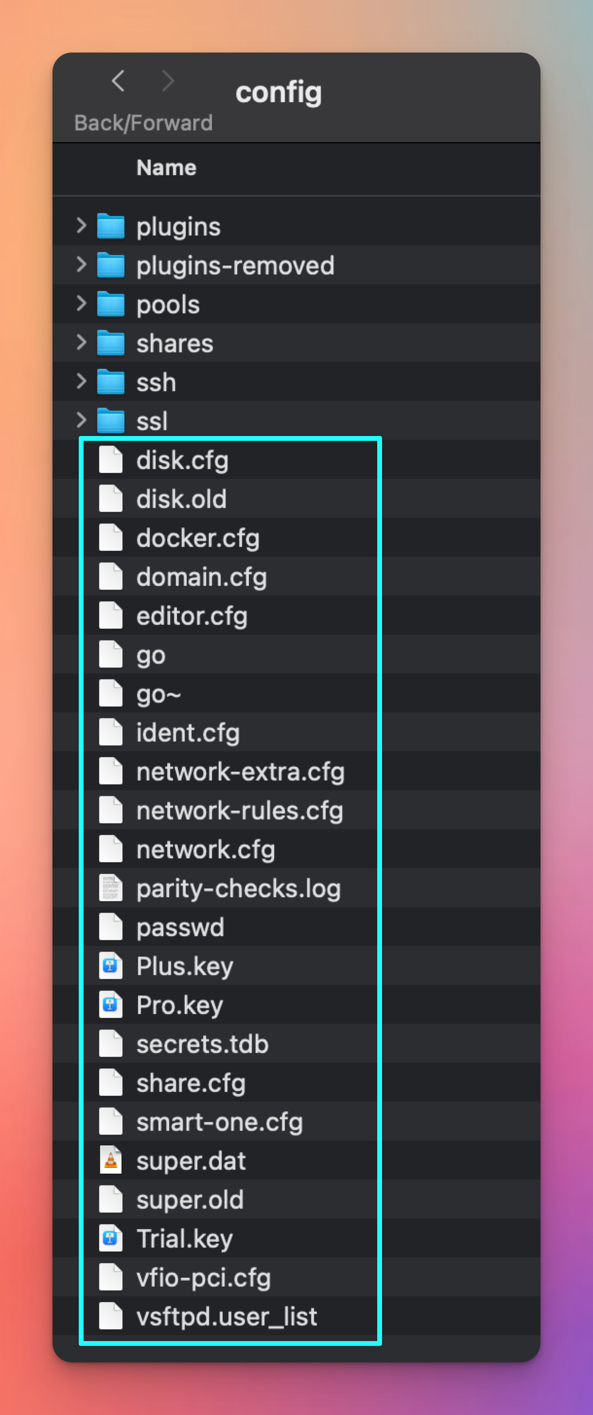

I have been busy trying different permutations of adding my config files back to a stock image part by part.
  1. All the folders (plugins, pools, shares, ssh, ssl) I tired removing and them one-by-one had no effect.
  2. The issue must be in these folders (in blue box), as swapping them out for stock files gets me to the boot screen successfully.
3. I have also tried to swap the disk.cfd and super.dat for their old counterparts. This did not work at all, and i got stuck at the same spot.
Does anyone have any other ideas on what could be locking the system up?
Cheers.
None of the .old files are used. You have multiple .key files, you only need Pro
You should use the stock go file.
I can imagine vfio-pci.cfg causing problems, you might consider removing it completely for now.
Well done @trurl that worked.
Unfortunately, I am not sure which one of your ideas worked!
But I did the following, and now it is back up and running:
  1. removed the .old files
  2. removed the other licence files
  3. removed the vfio-pci.cfg
Only step 3 should have had any effect.
