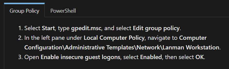

since a few month windows changed access to insecure smb shares, needs some mods in group policy (win 11 pro as sample)
Enable insecure guest logons in...
No image preview
Enable insecure guest logons in SMB2 and SMB3 for Windows...
This article describes how to enable guest logons policy in SMB2 and SMB3 for Windows client and Windows Server devices using Group Policy and PowerShell.

just to make sure its not related to this ... public Share access
