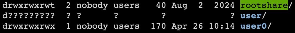

April 29, 20251 yr Author I hate to reply to my own post, but digging around I, I get this : as the output to ls -lah /mnt. I assume that this is where the User shares have gone. Can I just: to repair that part, of the issue? Sorry for the noob questions, I am just not very Linux technically inclined.
April 29, 20251 yr Community Expert Solution A reboot should fix the shares issue. Regarding parity, it dropped offline, check/replace cables and post new diags.
