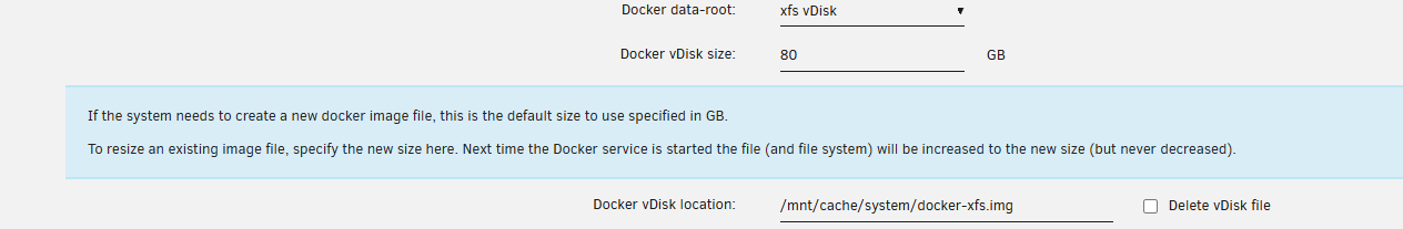

the issues isn't the docker continers space the isues is the docker image voume of space and how much room is avilabe on disk to read and write in the space..
stop all dockers.
turn docker off
with it off increase the docker image file size...
the path on the disk needs to be able to handle the vdisk size.
Even with 80 GB assigned with the number of docker I run. Running a local AI I don't have the space nor the ability to docker update local AI
as the local AI base image and docker model downloads a good 10 GB... you hit your vdisk space limitation and need to increase the vdisk size to update.

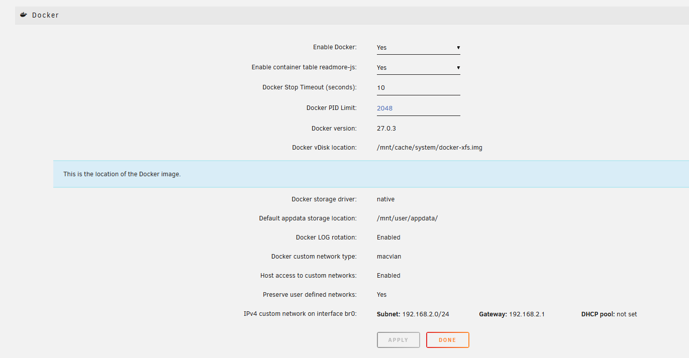

Hi
Sorry I might be asking a silly question, how do I stop the docker service?
I don't see any 'Apply' button here.. is there?

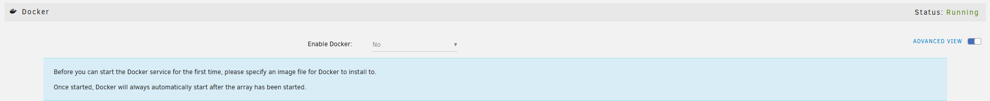

you have to turn enable docker form yes to no first then you will see the other docker options as the docker service need to be off... as seen above in the pictures...

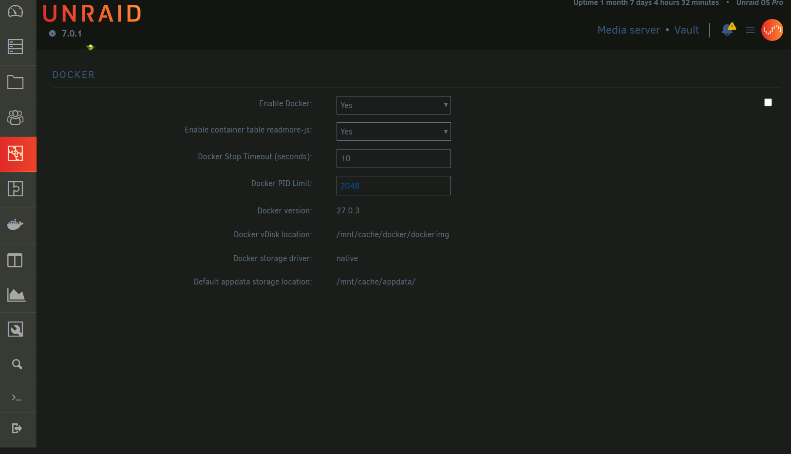

you also using a theme, not the standard unriad webui...
I don't remember I changed a theme, but I now played with all 4 (Azure, White, Black, Gray), I set the dropdown to 'No' but nothing happens, no Apply button,
there is also some checkbox on far right, without any label on it. It does nothing as well.
Use the White or Black theme, and clear your browser cache. Also, make sure adblockers or anything else are not interfering with the webUI.

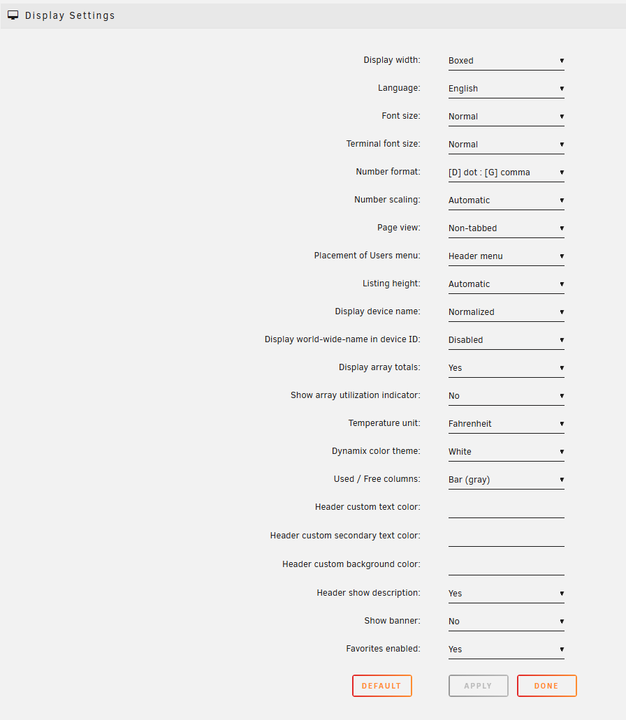

cant help you getrid of the weird theme and try again its your them causing issues using the web ui..
settings > display settings
But again I don't know waht theme your using nor how you would submit or apply the setting on page... You may need to start over if you bricked and broke your emhttp web interface by using a theme...
