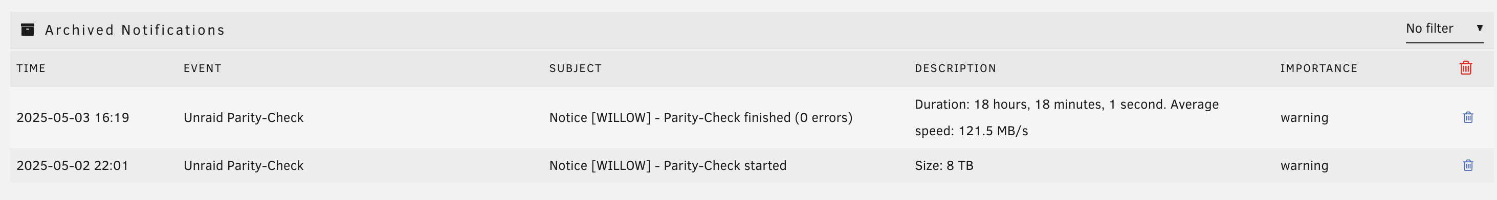

I run monthly (non-correcting) parity checks. My monthly ran last week, and the push notification to my phone reported it as finding 0 errors.

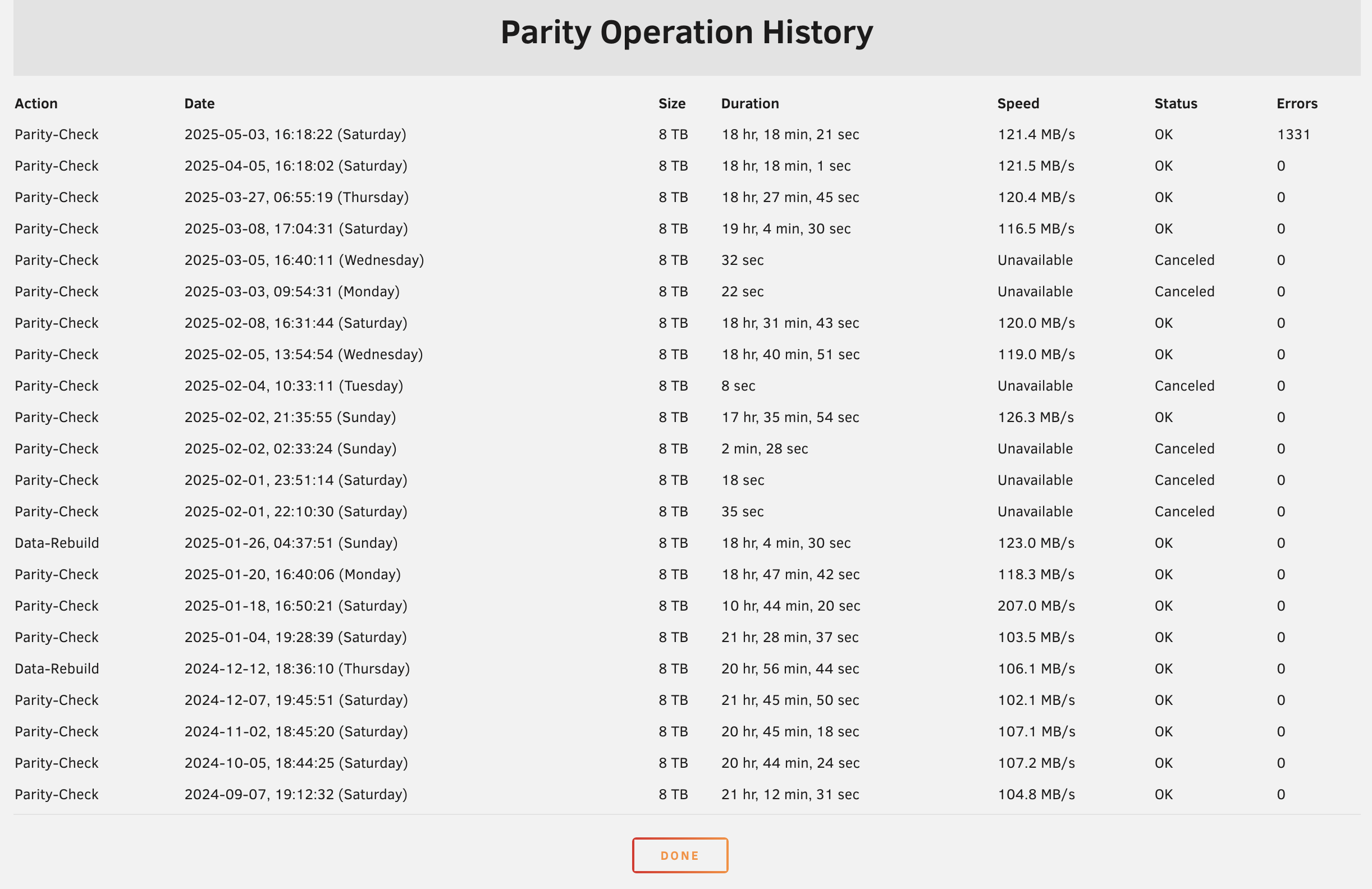

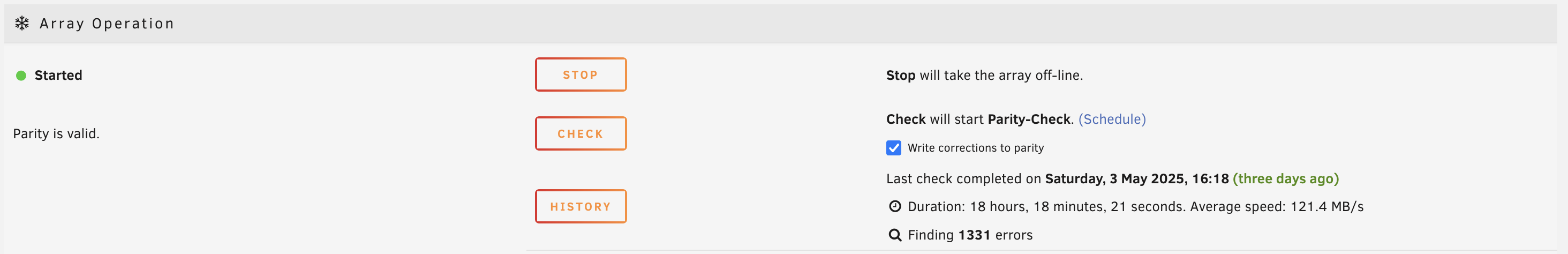

However, I logged into the GUI today to see the dashboard reporting that there were actually 1331 errors found.
This is the first time that I've received any parity errors.

a) to highlight a discrepancy in the notofication for a completed parity check; and

Attached are my diagnostics, but also screenshots showing the different parity notifications.

Trust this:
Notifications have been off for some time, but should be fixed in 7.1
Good to know, thanks.

Beware that to an yet unfixed bug, the notification mail/msg shows the results of the semi last run.
They say, they have fixed it in 7.1
We will see...

1 hour ago, jademonkee said:
run a manual parity check with "write corrections" enabled
And then it might be a good idea to run another noncorrecting check to verify that no parity errors remain. If it still has parity errors after correcting them then you still have a problem.
Make sure you get diagnostics or at least syslog for each of the parity check so they can be compared.
Correcting parity check completed with 1324 errors (so it keeps decreasing).
I'm now running a non-correcting parity check to see if any more appear.
