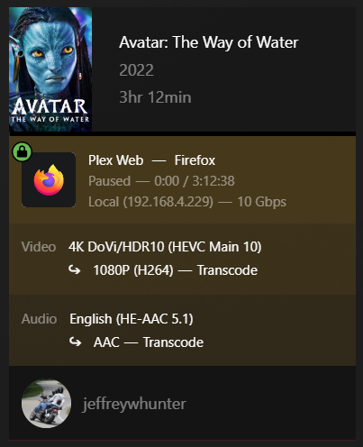

Yes I have a plex-pass.  I am seeing transcoding, but not the same.  I see:
Transcode, not Transcode (hw).  I am using the PlexInc Plex docker.  When I try Running nvidia-smi inside the container fails with:

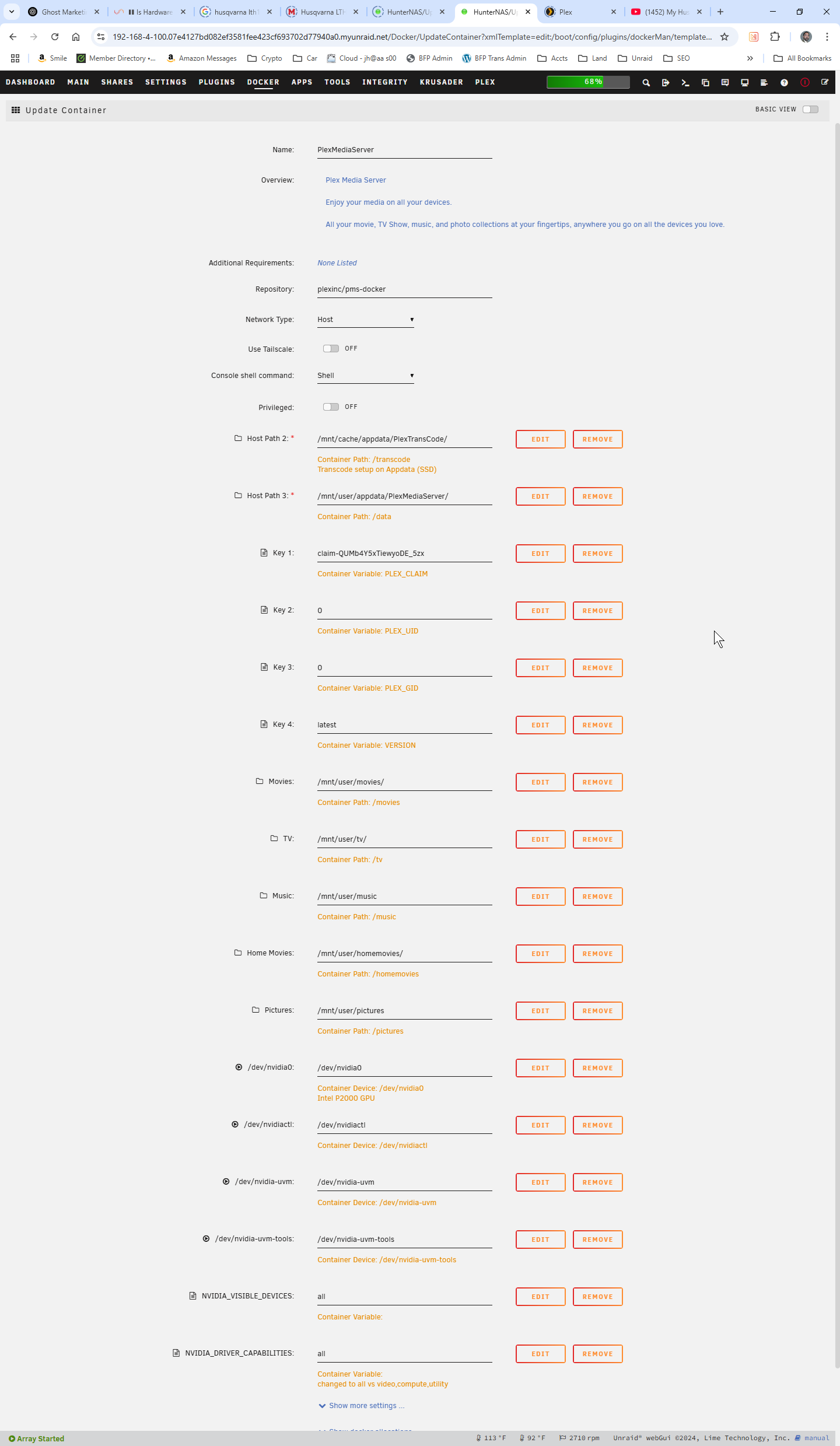

I don't see a variable for NVIDIA_VISIBLE_DEVICES = all nor NVIDIA_DRIVER_CAPABILITIES = all, I know you said you added them but they're not showing up here.
Edited by MowMdown
Both are there.  Here's the complete Docker config (and screenshot attached).
These are all the volume mappings, environment variables, and GPU passthrough settings.

Despite all settings appearing correct, GPU hardware transcoding did not function with this configuration, and Plex only showed "Auto" in the Hardware Transcoding Device dropdown. The container lacked NVIDIA runtime libraries internally (nvidia-smi not found).
Edited by jeffreywhunter
You named the variables correctly but I don't think you actually created the variables, click edit and post the screenshot of the edit page for the two
See how the orange text is blank next to "Container Variable"
Should look like this (repeat this for the driver capabilities variable as well):
I think you missed the "key" portion the name portion is irrelevant (the name is just so you can identify it in the template)
It would have shown up in this list:
Like so
Thanks MowMdown! Not sure how I missed that, but not setting up the KEY in addition to the VALUE was a big part of the problem. Additionally, (and this was a real challenge to figure out) there were a lot of permission issues at play.  I ran Newperms on /mnt/cache/appdata/PlexMediaServer, /mnt/user/movies, /mnt/user/tv.  The final bit, and this was important was making sure that I used the cache drive

🐳 3. Docker Container Setup (Plexinc)
These are the critical Docker Container settings:
Docker Container Setup Checklist – Plex with NVIDIA GPU (P2000)
📦 Container Basics
Repository: plexinc/pms-docker
Registry URL: https://hub.docker.com/r/plexinc/pms-docker
Icon URL: https://raw.githubusercontent.com/plexinc/pms-docker/master/img/plex-server.png
Network Type: Host
Privileged: Off
Use Tailscale: Off
Console Shell: Shell
CPU Pinning: (Optional — as needed)
🧠 GPU Hardware Transcoding
Extra Parameters:--runtime=nvidia
Devices: (Make sure both name and value are filled in)
	/dev/nvidia0
	/dev/nvidiactl
	/dev/nvidia-uvm
	/dev/nvidia-uvm-tools
Environment Variables: (Make sure name, key, value and default value are filled in)
NVIDIA_VISIBLE_DEVICES: key:NVIDIA_VISIBLE_DEVICES, value=all, default value=all
NVIDIA_DRIVER_CAPABILITIES= key:NVIDIA_DRIVER_CAPABILITIES, value=all, default value=all
📂 Volume Mappings
Container Path		Host Path							Purpose
/transcode		/mnt/cache/appdata/PlexTransCode/		Fast SSD-based transcode folder
/config			/mnt/cache/appdata/PlexMediaServer/		Plex configuration & metadata storage
/movies			/mnt/user/movies/				Movie library
/tv			/mnt/user/tv/					TV Shows library
/music			/mnt/user/music/				Music library
/homemovies		/mnt/user/homemovies/				Personal/home movies
/pictures		/mnt/user/pictures/				Photo library
🔑 Environment Variables
Key			Value					Description
PLEX_CLAIM	claim-XXXXY5xTiXXXXDE_XXX (example)		Optional claim token for linking server
PLEX_UID		0					Run as root (Unraid default)
PLEX_GID		0					Group ID (Unraid default)
VERSION			latest					Container image tag
🔥 NOTE: Using /mnt/cache/... instead of /mnt/user/... fixed several weird bugs with hardware transcoding. Plex can behave unpredictably with FUSE paths.

🧪 6. Confirming GPU Usage
In terminal: watch -n 1 nvidia-smi
Look for: Plex Transcoder using 500–700MiB GPU Memory GPU-Util: >30%
In Plex>Activity>dashboard: Playback shows: Transcode (Video: H264 (Hardware)) - (See MowMdown's first post above)
💡 Bonus Observations
Firefox sessions triggered hardware transcode reliably on 4k videos - useful since you can't control from the Plex Player anymore.
Chrome sometimes fell back to CPU transcode due to codec or subtitle rendering - THIS IS STILL AN ISSUE - in Chrome, Plex does CPU transcoding...*sigh* I have to work on that next.
Plex ran thumbnails and streams simultaneously without skipping or pegging CPU.
HELPFUL: Using watch -n 1 "top -b -n1 | head -n 15; echo; nvidia-smi" let me watch real-time both GPU and Processes at the same time.
HELPFUL: I used ChatGPT for a lot of the debugging.  You can't believe everything, but it was fantastic at providing options and specific commands to use (like Watch). I'm not a Linux GURU so this aspect of AI was VERY helpful.

I have had success triggering transcoding using Firefox as the browser (it does not support H.264 files I assume). And its working well.  I've not found a way to trigger transcoding otherwise.
