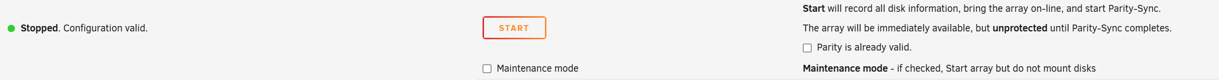

Alright, unmounted, created the new config, and swapped the two drives.  Now, I should start in maintenance mode and check parity?  How do I go about that without overwriting what's currently on the parity disks?  I know it warns about overwriting the parity drives when the array is started.

New Config resets super.dat (your array assignments) so that is OK.
Better if you start in normal mode instead of maintenance mode. We can't tell anything about your filesystems in maintenance mode.
So, check, "parity is already valid" and then start?
Looks good!
