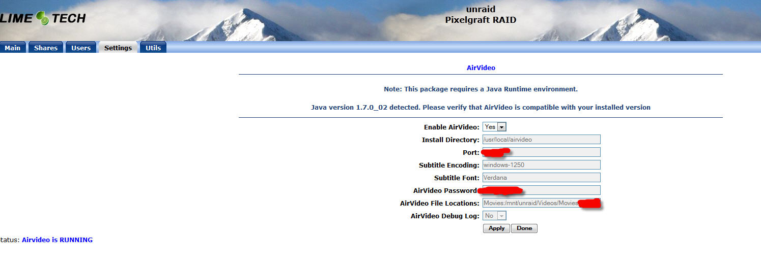

Thank you VERY MUCH for all of the details. I do see "Air Video" when I hit my unraid box (http://unraid:45631/), so it seems the daemon is going fine and listening.
I also just tried adding a new server in my ipad using the local IP of my unraid box (192.168.1.11), also typing in that port and I still get the error on my ipad "Communication Error" request timed out
What happens if you click the blue "Airvideo is Running" - which is also a hyperlink.  You should get a new web page up that just says "Air Video" on the screen.  Same thing should happen if you go to http://yourhostname:45631.
If it does, then it shows that the AirVideo daemon is running and listening and it's likely to be something else.
Try taking dyndns.org out of the equation.  Test this at first on the same lan as your UnRAID and not over the Internet or anything which is using NAT translation in your router.
Create a new server in the AirVideo ipad app and give it the ip address and port for your UnRAID server.  See if that works.  If it does, then you'll know it's something to do with the dyndns.org address.
One of the other things you can do in the AirVideo plugin is enable debug log.  Stop the service, enable debug log, start the service.  The part where it says "AirVideo is Running" will also have "(Debug Log)" next to it.  If you click it, it brings up a live output of what AirVideo daemon is doing.  Keep that running whilst connecting from your ipad.  If your client app is talking to the AirVideo process on UnRAID, then it will show up on the logs, perhaps that'll help point where the source of the problem could be.
For the record, I'm running the same Java JRE, so it's not that.
Regards,
overbyrn

Responding to myself here, but is it the path listed in the Install Directory: /usr/local/airvideo
and...do I need to edit that to something else?
And..responding to myself yet again...
I was able to get into the server on my ipad, by way of both the IP address and the dyndns.org setup I have. I'm not sure why, but my asus tower lists my unraid box as ip .11 on my network, but when I do a cmd > ping -a on the box, I get an ip of .13, so I changed tat around in the settings and in my port forwarding and all is well. I now get my password prompt when I go into the airvideo ipad app, as well as see a "movies" folder, but I see no movies. Probably how I typed my syntax in the airvideo web gui settings, so I'm trying to figure that out now...
Getting very close now, but still have issues.
here's where I'm at:
I have a total of 6 drives in my unraid box, the name off my main user share being "unraid". It seems for the moment, all of my movies reside on disk 3...
When logging into the ipad (either direct unraid IP, or dyndns.org), I enter my chosen password and...
I see my folders and my movies, and they play just fine when I have this within AirVideo File Locations:
Movies:/mnt/disk3/unraid/Videos/Movies
I see my folders, but DO NOT SEE MY MOVIES when I have this within AirVideo File Locations:
Movies:/mnt/unraid/unraid/Videos/Movies
I would imagine as my collection grows, these movies will span multiple disks. I shouldn't have to type in each disk and each sub-folder, should I?

SOLVED!!!!
It was my syntax, so your explanation of disks vs shares.
Before (didn't work):
Movies:/mnt/unraid/Videos/Movies/
After (had to add the word 'user') and now works beautifully:
Movies:/mnt/user/unraid/Videos/Movies
THANK YOU, THANK YOU! Now I can get AirVideo off my local win7 box! The dyndns is also working perfectly.
