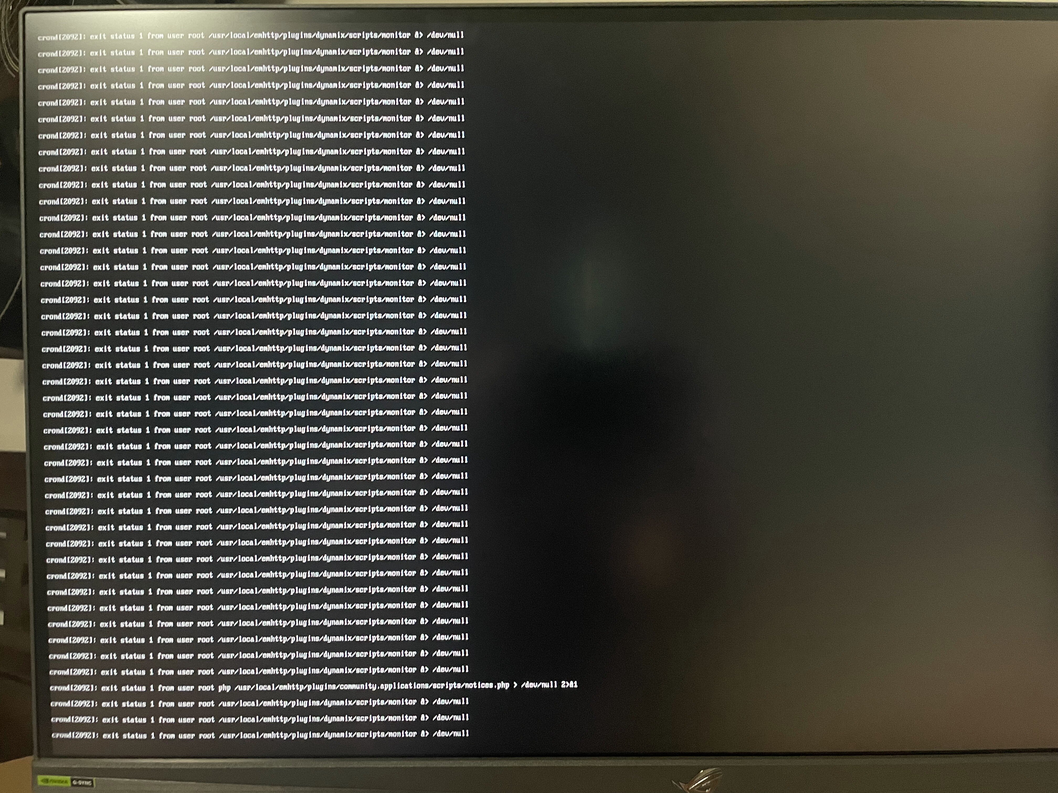

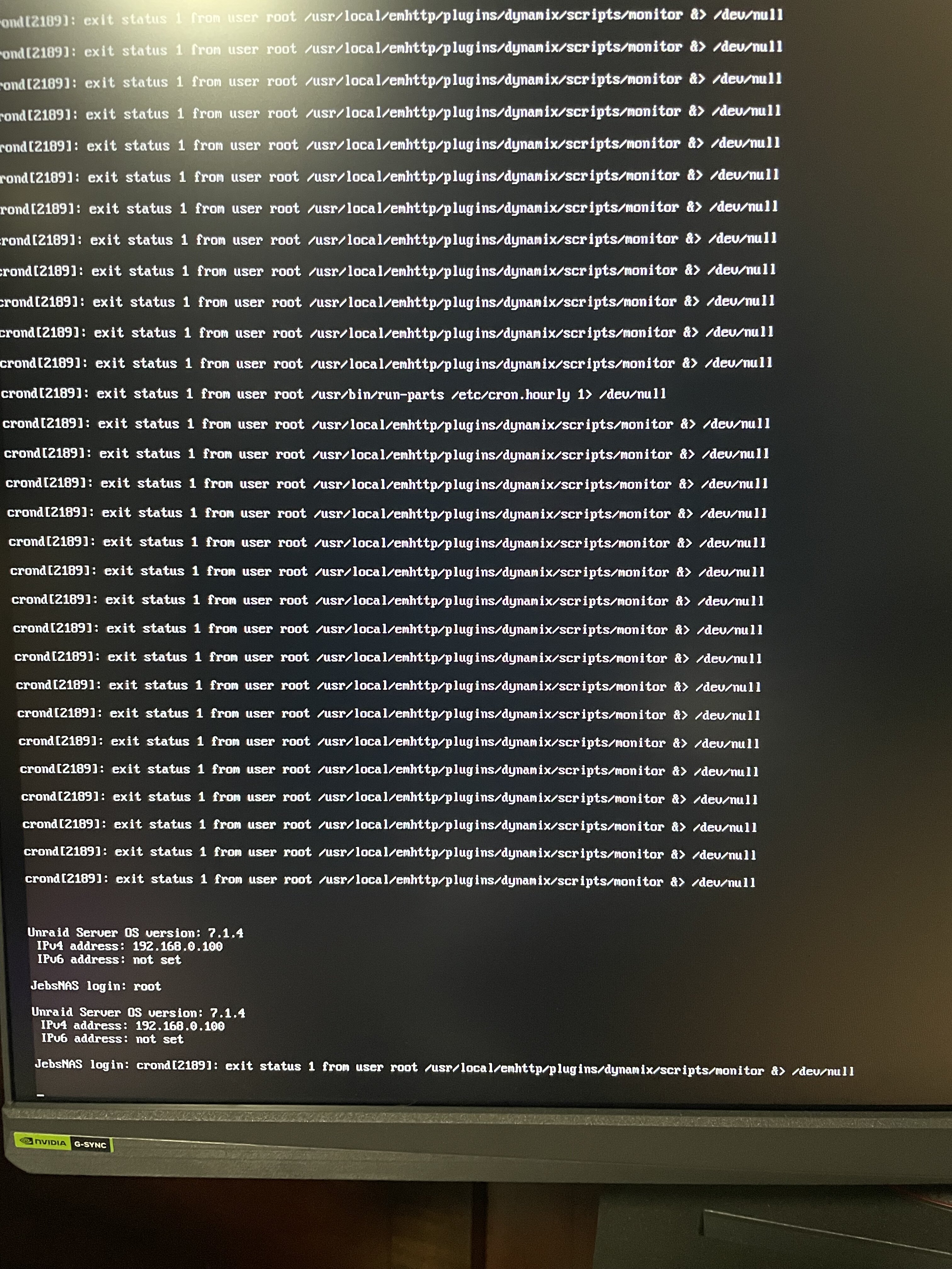

"crond[2096]: exit status 135 from user root /usr/local/emhttp/plugins/dynamix/scritps/monitor &> /dev/null" that is repeated about every 30seconds-1minute

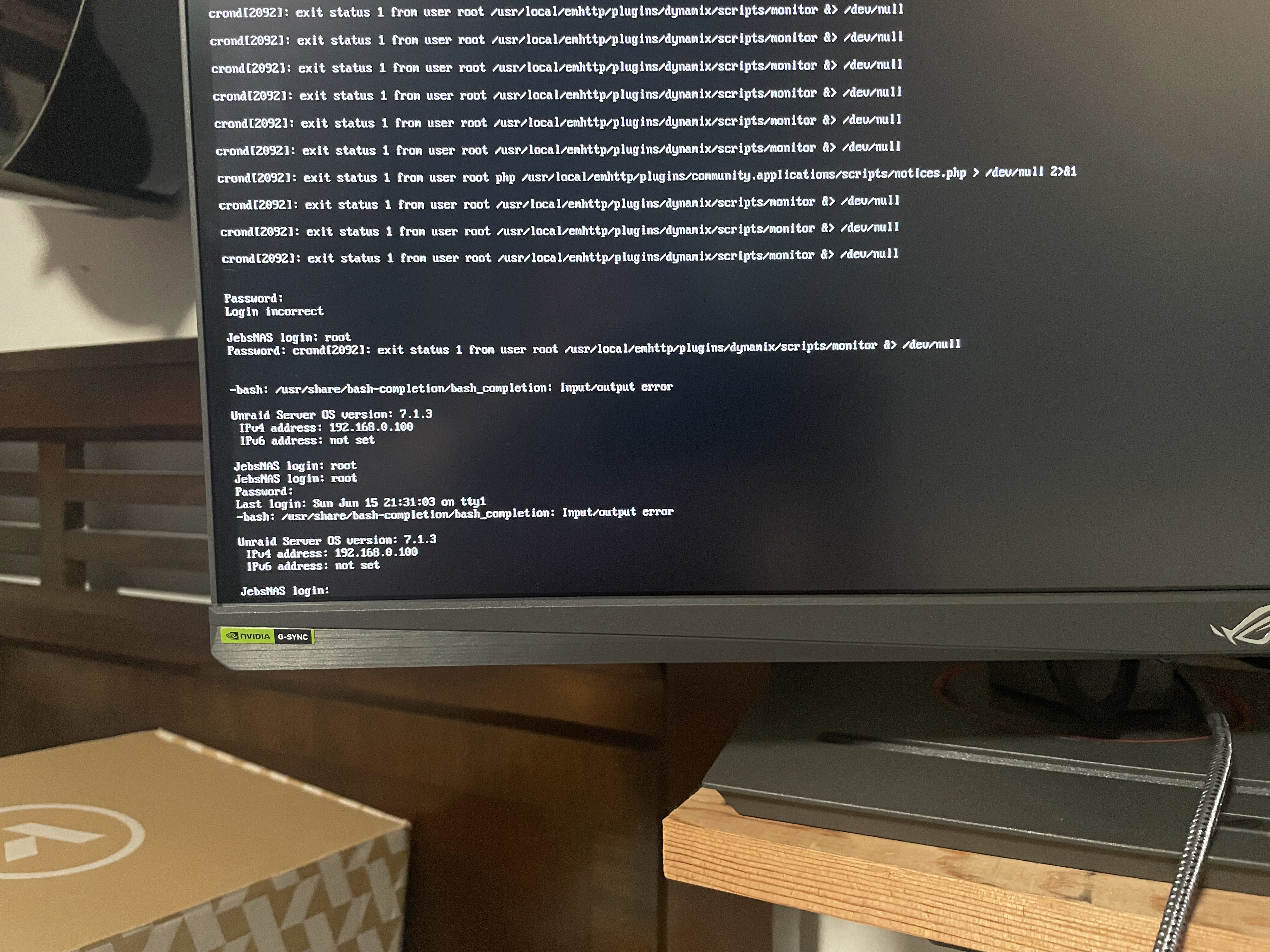

Attempts to type in my username and password on terminal to sign into the machine without the network and GUI would just display:
"-bash: /usr/share/bash-completion/bash_completion: Input/output error
Unraid server OS version 7.1.3
IPv4 address: MyServerIP
IPv6 address: not set"
After displaying this message it would bring me back to the login prompt.

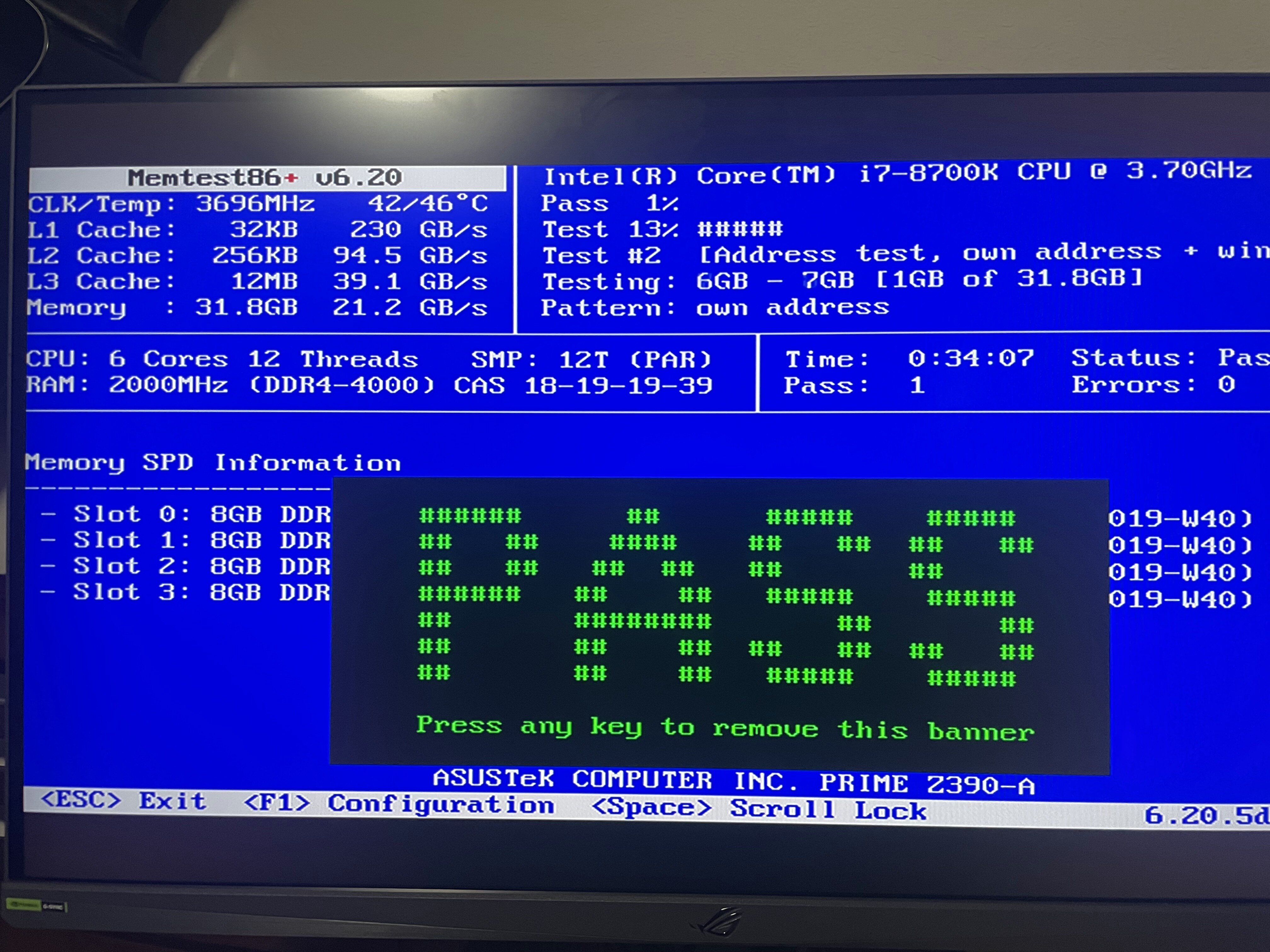

I forgot to mention in my original post, but I did do a smart test on all the drives last week when this issue first started becoming a common occurrence, and also a memtest. Everything passed. This, along with the fact that I was able to complete a full parity check last week after the issue began, makes me think it's not a bad drive issue. If you see anything else that makes you believe a bad drive is the culprit, please feel free to let me know and I will then try to identify the bad drive and replace it since I already have a new one. I'd need another way to diagnose/identify this though since the smart tests seem to have passed. I have 2 drives currently connected which are "unassigned". One of them is the new parity drive, and the other is a purple HDD that I use for a Windows VM running Blue Iris from this server.

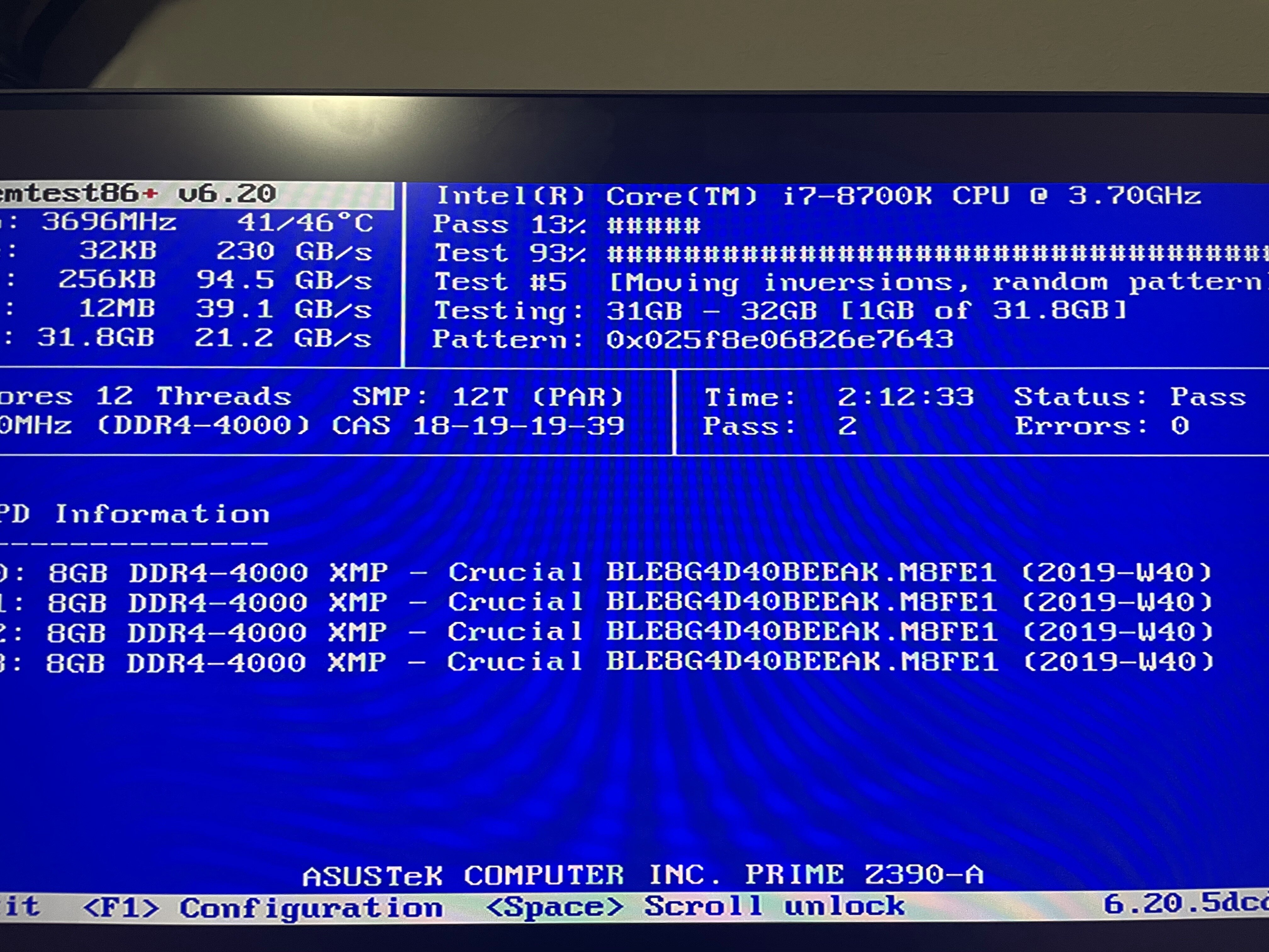

I do have a picture of my monitor showing the memtest. I let it run through 3 times. The second 2 times took a very long time to complete.

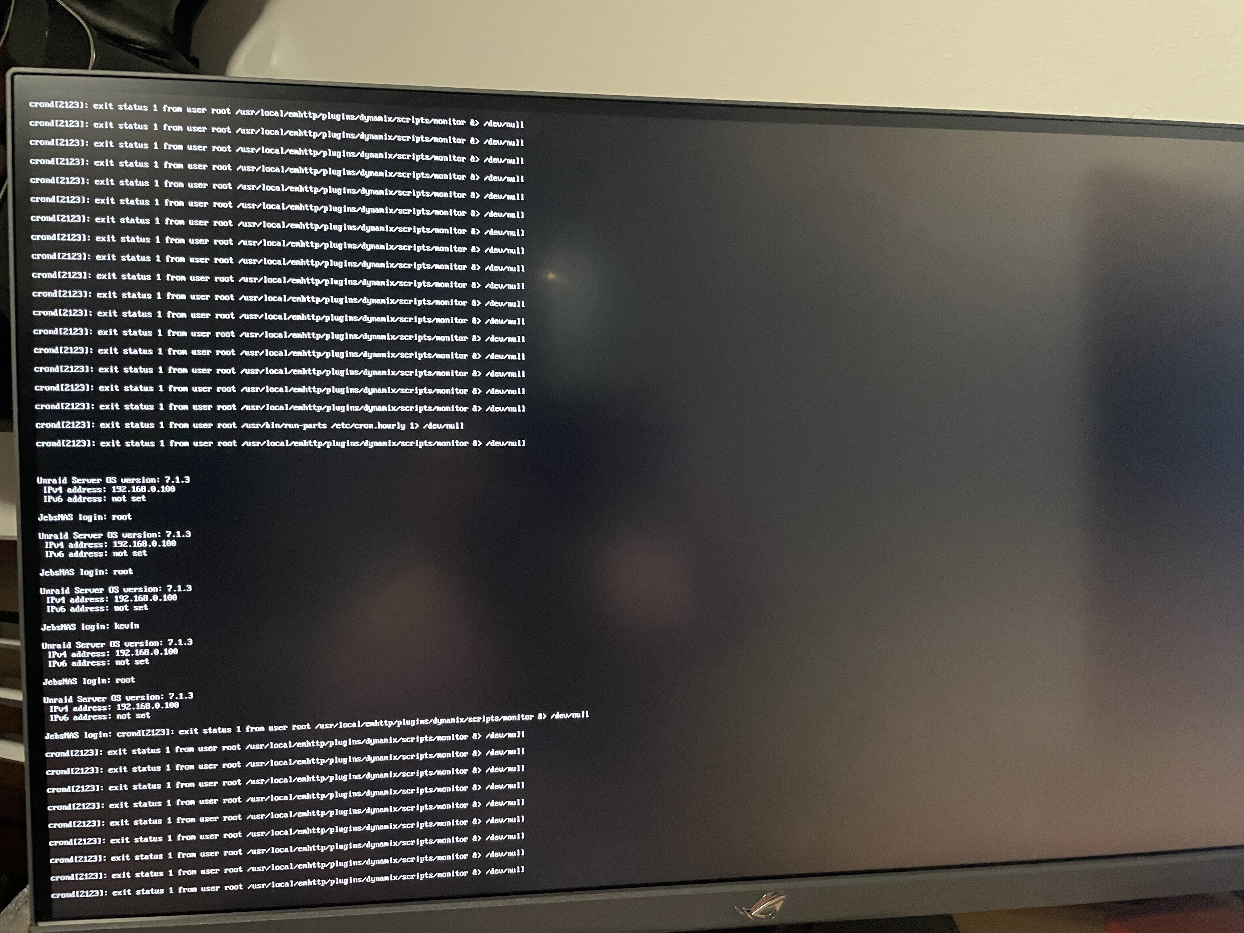

I also have pictures of the unraid terminal after attaching my monitor directly to the server. In the first you can see the "crond" error that keeps repeating. In the second you can see what happens when I try to login to the server when kvm is attached directly.

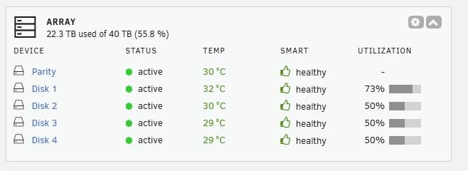

The final pictures I have attached here show all the drives currently part of the array and their smart passing, and also the 2 unassigned drives which have passed smart tests.

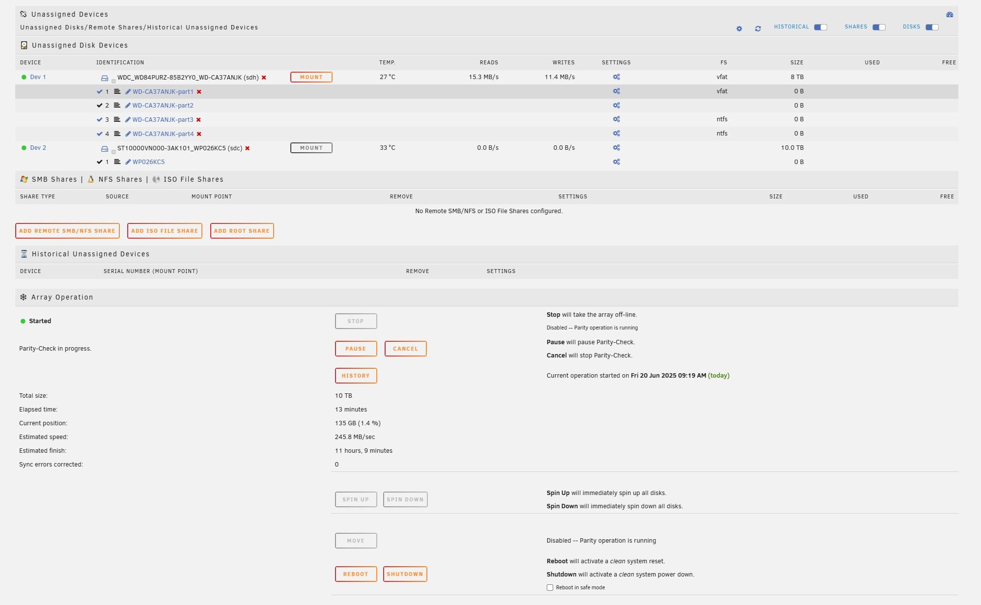

I believe by "scrub the pool and post the results from GUI" you are asking me to perform a parity check, and to then grab results of this parity check from the GUI and post them here. I believe that when Unraid performs and completes a parity check, it will say something like "completed with no errors" or something similar at the bottom of the "Main" tab where it gives information on the parity check, and this is what you want me to post? Please let me know if this is correct and I will attempt to post a picture or screen capture of this if I can get a parity check to complete. If this is not what you are looking for, please let me know exactly where in the GUI I should be able to find the information you are looking for.
I promise, I am not just lazy and trying to not perform a parity check. I am just trying to explain why it hasn't been possible or easy for me to do so with the server going down all the time.
The system started another parity check this morning when I had to restart the server again. In fact, I believe the parity check has been started on it's own almost every time my server has rebooted in the past couple of weeks because it's not being shut down gracefully. I will admit that many of the times the server was rebooted, I did stop the parity check because I didn't feel like it would do anything different than all of the other times it ran, but at least a few of the times it has rebooted (likely much more than a few) I let it continue to run the parity check until the server went down again.
Because I have all 10TB drives in my server, it takes a long time to perform the parity check. I had to reboot my server again this morning because of the error described above caused it to stop working again last night before the parity check finished. The parity check has currently started again, and I will let all future parity checks continue and attempt to gather the result if it finishes before the server goes down again.
In order to help in the meantime, I've also included a current screen capture of bottom of the main tab. As you can see from the picture attached, it currently says it will take ~11 hours to complete the parity check but my past experience tells me that it will likely take a bit longer. I believe the last times I saw it complete, it took closer to 13-16 hours. The issue I'm having with the parity checks in the past couple weeks, is they take so long to complete that many of the times it runs, my server stops working before the check completes. For instance, In the diagnostics I included below, you can see in the syslog-previous.txt log file that my server was rebooted yesterday at ~2:20 PM, and seemingly around 10:30 PM it went down again because that's where the log stops. I didn't reboot it again until this morning. I also want to note, that the parity-checks.log file does not include any line items from this instance (2:20PM - 10:30PM yesterday) when I rebooted the machine and let the check run. If I stop the parity check, it logs what it was able to do, but if it runs until the server goes down, nothing is logged about the parity check in the parity-checks.log file. This has been my experience so far, that the server can't complete the parity checks because they take longer to complete than the server stays online. The server also doesn't log when I do let the check run because it goes offline before the check finishes.
I have also attached a copy of my parity-checks.log file found in /boot/config. In this file I believe there are a couple instances the parity check was able to complete in the past week before the server stopped working or I stopped the check. I believe the log for June 16 at 09:50:40 and the log for June 13 at 00:10:12 are times when the check was able to complete. I believe the "check P" log indicates they passed? If this is true, I'm hoping that this can serve as an indication that the parity check did complete after I began seeing this issue, and we can continue diagnosis and troubleshooting to figure out what is causing my server to stop working and send the crond errors described above.
I want to re-iterate, please understand that I am not saying that I will not complete the parity check, I will still attempt to complete the parity check that is currently running after my reboot this morning, and I will try to capture the result before the server goes down again. I will also continue to let the parity checks run after all reboots from now on and see if I can capture one for you that completes. My last post was not an attempt to tell anyone that I refuse to do as you ask, it was only an attempt to explain the troubles I've been having and why I wasn't confident that it would be possible to complete the check and for me to capture the results in the GUI with the server going down all the time and the GUI being unresponsive. I also wanted to give as much other information that I believe might help in the meantime so that we cold continue troubleshooting while we waited for a successful parity check to complete, especially since I believe it may not be possible to get a successful parity check with the server going down all the time.
Thank you again for your time!
Please let me know if I am correct about the GUI results you're looking for, and if there is anything else we can do in the meantime while we wait for a parity check to complete that might rule out other possible issues.

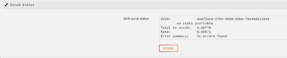

No, click on the first cache pool device, scroll down to the Scrub Status section and click the SCRUB button, then post a screenshot showing the results.

Totally my fault. I thought by the term "pool" we were talking about the group of array devices since that is usually what I think of when I think of Unraid. I should have known we were talking about the "cache" pool since that's the only thing in Unraid referred to as a pool. Thank you for clearing this up for me. I really hate the way my brain works sometimes.

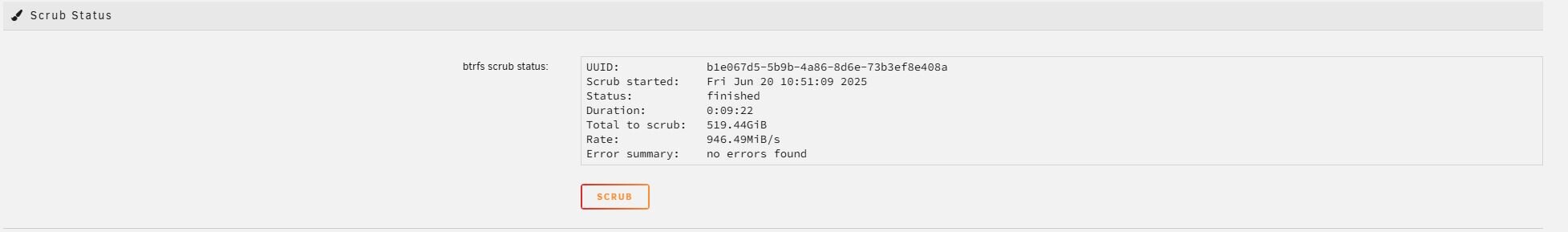

Below is my result from scrubbing the cache pool.
Thanks again for your help!

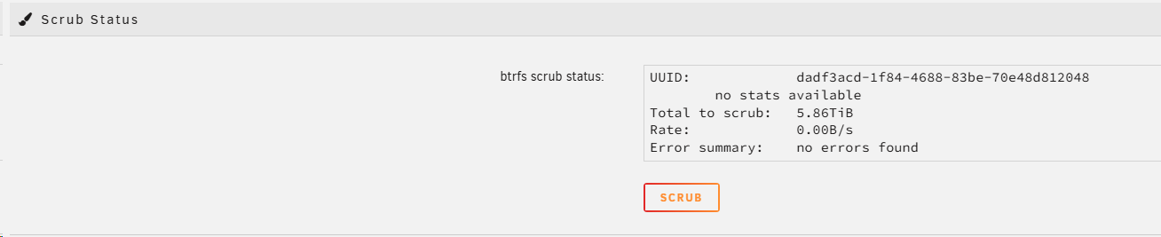

Since no errors were found, click the "reset" button on the stats section, above the scrub, then reboot and post new diags after array start.

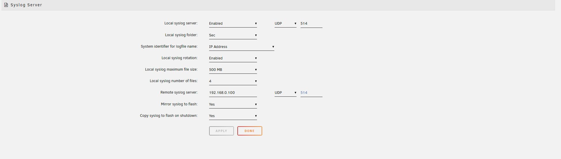

And finally as kind of a side note, I thought I already had the Syslog server settings enabled and setup correctly in my previous diags. I attached a photo here of my current settings, if this is incorrect, please let me know.
jebsnas-diagnostics-20250621-1254.zip
Looks OK, the persistent syslog should be in the "Sec" share, post that.

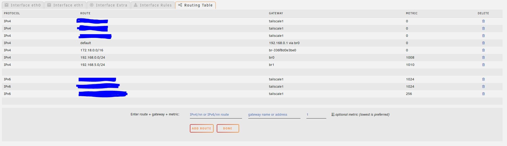

Something I did see on the Syslog server that seemed interesting, is that there are a lot of logs for:
JebsNAS kernel: br-336f8d0e3be0: port 1(veth6d2d15e) entered blocking state
JebsNAS kernel: br-336f8d0e3be0: port 1(veth6d2d15e) entered disabled state
This doesn't entirely make sense to me, and it doesn't really explain the issues I've been having. I believe this to be a completely unrelated issue to the original issue I've been having. I'll explain my logic below. Please let me know if (or more likely where) my logic is flawed. If there is a fix for this issue which I'm not seeing, please let me know as I'd still like to stop those errors. However, I'm not entirely convinced fixing these blocking/disabled networking errors will fix my original issue.
I do have a PCIe network card installed on my machine, and I have 2 ethernet cords attached to my server from my L3 switch/router. I have one cable attached to the motherboard and another attached to the network card. I see how these could originally cause STP errors, however, I set these up so the motherboard (and thus my Unraid server) is on my 192.168.0.0/24 network, and the PCIe NIC is attached to a 192.168.5.0/24 network. The network card connection I use to passthrough traffic to my Windows VM running Blue Iris.
I see how these could have had some issues with Spanning Tree Protocol when I first connected them, but now that they are on different networks, I don't believe this would be what's causing my issue.
Furthermore when I look at the Network Settings, I can see that the (blocking/disabled state) issue doesn't seem to be about the two cords, it seems to be with the internal loopback address. The logs mention br-336f8d0e3be0, which network settings says is related to the 172.18.0.0/16 route.

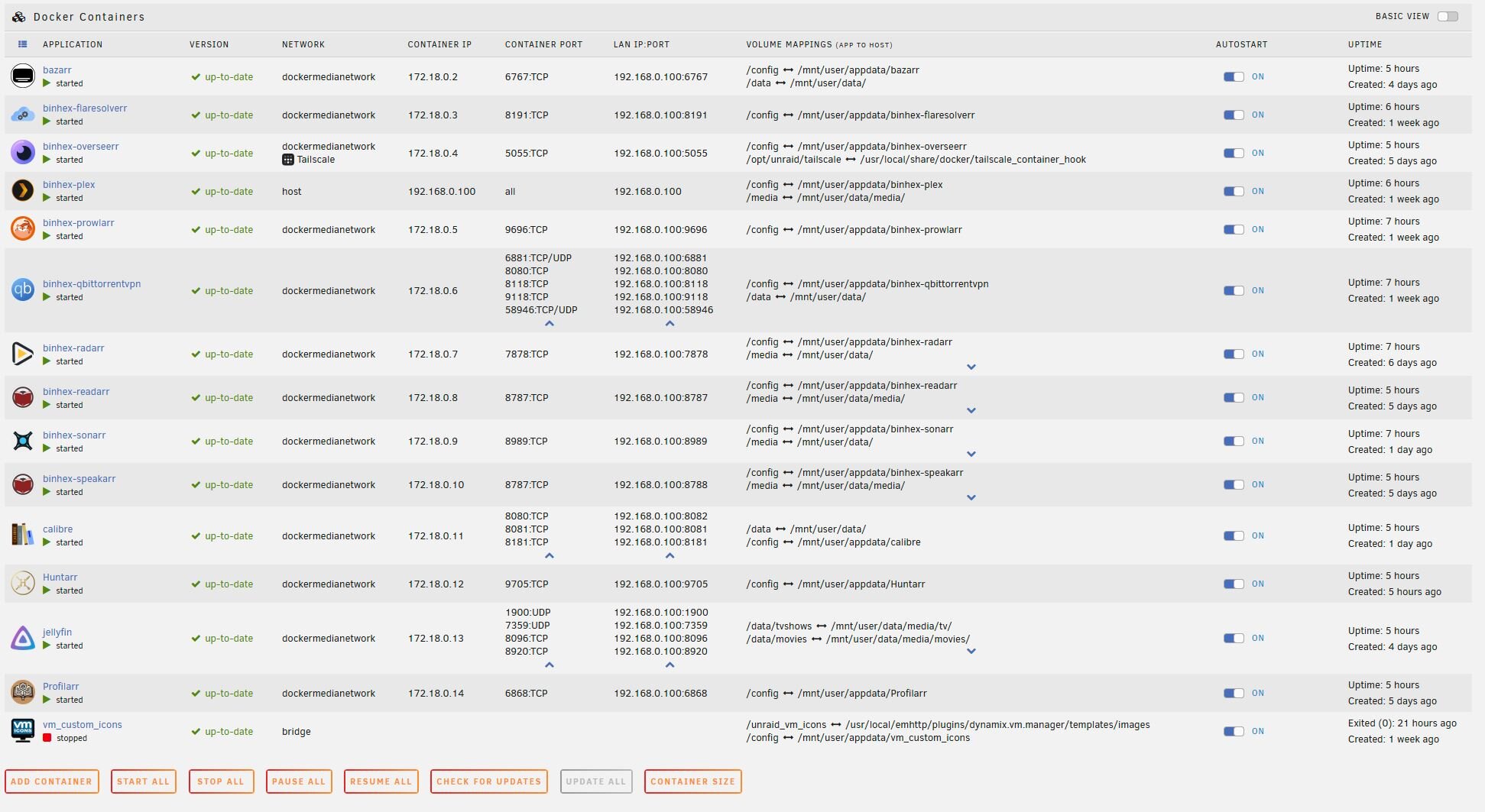

Knowing the loopback address was a possible issue, this made me think about my docker containers since they are all on a network I created for them and would constantly speak to each other. Most of the logs here seem to be related to the docker containers anyway. I've also posted a picture of my docker tab after expanding all of the container and IP port columns. In it you can see that the dockers all have separate port numbers and are on their own "dockermedianetwork" network so they can speak to each other. The only one that wasn't setup this way was the Plex docker. I left Plex with this original configuration when I added all the other docker apps a while back, but just in case, after posting this I will be changing Plex to also use the dockermedianetwork network too. I'll see if this causes any other issues with Plex access and/or with fixing the blocking/disabled state errors on my next reboot.
As mentioned above, I'm not convinced my original issue would be fixed by stopping whatever is causing the blocking/disabled state issue. This is because the error I was getting in my original post for this thread did not only affect the network, but the error also was affecting the server itself. When I plug in via KVM, I am not able to log in and also unable to perform shutdown or powerdown or any other commands since I can't log in. I don't see how a network issue could do this if I was bypassing the network with KVM?
Thanks again for looking. If you see anything else that might require my attention, please let me know!

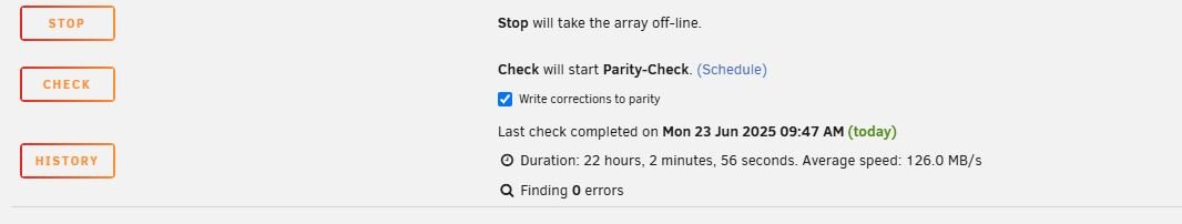

Just for the record, attached below is a pic of the parity check which finally completed. 0 errors and it took more than 22 hours!

I did have the crond error happen again today.
Attached below should be my Syslog, my diags, and a pic of the login screen showing that I am again unable to log into the server, even when physically attached via KVM.
Looks like the logs stopped last night around 5:09 PM after some sort of nginx alert that caused an "abort". This seems to point as to why I am unable to reach the web GUI, but it doesn't tell me why I am then unable to log into the server, even via a direct KVM connection. The nginx error wouldn't bother me so much if it didn't cause my whole server to go down.
Yesterday, the server had been up for a few days, so I felt confident starting to build the parity for a second parity disk. (disk WP026KC5) I figured that since the server was seemingly running fine again, and was able to complete it's own parity check, that this would be possible.
I noticed that I was having the original "crond" error again this morning, and although I was unable to access the server to see shares or to login via Putty or KVM, I could see that the physical lights I have on my server that blink to show when disks were being accessed were blinking. I also noticed that I was able to access media via my plex server which runs on a docker container. I figured I'd let the computer keep running until I didn't see the lights blinking anymore, which would hopefully signify that the parity for the new drive was finally complete.
The lights stopped blinking today a little after noon. I waited even longer and rebooted the server around 1:15 PM but unfortunately, the parity didn't take so I put the new disk back into unassigned devices.

Unfortunately, there's nothing relevant logged, this can also be a hardware issue, one thing you can try is to boot the server in safe mode with all docker containers/VMs disabled, let it run as a basic NAS for a few days, if it still crashes it's likely a hardware problem, if it doesn't start turning on the other services one by one, including the individual docker containers.
Another thing that may be wroth doing, and since you have multiple RAM sticks, try using the server with just one pair, if the same try with the other one, that will basically rule out bad RAM.

Attached are the latest diags, syslogs, and a pic of what I'm seeing when connected directly to the Unraid server. Trying to log in does nothing but cause the login message to repeat and ask for credentials again. The Crond error is the same one I've been seeing since I first started posting here. Any help or guidance would be appreciated. To recap, I've replaced RAM, I've replaced the HBA, I've done smart tests, I've done mem tests, I've taken out the GPU and then put it back in, I've completely restored my NAS back to a fresh install of Unraid.
Please let me know if you are able to find anything that might give a clue as to what is causing this. I'm in way over my head here.
