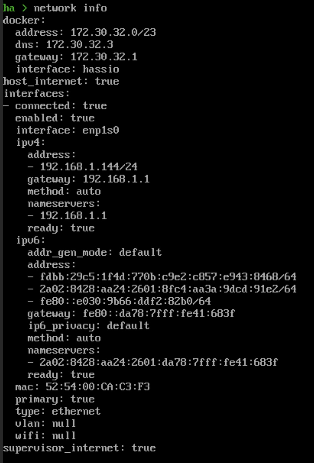

The Home Assistant VM does have IPv6 connectivity. Output of ha network info in the CLI:

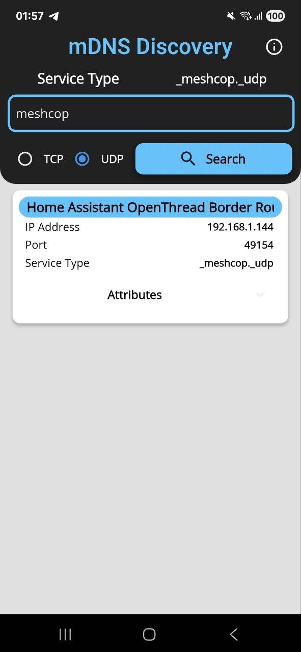

You may be having mdsn avahi issues..
Go back and check / review:
1. Border Router Discovery (mDNS + SRP)
For Matter-over-Thread commissioning, your phone must discover the Border Router via mDNS over IPv6.
  • Check if your phone can see the OTBR mDNS record:
    • Use an Android mDNS browser (like “Discovery” or “Bonjour Browser”) and look for _meshcop._udp or _matter._udp services.
    • Alternatively, log into your Unraid NAS and run:
      • avahi-browse -a -r
    • You should see entries related to OTBR and Matter services.
  • Ensure Avahi (or mDNSResponder) is running on the VM, and it bridges the .local domain across the interfaces.

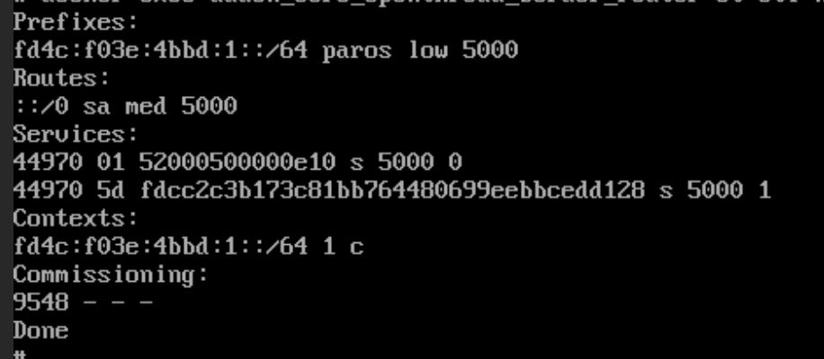

OpenThread CLI Debug
If you SSH into Home Assistant or access the OTBR container/VM, try:
ot-ctl state
ot-ctl router table
ot-ctl netdata show
You want to confirm that:
  • The node is “leader” or “router”
  • The network data shows correct prefixes
  • The router table includes other nodes when a Thread device is partially joined
As alot is guessing as there are mutiple points of failure...
Final Thoughts
The most common root causes in your scenario:
  • OTBR not advertising its route properly
  • mDNS or SRP not discoverable from Android
  • IPv6 routing/NAT/NPT problems blocking ULA communication
    • Could be at router level...
Once you verify that the Android phone sees the OTBR via mDNS and can reach the fdxx:: prefix, the Matter commissioning should go through.
some other HA debug comands:
Home asist has docker and may have soemthign with in the VM causing isseus too

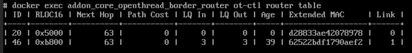

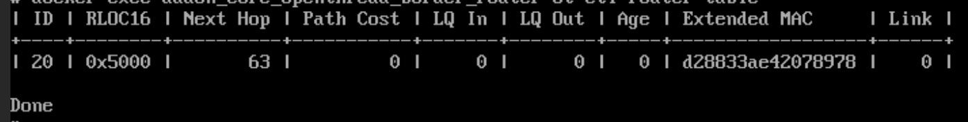

docker exec -it addon_core_otbr bash
ot-ctl state
ot-ctl netdata show
ot-ctl prefix
Please paste the output from each command. Here's what we’re looking for:
  • state should return leader, router, or child
  • netdata show should include a fd.../64 mesh-local prefix and the "s" (stable) and "r" (preferred route) flags
  • prefix should list that same fd.../64 prefix

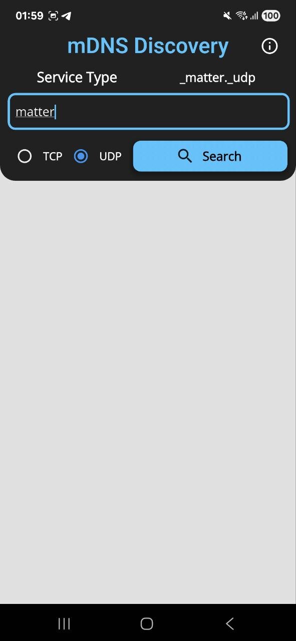

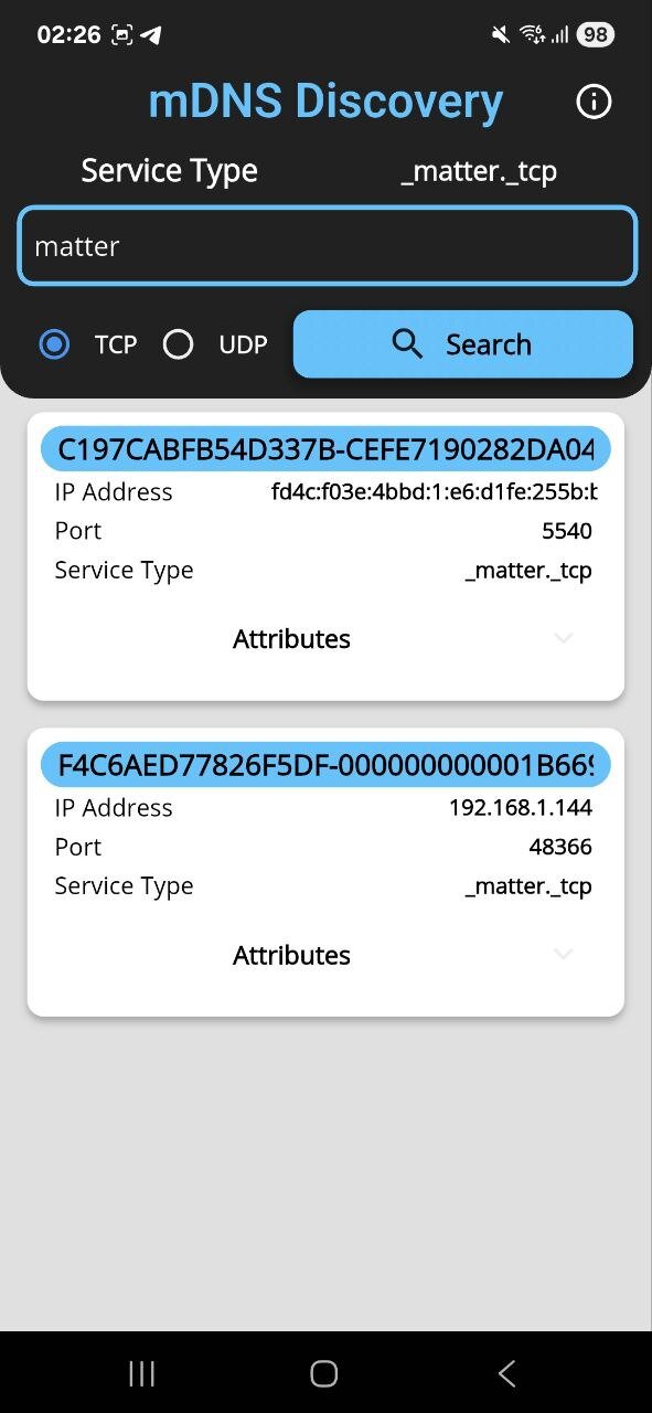

STEP 3: Check if your Android phone can discover the OTBR via mDNS
On a Linux machine (like your Unraid NAS), run:
avahi-browse -a -r | grep -Ei 'matter|thread|meshcop'
This should list _meshcop._udp or _matter._udp services coming from your Home Assistant.
Alternatively, from the Android phone:
  • Install an app like Bonjour Browser, Discovery, or Service Browser
  • Check for:
    • _meshcop._udp.
    • _matter._udp.
    • any HA/Thread-related mDNS entries
I am able to see the _meshcop UDP service using the mDNS Discovery app on my phone, and avahi-browse on Unraid.
However, I don’t see anything for _matter UDP.
After trying to commission a device, I see 2 devices for _matter TCP: one for IPv4 and one for IPv6.
OTBR
I first had to enable the Web UI in the add-on configuration.
This is what I see on the Status page:

Output of docker exec addon_core_openthread_border_router ot-ctl state
leader
Done
Output of docker exec addon_core_openthread_border_router ot-ctl router table, before trying to commission a device:
Output of the same command, after trying to commission a device (it failed):
Output of docker exec addon_core_openthread_border_router ot-ctl netdata show
Output of docker exec addon_core_openthread_border_router ot-ctl prefix
Output of docker exec addon_core_openthread_border_router ot-ctl backbonerouter
Error 35: InvalidCommand

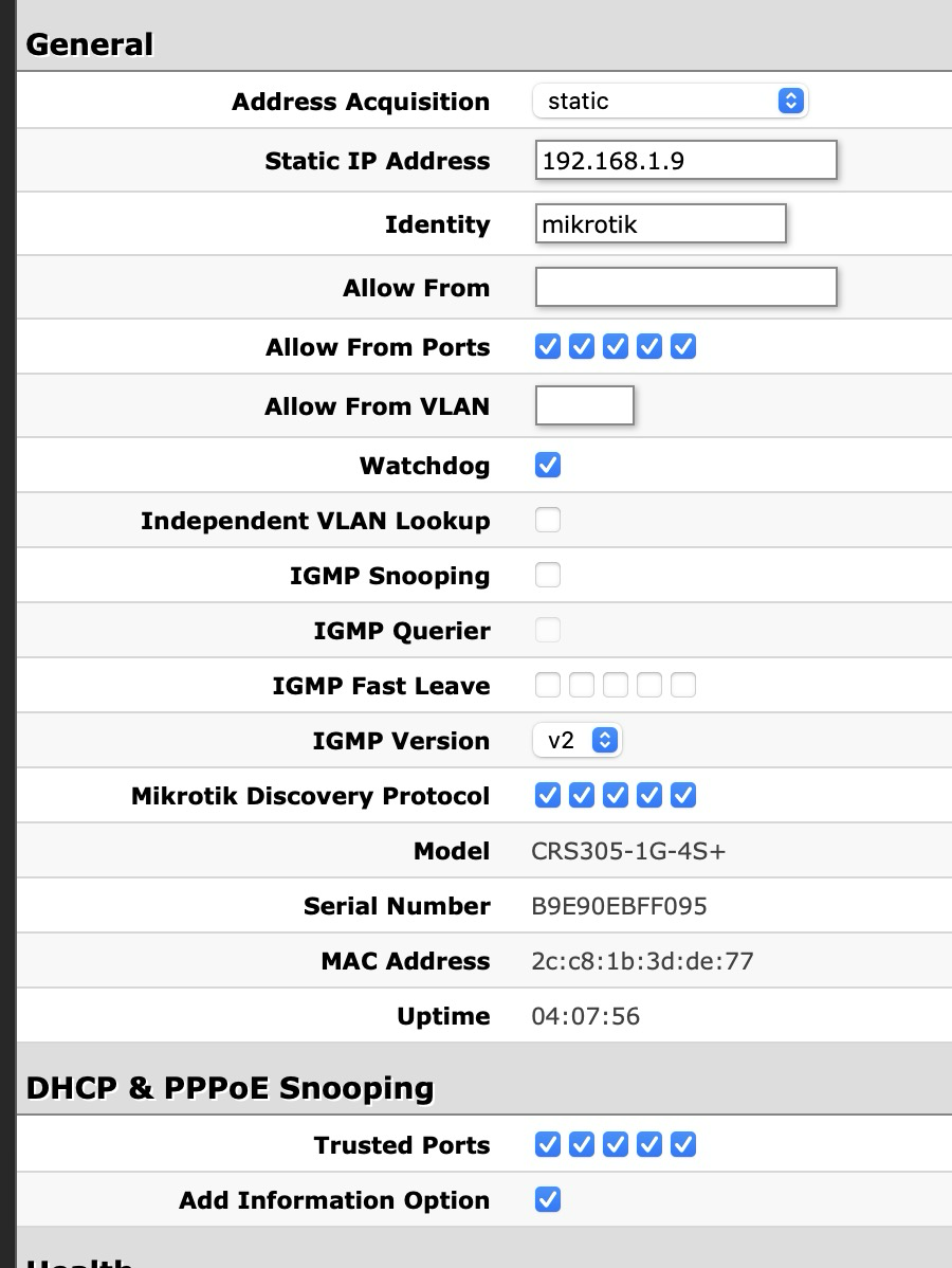

Configuration of my Mikrotik CRS305
I figured it would be useful for you to know the configuration of the switch my NAS is connected to.
I do not use VLANs and IGMP Snooping is disabled.
(I temporarily set the IGMP version to v2, it didn't change anything. it's now back to v3.)
Edited by wblondel
add CRS305 configuration

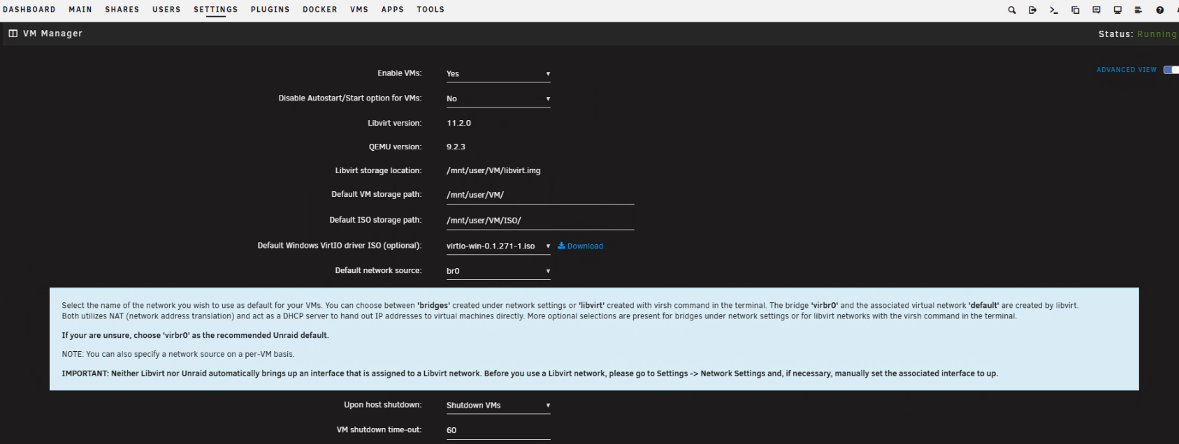

With VMs off. Go to settings > VM Manger
Advance toggle
*Make sure the Default Network source IS NOT Virbr0 This for some reason causes some vm and unraid networks cross talk issues as seen with your iptables command.

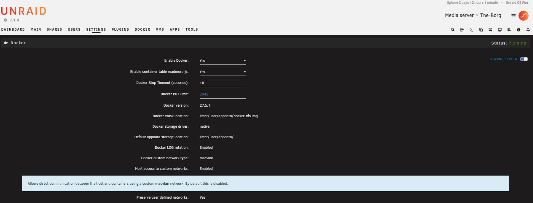

Then under docker networking settings Make sure you have host access to custom enabled :
and restart unraid to apply the new networking config...

The default network source on the VM Manager is br0.
For Docker, host access to custom networks is disabled but why does it matter in my case? HAOS is in a VM...
Anyway, I enabled it and changed the VM interface to this:

You say "Its also not clear how your connecting to HA from the Android device"
The answer is on my very first post. ---> "I am trying to commission an Eve Eenergy (Matter over Thread) plug with the Home Assistant Android app on my Samsung A55 5G phone."
You say "as you were seeing some matter udp on the android but not else where"
--> I never saw Matter UDP anywhere. Only Matter TCP services after trying to commission a device. And I see them from any device.
