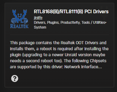

ok so you may need a nic plugin driver...

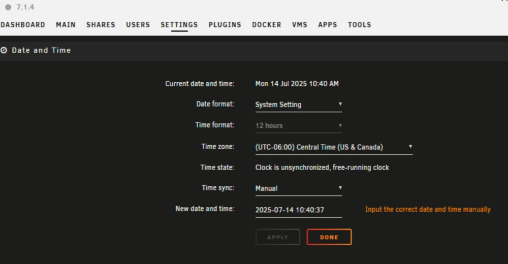

link/ether 02:42:6d:a3:fa:6a brd ff:ff:ff:ff:ff:ff
12: br-ae25bf0cd9b4: <NO-CARRIER,BROADCAST,MULTICAST,UP> mtu 1500 qdisc noqueue state DOWN mode DEFAULT group default
this tells me you hvae a broken docker network setup... Please post a diagnostic file. not enouth info to assist.

I would have you also replace the cable from eth1 to the network as eth1 is not getting a full mdix packet that auto sets its speed / duplex curently it was reading as it is unknown...
Also Please install the reltek driver for unraid:
Be aware of Realtek r8169 driver quirks
Unraid’s Realtek r8169 driver is notorious for instability, especially under load or with certain chipsets. Users have seen frequent "Link is down" messages in syslog.
A longstanding community suggestion is to replace it with the vendor-provided r8168 driver, which many find more reliable...
Steps:
  • Install the Realtek driver plugin for Unraid (search CA for "Realtek").
also try to run
ifconfig eth1 down
ifconfig eth1 up
to fully bring the interface down then up...

I just wanted to chime in as I am experiencing the same issue after upgrading to version 7.1.4, where my server would become unreachable basically daily. I don't have a keyboard/display hooked up to my server, but I could see it was online when it went unreachable, and I would reboot it and it would come up fine. I turned on syslog mirroring to my flash so I could check the syslog after these reboots, and found that I had the exact same syslog messages as seen here (r8169 error messages / link down).
I converted my docker configuration from macvlan to ipvlan as was suggested elsewhere, which did not resolve the issue. The server went unreachable again, and I received the same syslog message.
After the last reboot I went ahead and installed the realtek driver for r8168 from community apps, rebooted for the driver to take effect, and so far so good. I have not yet had another instance of it going unreachable.

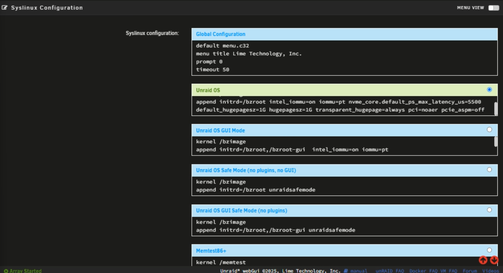

otherwise I would recomend some syslinux / unraid gruub boot edits...
I would recomend runnign with theses grub boot options..
Click Main Tab > click on Flash > Scroll down to Syslinux Configuration
Lets add these options...
acpi=force acpi_osi=Linux usbcore.autosuspend=-1 pci=noaer pcie_aspm=off r8168.aspm=0
Kernel /bzimage
append initrd=/bzroot acpi=force acpi_osi=Linux usbcore.autosuspend=-1 pci=noaer pcie_aspm=off r8168.aspm=0
*You must reboot to apply the grub settings...

Due to bugs with ntpd and time I would recommend using only 1 ntp server if auto or turning that to manual....
settings > Date and time

  5. GRUB Edits - I have made th eedit.

  7. I have set 1 NTP server ... but kept automatic

And please note that this ran fine for 6+ months before the latest version of unraid ... (and me adding some docker containers).
I have had issues with network and unraid previously - on an older i7
Jul 15 14:59:47 raider autotweak: Failed to set ASPM policy
Jul 15 14:59:47 raider autotweak: Set r8125 ASPM to disable
Jul 15 14:59:47 raider autotweak: Set r8168 ASPM to disable
OK, this may be a docker realted issue as well. time will tell on that though...
what is the output of lspci -v what is the drive in use for the onboard nic? r8125 or r8168 or both 2 realtek nics onboard?AS This may be caused by autotweak plugin... as if it not able to write its config correctly. but this is expected if your using the grub option I mentioned. as We set it earlier at boot and now its in the kernel.Please post a diag file if it happens again.we can add a sysnotif user script thatt needs manual run to look for exact working in the syslog and sine it happens constantly around 5 AM ish we can also have it look at that as well something I ediet for my needs to help scan and look for key words in the logs... adapted from another script on the forum...

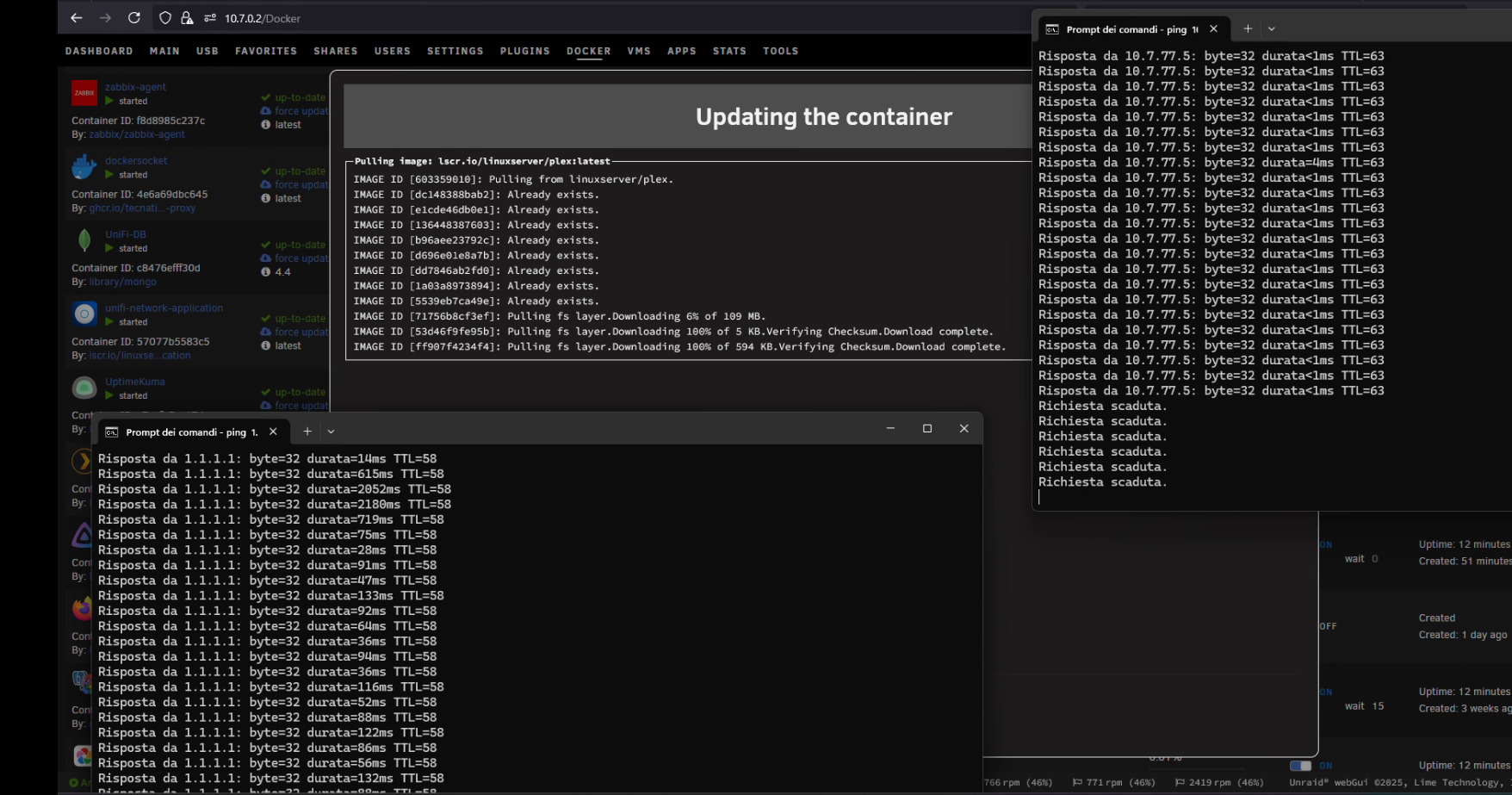

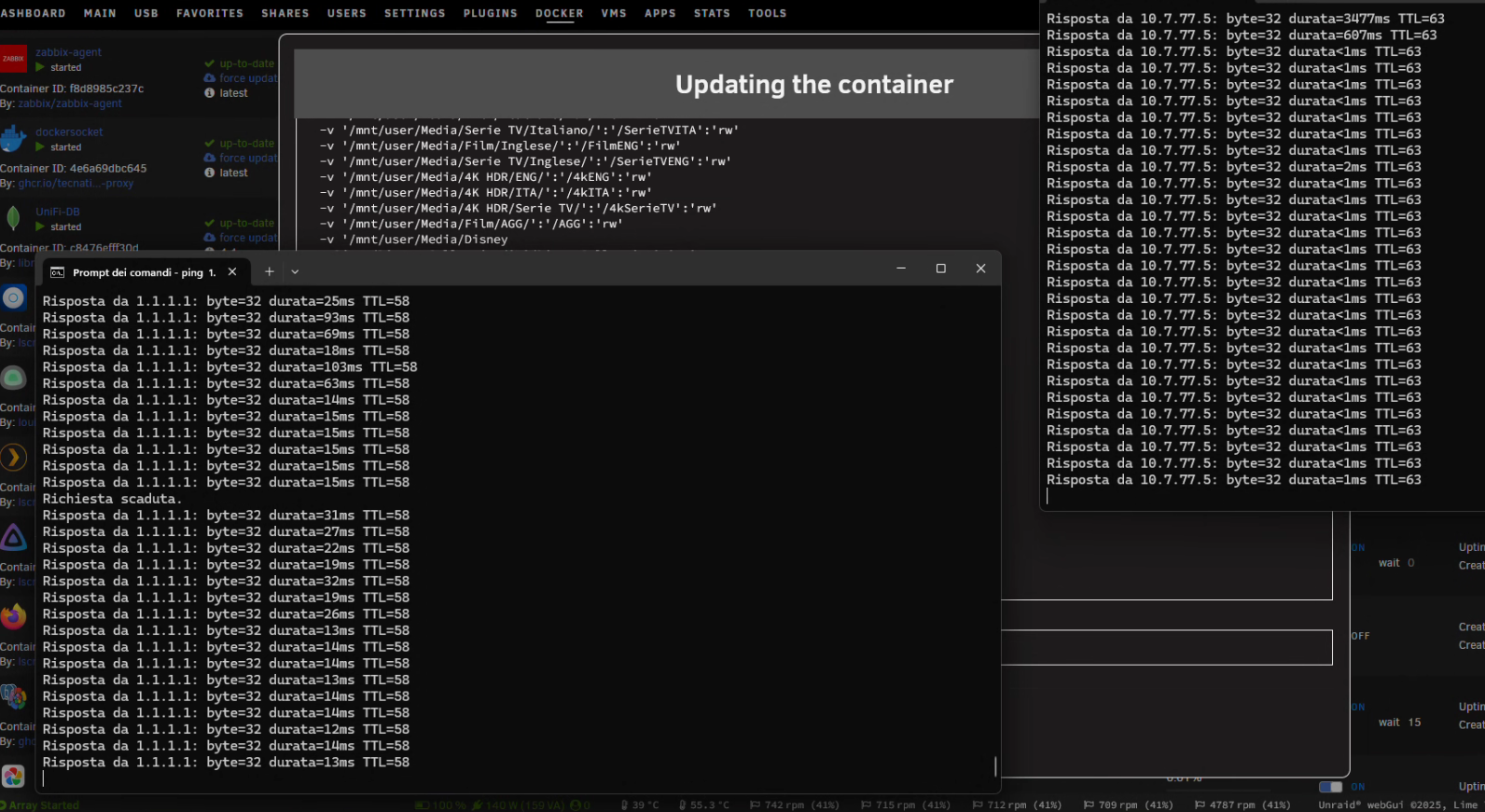

I'm facing the same issue, but my server, after upgrading to 7.1.4 from 7.1.3, started to totally kill my network around 3 AM, and it would recover only after 15-30 minutes.
After a week of trial and error, I narrowed it down to my unraid server.
It seems to be that when it downloads the docker images, it kills the ability of every single device on the network to reach the internet and each other, almost like if it creates a broadcast storm.
I was able to replicate the issue by manually updating a docker container:
In these screenshot I'm trying to ping from my Windows pc to another docker container (not the one being updated) and to the Cloudflare DNS, and as you can see, as soon as I start the container update, the internet ping becomes much slower and the other container stops to respond all together.
As soon as it ends, everything gets back to normal.
I uploaded the diagnostics file, but if there's no real fix as of right now, I'm thinking of rolling back to 7.1.3.
Just to add some context, I have a pfSense with 2 VLANs, and I'm using 2 Ubiquiti switches.
unraid-ws-diagnostics-20250715-1802.zip

@gguglielmi
Your issue is not the same.
19 hours ago, bmartino1 said:
should be it own general support thread while simlar not the same.
your are refering to the script screen and TTYl unraid limt resource.
the same can be seen when applying a docker temapte and opeing a new tab and trying to connect to unraid and do another task.
Unraid is not a muti user target nor task driven system. the applying of the tempatel, dolowading of thte docekr adn other are all apart onf 1 big script taht will and must take some things offline to reestablish them otherwise while it will be onteh system it will not be nt eh web server emhttp that unraid is running.
you can open a web ttyl and docker pull mutiple in mutiple web ttyl and not get the same discoenct or unresobive ness. this is becae only docker adn pull was called and not the other in teh intended operation of unraid.
the OP issue here is a different netowrk issues that is partly due to docker and the br1 setup, along with misconfiguration of the sleep plugin / autotweak plugin with power causng a disconect on the device entering a sleep state.
@gguglielmi
I opened a dedicated support thread, thanks.

This seems to be an unraid SOFTWARE issue - consistently at 5:00am - 5:20am on a random day the eth1 goes down.
Updating the driver and disabling power management seems to have fixed th eissue that the unraid box becomes unresponsive to eth1 after this event, but it still goes down and has issues for docker containers.
Below is the log showing several good days, then another eth1 down event at 5:00am-ish
