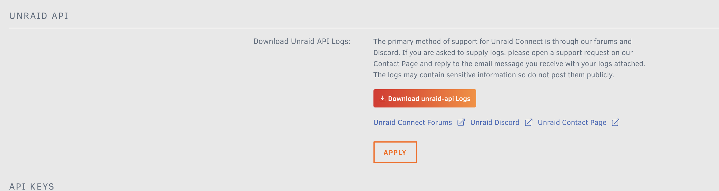

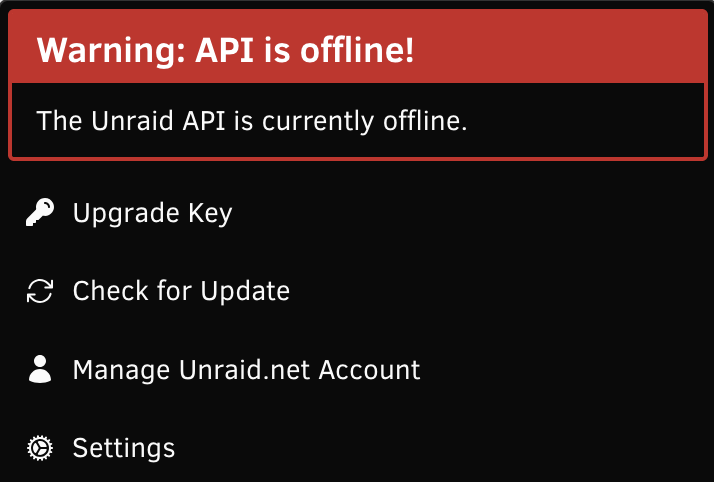

July 28, 20251 yr After installing Unraid Connect I always get the following error in the UI. I'm not sure the unraid-api is running. Based what I've seen in the forums, I tried starting the API via CLI and the unraid-api utility doesn't seem to be available as the command is not found in my server. I've tried uninstalling/installing the Unraid Connect plugin but still, I'm unable to login from the server to Unraid Connect. Below is all I can see in the Unraid API management settings. What am I missing? Any ideas on what the problem might be? Edited July 28, 20251 yr by ajmaradiaga
