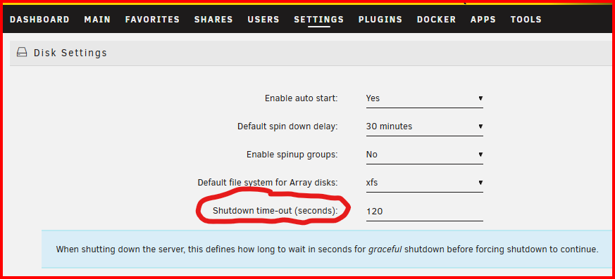

Stop the array manually.
IF the array won't stop manually, then the shutdown commands will force a shutdown after waiting for a preset time (Thinking of pulling the power plug) and that results in an unclean shutdown every time.
That predetermined time is set here:
