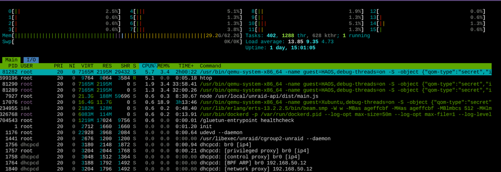

August 5, 20251 yr For months now my server goes unresponsive about every 2 days and I've had to hard power down to get it back. When it's back it runs like a dreamUnresponsive means:I can't access GUI dashboardI can ssh. 'Reboot' with force or otherwise gives me a beep but not a shutdown. Docker Stop commands fail. HTOP suggests 3 CPU threads are stuck on 100%Docker stats suggest all my docker containers are running, but I can't access access them either locally or through reverse proxyThere is nothing of any importance (error/warnings) that I see in the syslogs or via dmesg.Failure times are random (middle of the night, middle of the day, idle times, busy times) - I can't pin-point to anyone container or scriptIn troubleshootingI've changed/upgraded all of PCI cards, memory and processorUninstalled many pluginsTried switching off the dockers (but not all yet)Rebuilt docker vdisk (twice)Switched off all VMs completelyPrevented drives from spinning downEnsured BIOS Idle settings are as everyone suggests (C-states disabled, idle control typical, cool'n'quiet disabled)Removed all USB devicesChanged UPSUse Docker ipvlan networksTemperatures are all okHammered the box with 90% cpu processing for 7 hours - no problemAll disks have plenty of capacity / SMARTs are goodThe server cannot survive for more than 48 hours....Can anyone spot anything in my diags?Do I need to reinstall the UNRAID OS perhaps?It all suggests to me that something is 'building up' or hamming the system - but what is it?ANY suggestion is welcome. I'm almost ready to give up.ding-a-ling-diagnostics-20250805-1130.zip Edited August 5, 20251 yr by late4473 Add brief HTOP findings.

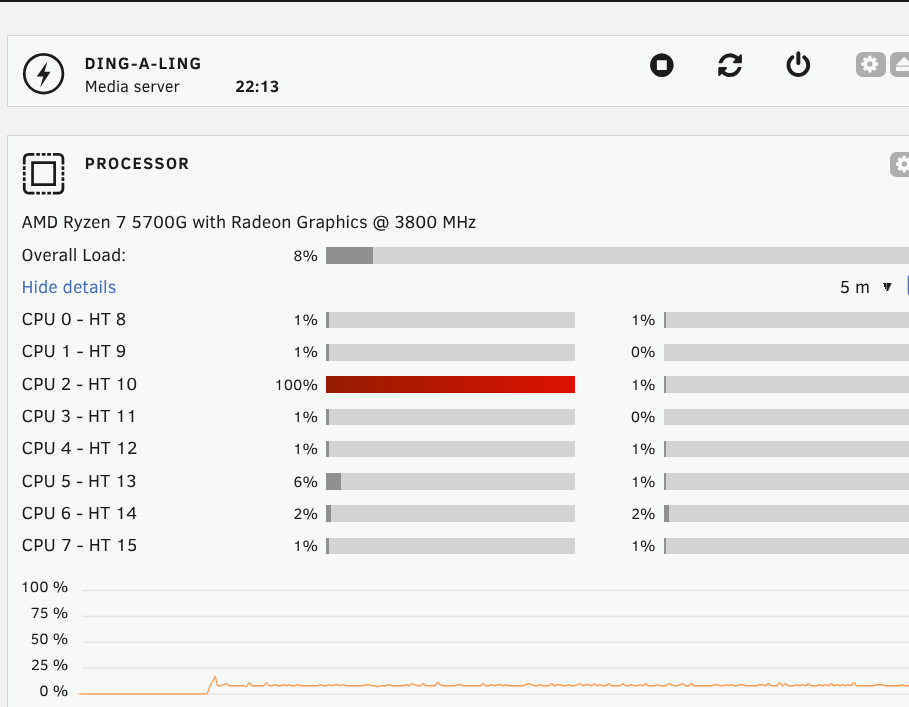

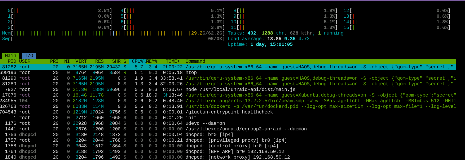

August 7, 20251 yr Author @JorgeB Here is the syslog and some other screenshots. Died 6-Aug @ 22:10ish i.e. All dockers stopped responding. Hard reboot and all is well again....cycle continuesI could access unraid GUI - note a CPU thread locked at 100%HTOP doesn't report the same locked CPU but is reporting the load average endlessly climbingThere is an recurring error about a missing css file. I have tried both 'light' and 'dark' settings but this file is always missingI hope you can spot somethingThanks syslog-192.168.50.12.log

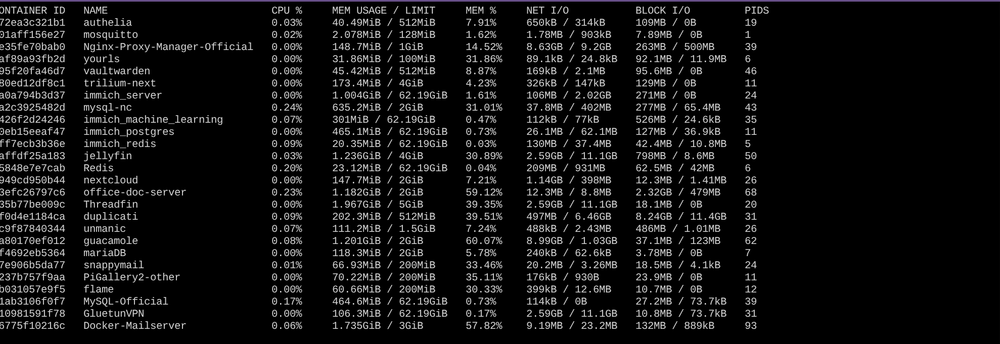

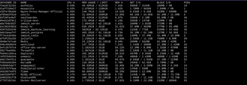

August 10, 20251 yr Author My server survived for 4 days or so - and the unresponsive behaviour at the death was slightly different. I could access GUI (all looked normal) - no reported stuck CPUs but all docker containers unresponsive. Any attempt to stop them resulting in 'server error'. I did notice my Docker PID limit was on the default (2048) and a quick docker stats showed I was in the high 1000s so have now bumped up substantially and restarted.Watch this space.
