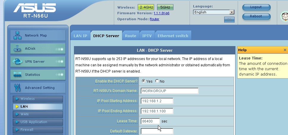

Should be a setting in your router to change the lease time.
Also, if you configure unRaid to use Static IP, then you will not get those messages either.

Average lease time ~7 days, or set to a static IP.
I recommend setting a static IP reservation linked to the MAC of the network card on the router side, and leave the client on DHCP. You get almost all the benefits from the static IP column, and the only downside is the minimal network activity. The big positive in my book is the ability to centrally manage all your equipment's addresses from a single point. You really shouldn't need to have the lease renewal time set for less than 24 hours anyway on a small home network.
