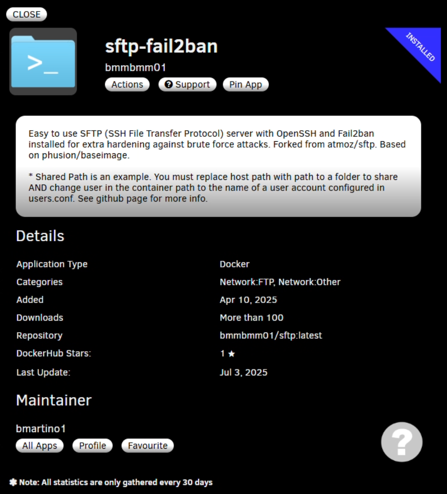

August 29, 2025Aug 29 Community Expert I would recommend a file transfer ring network using sftp.It really depends on the file type, confirmation and what you're tying to back up and send.Yes a VPN is similar and can be used to act as if his severe is on the network and right next to your PC. (albite a bit more complicated than that)I do a ring network of the sftp docker and filezilla (docker/windows over samba share) to move file between our systems.There a few plugins and apps that exist in the CA as well that can help you here.Like the appdata backup plugin to back up the unraid flash drive and docker configurations and data.Even a rsync/rclone other docker solutions such as syncthing.But I personally am a fan of the sftp filezilla SSH connect and share.I've even update and made a docker for this that includes Fail2ban.You can even use tail scale or WireGuard to make and self-host a inner communicated internet network for secure access to send and receive...It comes down to what you want it to do and how you want to interact with it.Since I'm mainly dealing with large files for data I thought it best to use the actual FTP for a proper protocol systems to interact between the 2 machines and have scripts using zfs to zfs send, snapshot and monitor the data. I edit unraids samba to force and set certain file permission as I run a windows VM out of the unraid system.I would first recommend making and having a share setup as a staging area. Edited August 29, 2025Aug 29 by bmartino1 data / spelling

August 29, 2025Aug 29 Community Expert 5 hours ago, unburt said:Thanks for such a detailed reply. That gave me a lot to think about and was helpful for making me consider more clearly what I am hoping for:We're planning on syncing our photo libraries to each other's servers as an offsite backup.Some kind of protection to prevent snooping is optional. We're somewhat concerned we'd forget the encryption password if there are significant barriers to accessing the data.Backups should be automatic.Immediate transfers are probably unnecessary. Weekly or nightly is probably suitable.Based on this, I think the sftp/filezilla suggestion might not suit me as that sounds like a manually initiated backup?The solution from the unraid blog does seem like a good fit and I guess I was sort of aware of the concept. I will need to put some time into understanding the rsync flags. And what level of access a "server to server" wireguard tunnel provides.As Frank said you would most likely use rsync over sftp.User script plugin to automate.I have a docker Linux server filezilla that I user script to start the docker that is automated to sync file using file zila. It's pre pointed to directly not the easiest to setup but a example.Most would use a ssu connection of some form to access the system.As Michael said other apps like u backup, sync thing and other backup docker can be setup and automated.Docker start XYZ name of backup.Still comes down to what you want it to do and how you want to interact with it.There are many ways to accomplish this.
