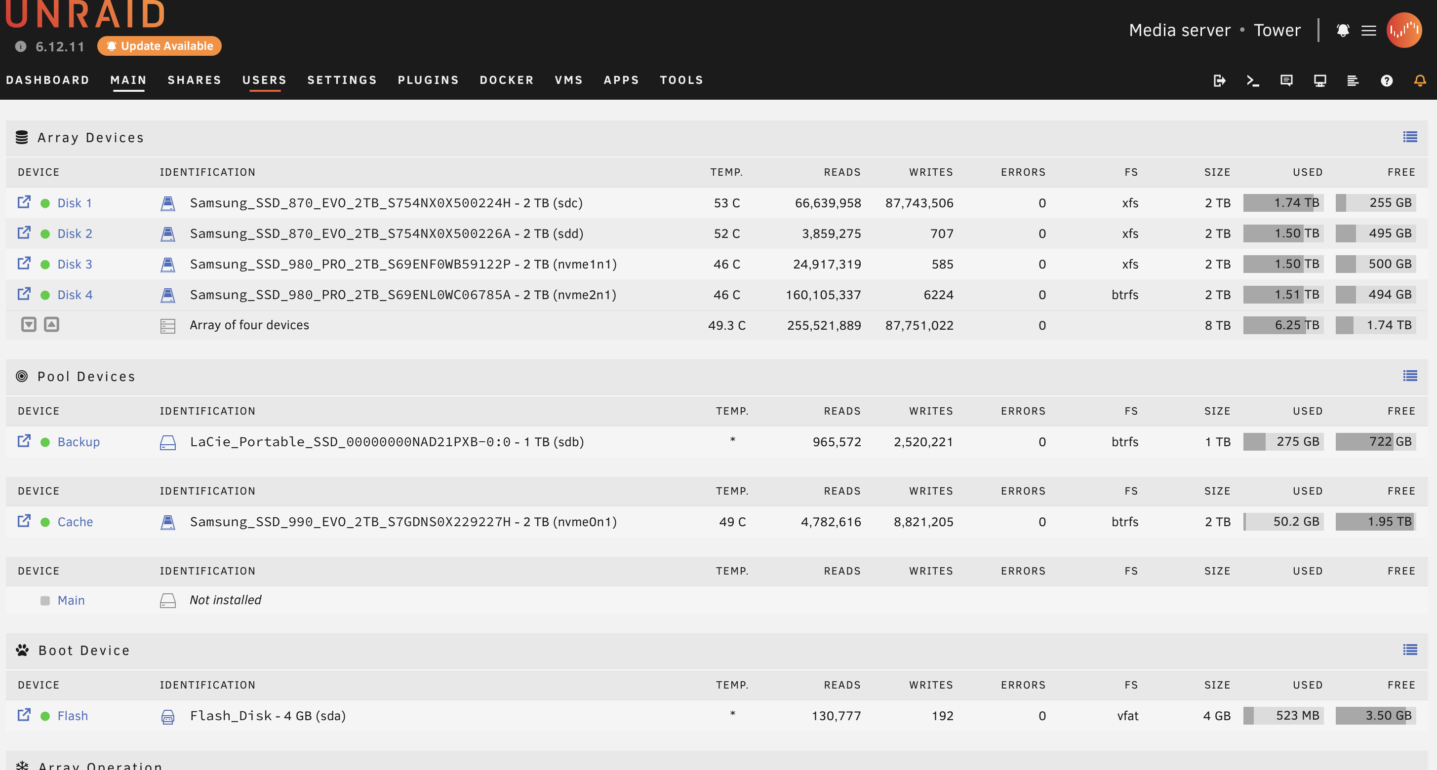

Ran a command while array running. Server won't boot
Are you sure sdb wasn't the boot device?
Do you have a current flash backup?
Pretty sure it wasn't, here is the config, the drive that had issues was 'backup'
Flash disk is sda and wasn't removed.

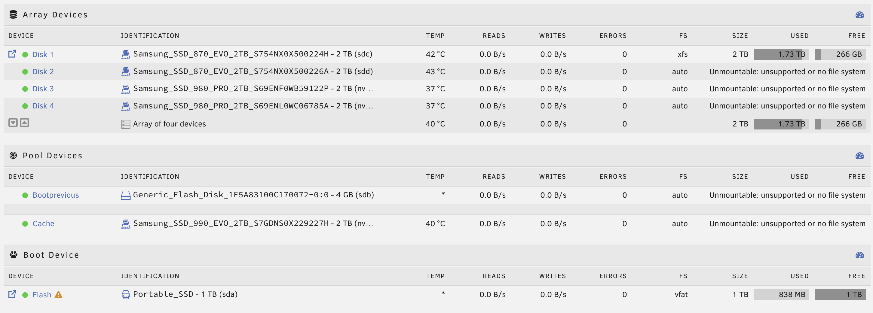

I flashed the old backup disk, installed Unraid and booted from it.
Now able to check the drives, config, etc, not sure how I could re-establish/correct boot process from now on though
ok so lsblk shows all my disks, sda and sda1 (boot) are still there
How can I set sdb as boot partition?
sda is current temporary unraid installer.
sdb is original Flash Drive partition but I can't find anything on it.

Ok so I set up the array again and I have 5 disks showing as unmountable... :/
I'd like to retrieve sdb as it's the previous flash drive.
@anyone ?
I am confused - sdb in your screenshot is not a
What do you want to boot from there? Unraid always boots from a flash drive, and that flash drive needs to be present all the time Unraid is running.
Unraid does not have an 'installer'. Device sda is the current Unraid boot device.
Do not understand this statement at all?
Your fdisk shows that sdb is partitioned with a Linux file system whereas sda (the boot drive) has a FAT32 file system.
Please don't blindly run commands you've found on other posts; it may be a similar symptom but caused by an entirely different problem.
The command you ran is most likely wrong for an SSD, start by posting the diagnostics.
