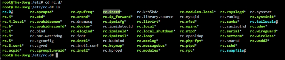

Slackware unraid uses systemvar and a networking inet rc convoluted net rc script found in the rc.d shich is the equilvent to the orgianl ubnut/debain servicers and daemons. before systemd was a thing. (where systemd esentail thorws stuf all over such as the home user folder for apps and server/daemons...) I do not like systemd...
go check it out

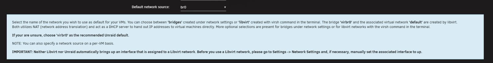

Further (Tangent on unraid VMS domain xml vm configurations...) see https://libvirt.org/formatnetwork.html
so if using the software links with a vms xml. your passing br1 or another interface...
there are even inet rc scripts due to some vm settings that can chage how ip routes and interfaces interact...
as this will change some inner communication.

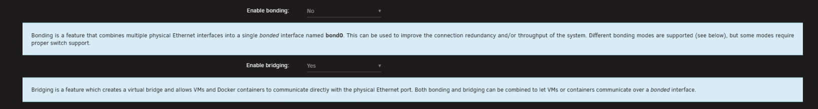

By default unraid ships with br0 bridging enabled as it is best practice to tie things to a bridge interface due to hardware nic limitations. not all nic support routing features and option roms on the nic for use. creating a software brdige and having a br0 intefaces makes up the differece. (this was a big issues in the past that not much of a issues now)...
(tangent to ahv unraid webui netowork config make the br1 eth1 dhcp)I do not recomend editing the config only here as a refference!
you can also edit the unraid netowk conig..

web ui picture of you settings > network for is bridging enabled is bondign enabled. and vm settign picture to see what your VM hyperv switch is set to where VM default get internet access. XML code can be used that goes agisn the setting and skip/bypass it as we may want to use something else in libvcirt domain xml format to tell th vm what we doing and how to use the interface...
