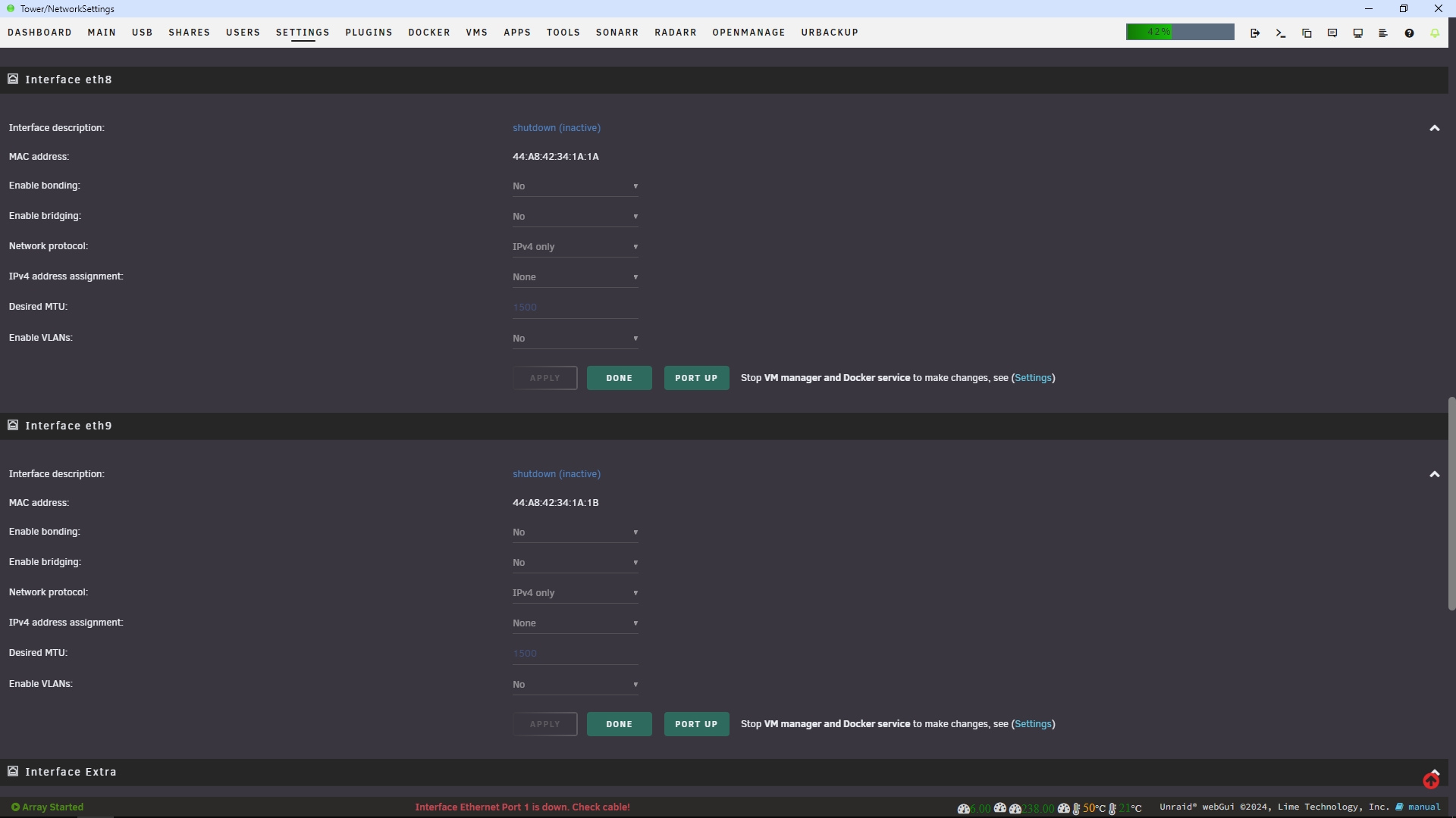

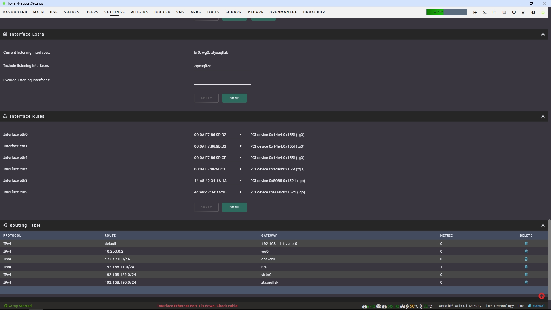

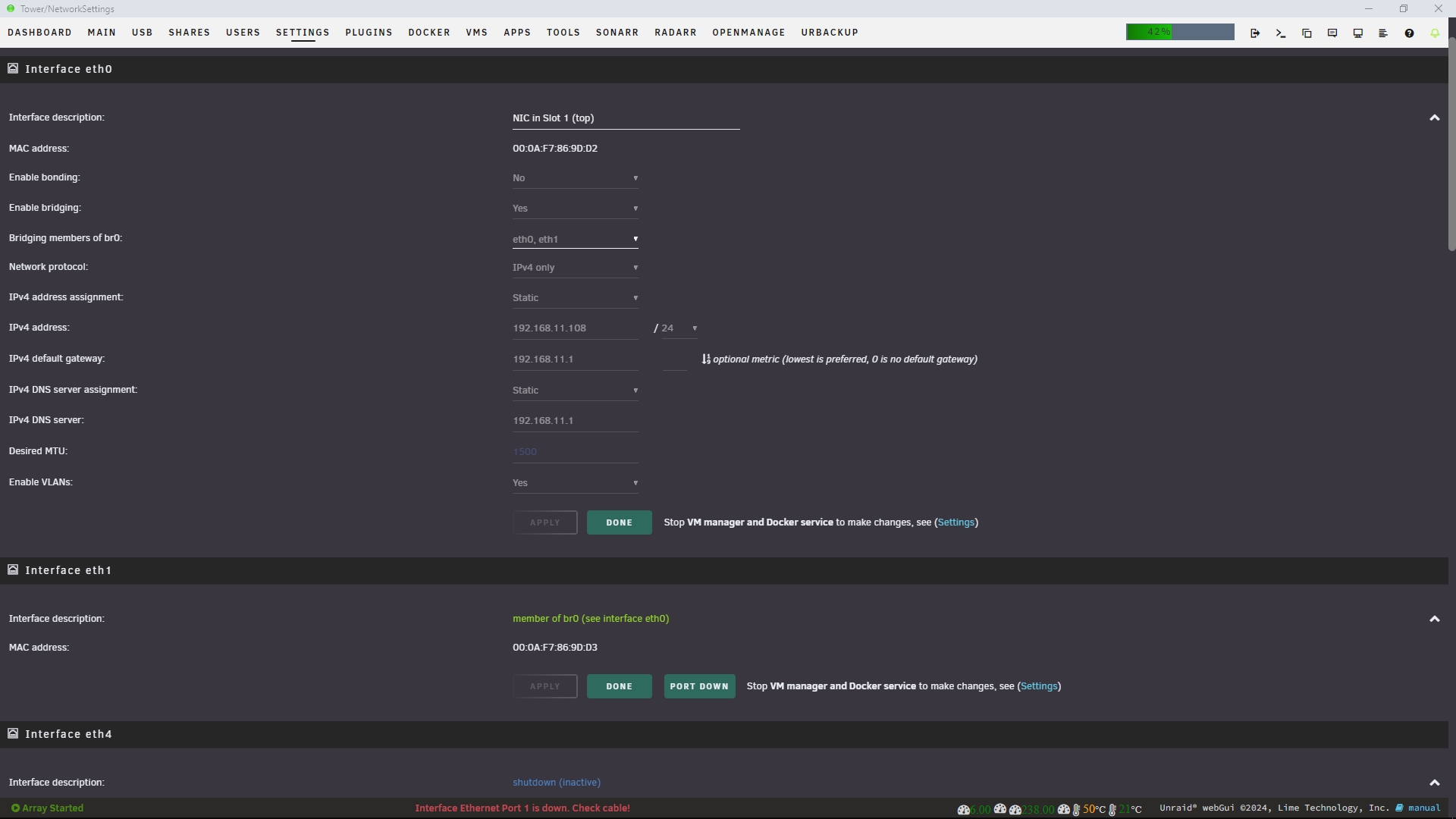

35 minutes ago, bmartino1 said:
Let's run through some basic networking and docker settings.
What are your unraids network settings?
I'm more interested in the setting for bridging and bonding...
Mine looks like this...
1020877791_cap002.thumb.JPG.af1cdaaea0ae1a73035715da4549e403.JPG1514736997_cap003.thumb.JPG.2e928acdfd15c05f161b039082bd5362.JPG614465057_cap004.thumb.JPG.22502d6ecc9985f871f0ddc89c1cb036.JPG1886740291_cap005.thumb.JPG.0222ab728266b94f541e62483300614d.JPG2111452066_cap007.thumb.JPG.128406c7e4126de91a49a491daed1e30.JPG
I feel like your post contains excellent, and extremely useful information, I'm just too ignorant to make use of it. lol :(

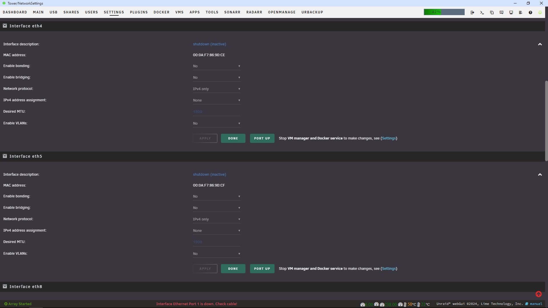

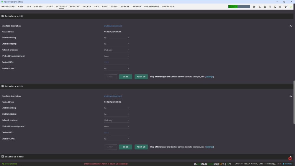

...pictures...
No worries. It look like you are running multiple nics via a blade server. I recommend using a macvlan drive in your case. I would always recommend to use macvlan over ipvlan unless you require vlan network separations.
Per maclvan setup release notes: https://docs.unraid.net/unraid-os/release-notes/6.12.4/

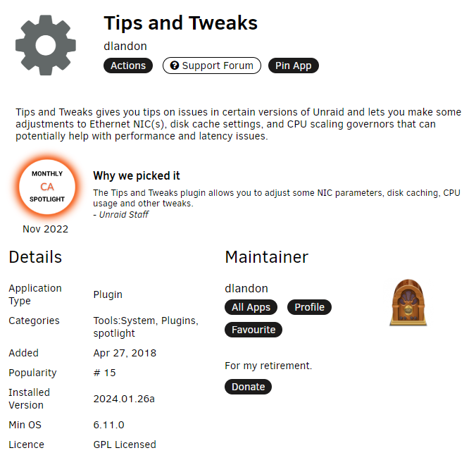

I also recommend installing the plugin Tips and tweaks:
Goes over information about the settings.

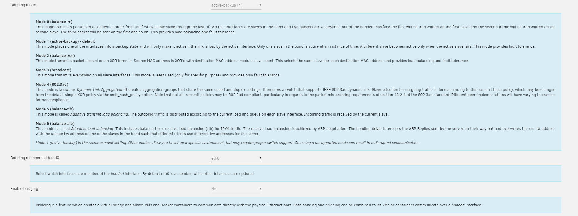

Your system atm is using bridge mode and ipvlan for docker access. This should be fine. Surprised to see more than 5 nics on 1 box.
However, bonding is similar to bridging in this case. We get a vhost@interface to act as a gateway between network interfaces. I would recommend you using bonding over bridging to maintain your network.
To do this, you will need to have some downtime to turn off some services of that box to edit these settings.
unriad webUI > settings> VM > disable
unriad webUI > turn off auto start of all docker (as there may be some template edits to fix networking...)
unriad webUI > settings> Docker > disable
unriad webUI > settings> NetworkSettings
I'd recommend turning off bridging and turning on bonding.
bond eth0 and eth1 as your past configuration for bridging the 2 interfaces.
bonding will also open up more setting for you for fail over , backup if one goes down etc...
Then we need to check and fix some docker settings.
unriad webUI > settings> Docker > advance switch
its fine to continue to use ipvlan docker driver. you should enable "Preserve user defined networks" and Host access to custom networks.
click apply with docker still off to make changes.
-?There may be a reboot required.
Then enable VM and Docker.
Confirm dockers by edit the docker template and fix network if needed. Br0 should be bond0 now.

EDIT:  So I did install the Tips and tweaks plugin, thanks!   Are there specific changes I should be making, using that plugin?

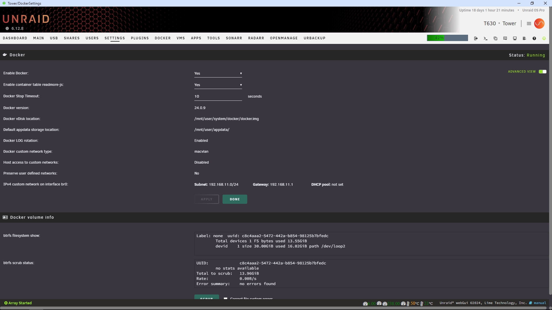

1 hour ago, bmartino1 said:
Your docker settings are trying to use a macvlan setup per your settings. But there is a known issue with macvlan and bridging on. Yes a call trace is bad, it's a system crash / freeze.
Okay, got it, thanks.  I'll see about switching over to ipvlan.

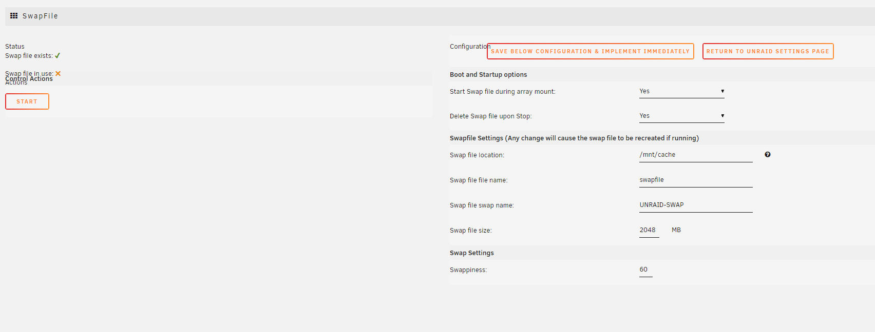

This message is normal, unraid does not support SWAP by default. It is an unraid limitation.

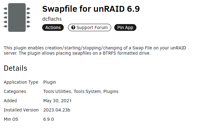

To fix swap messages. You can install the plugin:
The swap file doesn't need to be used, but does need to exist. a reboot may be required after setup.
I recommend making a 2 GB file on the cached drive:
This has been the only fix I have found for some dockers that may show error for swap.
By default, disk configuration, 3 disk min for proper setup
2x disk array disk 1 and parity
1x ?ssd/nvme disk for cache
by default, unraid cached disk is btrfs unless you changed it earlier.
You must have a disk attached to unraid and the disk has to be formatted as btrfs to use the swap plugin.

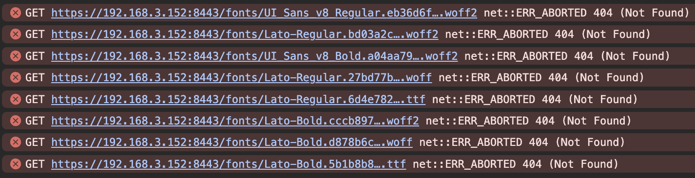

Thanks for creating this image. I ported over with no problems.
One thing I noticed in the browser console is that font files are failing to load. I'm not sure if this expected:
I can check but I doubt it is important
EDIT: I'll follow up on UI forums, looks like someone else spotted it as well:
https://community.ui.com/releases/UniFi-Network-Application-8-0-24/43b24781-aea8-48dc-85b2-3fca42f758c9#comment/87c8b4cc-3b0e-4927-a271-fc61aedaff24
Looking in the container, I found the files at:
`/usr/lib/unifi/webapps/ROOT/app-unifi/react/fonts/`
I see that js i properly loading, for example:
`https://192.168.3.152:8443/manage/react/js/5869.2f02b1d33b809f53b77e.js`
But the path to the fonts is missing the `manage/react` prefix:
`https://192.168.3.152:8443/fonts/UI_Sans_v8_Regular.eb36d6ff9c768a1639ca397b4dd84137.woff2`
It looks like a Unifi problem with the wrong paths, unless there is some configuration option. You can see the inline style loading the wrong path:
Edited by veeco
Thanks. Will just let unifi resolve it then.
