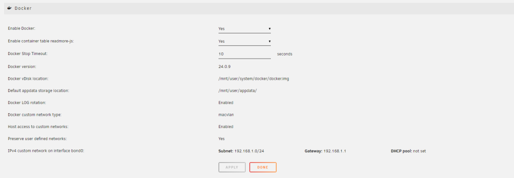

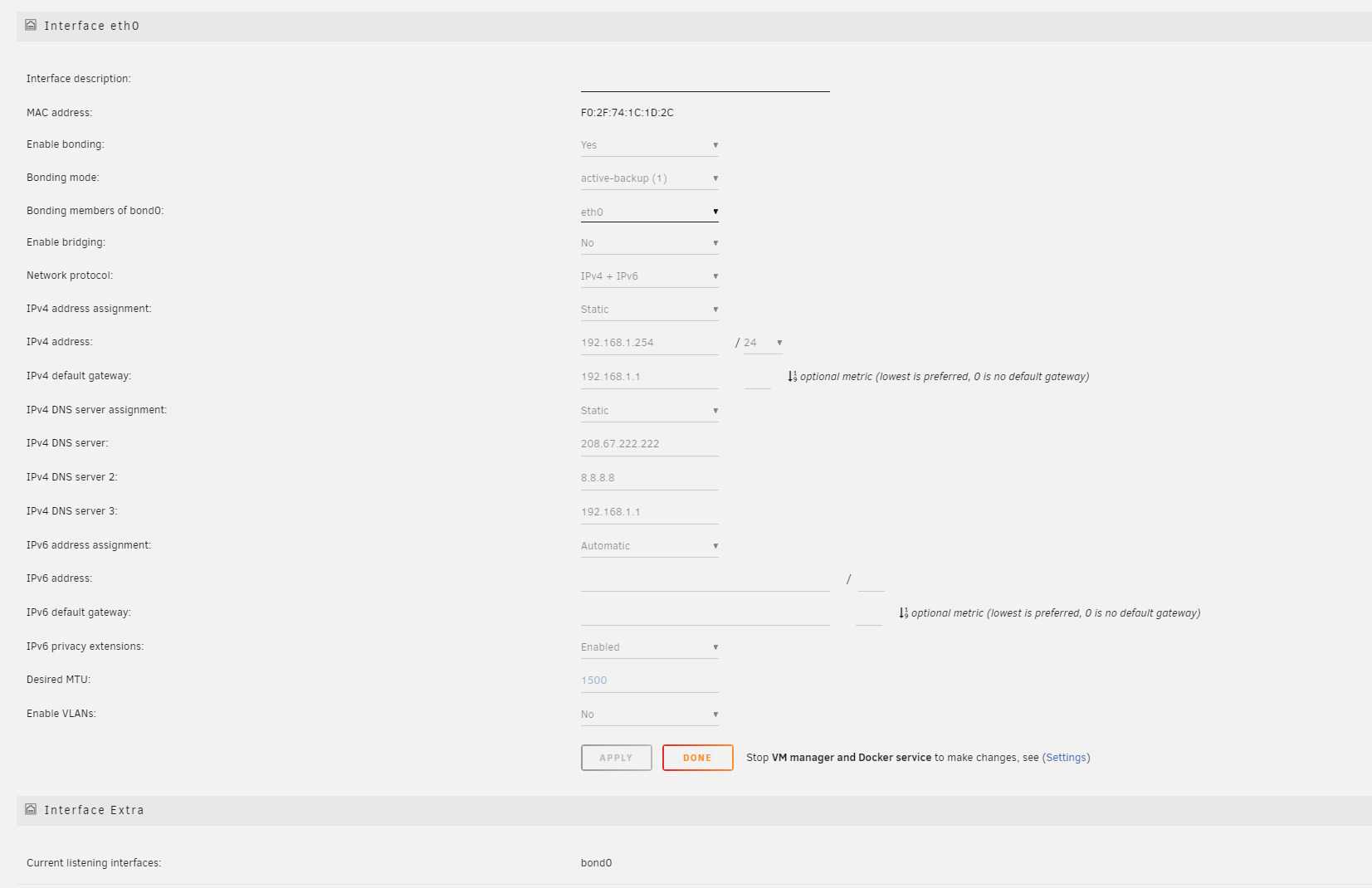

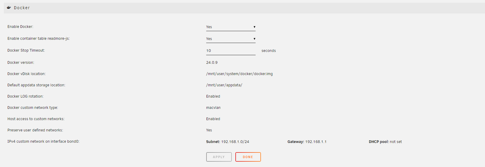

On 3/7/2024 at 4:59 PM, bmartino1 said:
Let's run through some basic networking and docker settings.
What are your unraids network settings?
I'm more interested in the setting for bridging and bonding...
Then what are your docker settings?
More interested in Docker custom network type: and host access.
This is my configuration for a proper custom bridge IP settings for macvlan network access.
Depending on how you want to use the docker network and how you want to access dockers from unraid we will need this information to know what type of network setup you are using.
read about docker network types here: https://docs.docker.com/network/ and https://docs.docker.com/network/drivers/
Custom br0 is a type of bridge driver...
By default, Unraid has bridging enabled and wants docker network to use ipvlan.
This changes how docker setups and communicates network traffic to the docker network.
If we run a docker image and set the network to host. The ip to access that docker if it has a webUI will be the same ip as the unraid system. Any ports the docker has will replace unraids ports and is more for items like clam av to scan itself or databases you want on the LAN to be accessible via your local network.
Bridge network mode uses the Unraids Default 172.x.x.x dhcp server and creates a switch port bridge to communicate via sharing your unraids network adapter. your docker is asigned a 172.x.x.x address in bridge mode and how it communicates depends on unraid docker setting, ie macvlan or ipvlan. But more to do with host network access.
Custom br0 means to bridge/bond the eth0 of your unraid and have it share a LAN ip address from your router. In my case my router dhcp is 192.168.1.x meaning the docker will get a 192.168.1.x unless I tell it otherwise. macvlan will make a random mac address to facilitate this, and some firewall/routers will see that your unriads ip is being duplicated or assigned to multiple devices sharing the same ip. (This is why the switch to ipvlan to fix layer 3 networking issues, buts only a problem with vlan network traffic controls...
If I run a macvlan network I can add an extra option and set a custom mac address to help router traffic. (this was required in older settings before "private mac" and phones were connecting to the internet to guarantee a network path access.
macvlan extra parm in docker : --mac-address 02:42:C0:A8:01:XX ->hexadecimal (0123456789abcdefgh) replace xx with a combination of a hexadecimal group...
Then the router can static assign.
Unfi has a host adopt feature that looks for a dns name unifi on the network you want the unfi network application to have a dns name set to unifi. So I also run macvlan to add hostname: extra parameters:
--mac-address 02:42:C0:A8:01:0A --hostname unifi
^This now give me the ability to statically assign an ip address. Via dhcp on custom br0 network which is the LAN DHCP IP from my router...
Unraid to use custom br0 it is recommended to static client asign an ip address. So custom br0 will be 192.168.1.x
this mean I can access the unif application at 192.168.1.x
Basic network that is dependent on what you run and how you run it. We need more info for troubleshooting network like these.
