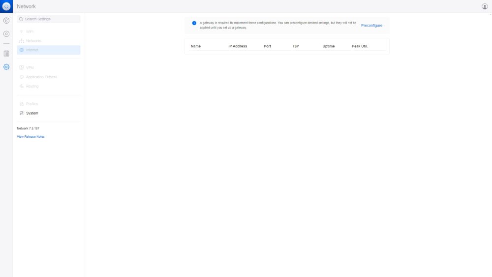

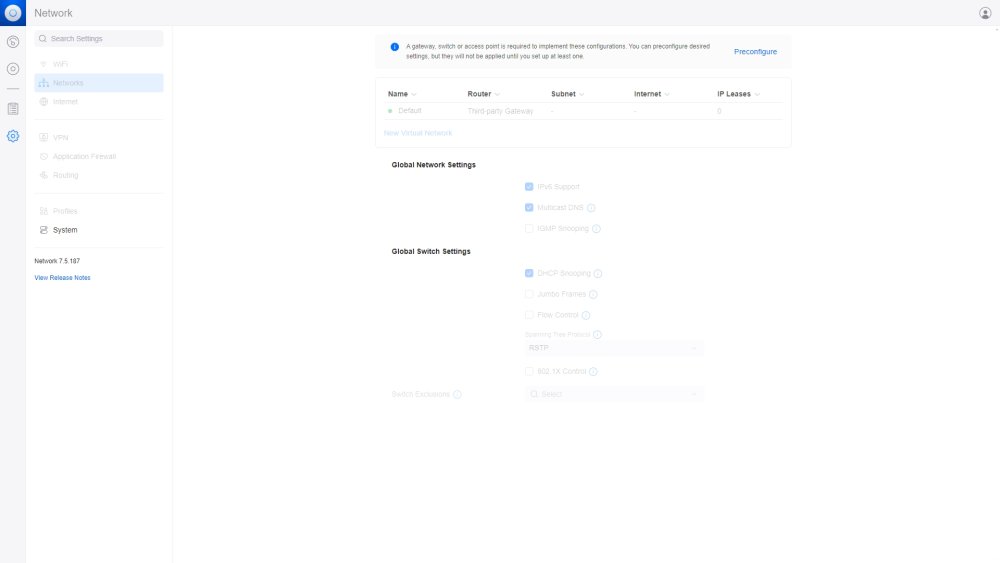

Ok, so it's back up, and I'm in the webUI, but I still have the same screens.  Most everything is shaded out and unavailable.  It says I need a gateway...
10 minutes ago, Elmojo said:
Now he tells me! lol
Im unclear exactly the screens you refer to. Can you describe what is happening further or in more clarity?

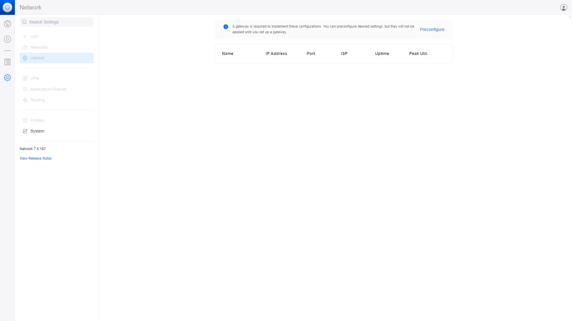

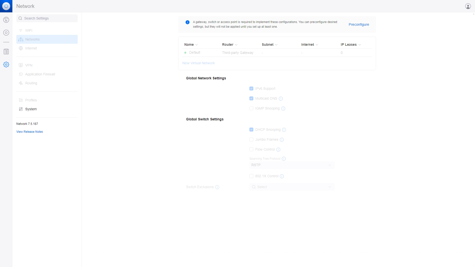

The Unifi Controller webUI.  I'm logged in, but it's mostly unavailable.  It's telling me that I don't have internet, or access to any of the network or WiFi screens, because nothing is connected.  I understand the WiFi part, since I have no APs connected yet.  The rest I don't understand.  How do I connect this controller (docker) to my network, is basically what I'm asking.  See the screenshots.
They become unlocked as you adopt devices. You wont have access to the gateway features as you are using pfsense and you cant adopt a usg with a self hosted container.
if you adopt a switch, you can edit network settings. If you adopt a wifi ap you can modify wifi settings and so on. Otherwise its greyed out.

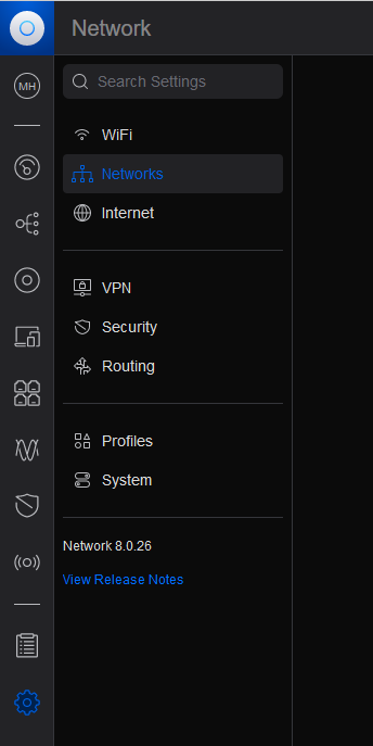

Actually, that doesn't quite seem to be the case.  I have only 1 U6 Pro AP adopted, and I now have all the icon categories along the far left available, and under settings, I have WiFi, Networks, and System.
However, the wifi isn't really working.  My phone says it "can't connect", but the Unifi dashboard is reporting that my phone is indeed connected with a "good (70%) experience", which is really worrying, since the AP is sitting about 8 feet away from my phone.  If this is the type of "experience" I can look forward to with Unifi devices, they may not be for me.
I realize I'm likely doing something (or many things) wrong, but this all just seems far more difficult than it should be.  Running the Unifi controller software behind one of the world's most popular router/firewall software should be a well-documented process.  It baffles me that I'm having such a hard time finding clear, step-by-step tutorials for how to make it happen.
Sorry for the rant, it's been a rather frustrating couple days... :(
EDIT:  Got it (kinda) working.  It had prompted me to create a new network, but that wasn't working, so I deleted it and changed the wifi back to use the "default" network, and that seems to be working, sorta.  It will drop the connection on my phone randomly, but at least it's connecting now.  I'll investigate more later...
