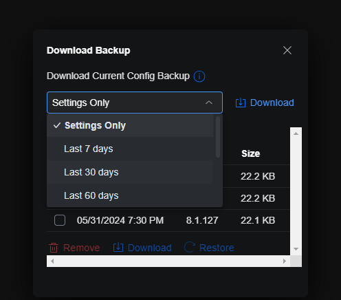

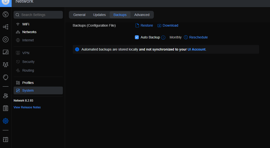

for My backups>
https://192.168.2.4:8443/manage/default/settings/system
Unfi login > Gear bottom left(Settings) > bottom of left list (System) > tabs at top (Backup):
For option Backup (configuration File) Download:
This opens the backup options:
You should choose 30 days to help grab DB data.
This File backed up from the UDM-Pro will restore to the UNIFI network application on docker...
When restoring this backup note the network application and version name you need to match that network version or restore to a newer version of the unifi network application.
As you can see I have earlier backups I can download and restore from...:
if i download it now I will get a backup for version
The version should also cary in the name of the file. it is recommend to keep unifi name scheme...
Note the version in the file name:
So I would need to run unifi network application version 8.2.93 or newer to use the restore function in this docker with out issue.
When runnign this docker see the first post and grab the corect network applicaiotn as a tag # for your docker...
ATM the default template still pulls the older version for users who have not switch to keep stability. Wath your docekr tags
per first post as of writing:
