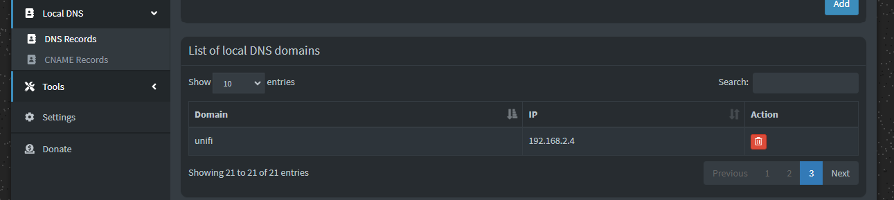

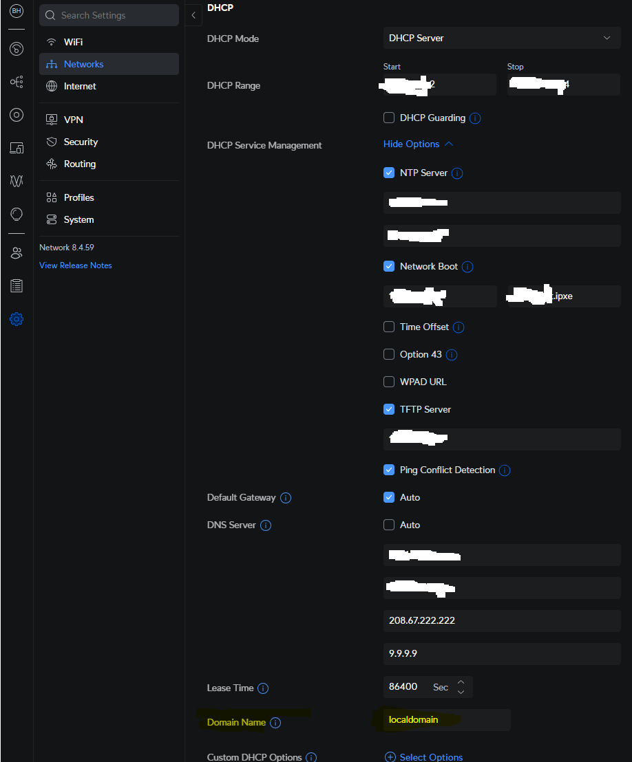

Ubiquity auto uses a dns record for the inform IP address... so, when running a dns server, it is best practice to set a record for the inform IP.  "unifi" if using ubiquity network devices such as switches and routers... For netbios and ntlm networking, compatibility with win 95. It's best to set the domain name to localdomain. (Unfif uses this as default other operating systems and routers may use .lan or .local ...
Since Pihole, Be sure to alos setup a pihole with a local dns record to help direct traffic and point unifi to the x.x.4.100 and add a record for your unifi.[your dhcp advertised domain name]
Example
so a dns record should exist for
unifi
and
example...
unifi.localdomain
unfi.local
unifi.lan

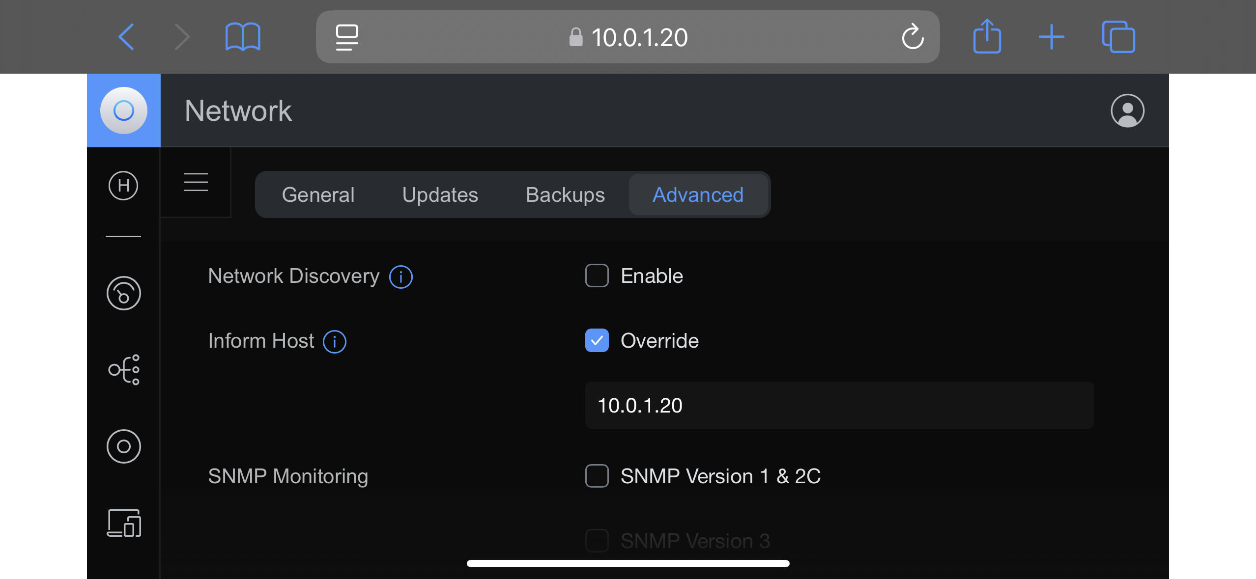

hello,
are there any known issues with wifi 7 pro APs? i have 3 new units and i can't seem to adopt any of them. unifi says adopting for a few minutes, then appears to fail, the AP goes offline for 15 seconds and tries to adopt again. over and over with every unit i tried. no error message is generated
i confirmed that the APs themselves work fine by installing the unifi software on a windows desktop, adopting them and running some tests. it's a new install. no settings or backups carried from another controller. all settings are default
EDIT. turning on “Inform Host Override” solved this. never had to do that before, but that does appear to be the solution. thank you

1 hour ago, solomonshv said:
hello,
thanks
This is commonly caused by “Inform Host Override” not being set in the advanced controller settings. Set it to the IP of the docker.
