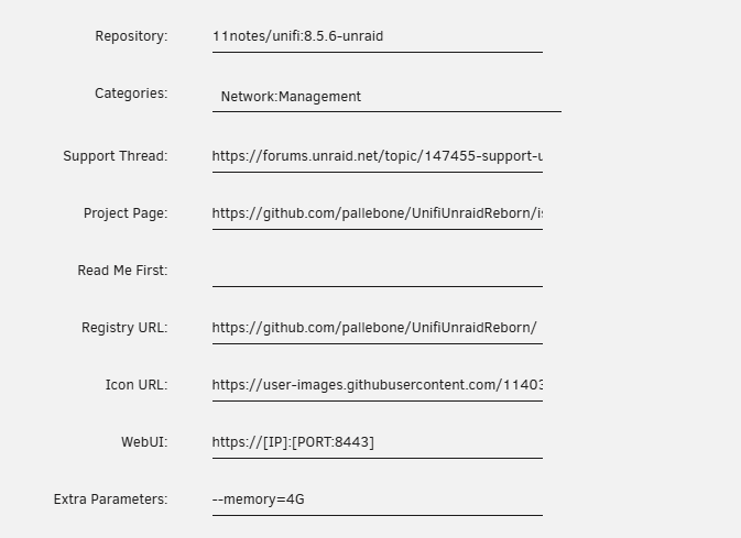

1 hour ago, firedog said:
I'm trying to get this up and running again.  It died at some point and I just gave up on it.  The issue I was receiving was I would get a Error 404 page from the container, and it was marked as unhealthy.  I don't know anything about what makes the container as healthy or unhealthy.  In my experience, I always ran a healthcheck in the extra parameters.  Nothing in the container logs.
I removed the container, and the image and attempted to reinstall.  Now I get a full Site can't be reached, however it is now marked as healthy.  My log only shows:
{"time":"2025-01-05T22:13:51.000Z","type":"INF","msg":"starting unifi (8.5.6)"}
org.tuckey.web.filters.urlrewrite.UrlRewriteFilter INFO: destroy called
{"time":"2025-01-05T22:17:29.000Z","type":"INF","msg":"starting unifi (8.5.6)"}
I did try the original version 7.XX (something, missed it on the first page but it matches the old old).  I then moved the image to the 8.5.6.  Still nothing.
I then also deleted the image, container, and removed the config folder in the appdata.  Still nothing.
I have tried the network on bridge, and on custom with a unique address, nothing.
Accessing 10.0.0.200 (or .201 on custom):8443 gives me nothing.  No errors on the docker logs, no errors on the app build.
Any help?
Thanks!
delete the app data and check resource over head. I hvae seen some of that when momory resource where full or trying to allocate to much.
if you didn't set a appdata path.
delete that folder so the container can recreate new with better permissions...
edit and set the extra parameter to 4G use latest at first start template install.
as of writing Stable: 11notes/unifi:8.5.6-unraid
Regarding the log entry:
org.tuckey.web.filters.urlrewrite Log Entry
What It Means:
This message is related to the UrlRewriteFilter, a Java-based URL rewriting library used by the UniFi Controller to manage incoming requests (e.g., routing REST API calls or serving web pages).
INFO: destroy called:
This means the UrlRewriteFilter is being stopped or destroyed, often during application shutdown or restart.
If this log entry occurs during the controller’s startup sequence, it might indicate an issue where the URL rewrite filter fails to initialize properly.
more a api issue that can be casued with memory issues...
you can add extra parm for health cehcks:
--health-interval=30s --health-timeout=5s --health-retries=3
but I would recomend deleting the appdata folder and rebuildin the container with less ram in the extra parm. this way the api is clear and the docker first run will creat the necessary folders...
Otherwise please post a diag file as i'm failry certain this is a java memory realted issue.

That led me down a bit of a rabbit hole. So I have setup the container to be on the bridge network, which would lead it to have 172.17.0.0/16 as the subnet.
What is the recommended network to run the container on?

I dont actually understand clearly what you have done or what you are trying to do. Did you setup this container from scratch and never get it working or did you try restore a backup or what?
Ate you just trying to use cloud access?
Mine seems to work perfectly and dont even remember setting anything up:
I am using network type bridge. This works perfectly. If your firewall blocks random things make sure there are relevant exceptions for testing.

Must be. Check if you can add logging on all your block rules and then watch the live log as you try it.
On 1/22/2025 at 5:02 AM, tehg said:
Weird! I will blame OPNSense and mess around with it. Maybe bridge mode is making it sad with how my network is setup or something.
In my case, I also did open port 8443 from WAN to my unifi controller. I am running on ETH1 Network type with static IP.
I had this port open while testing various approaches. Closed it, once I got unifi.ui.com working.
This port should be used for UI access only and don't think unifi servers use it for validation.
can you verify your firewall is not blocking outbound traffic for this container?
