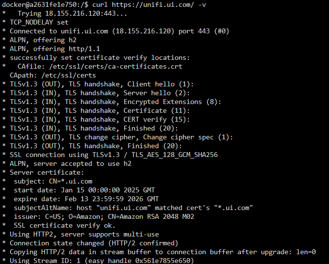

Can you check your docker has internet?
Open the console of the reborn docker and do this:
As requested

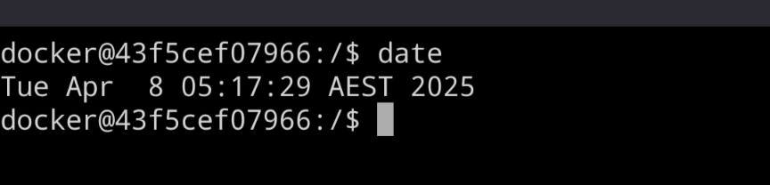

I agree I am running out of ideas here. Is the date correct (type date in the console and check not out more than 5 minutes).

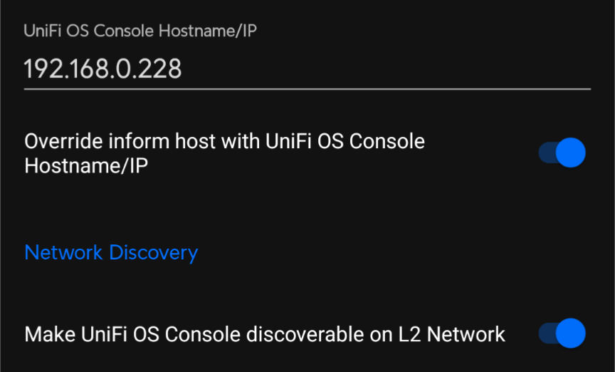

Also check you have this set like in this format:

You mentioned running pihole. Did you set a custom dns host name of unifi to the inform ip and ip of the controller?

I added the custom hostname to the extra parameters field as suggested.
