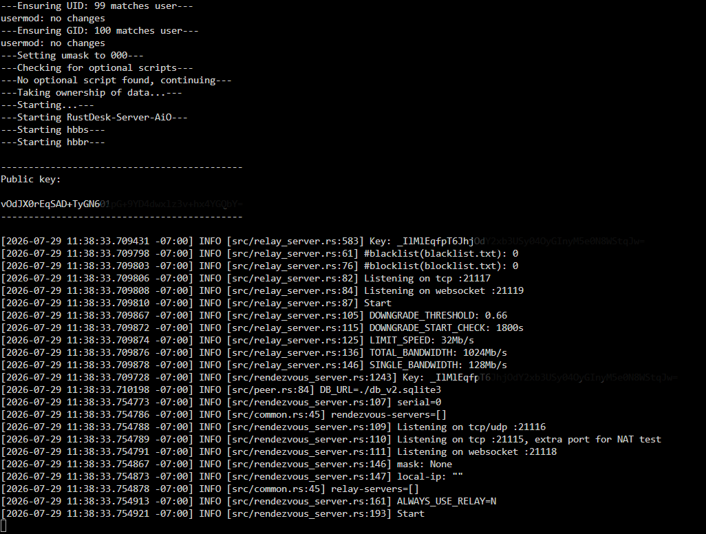

Ok, did some more fooling around and the clients are now visible... but the keys are mismatched. It seems the public key is different than the key I have used previously. Again last part of keys are blacked out.

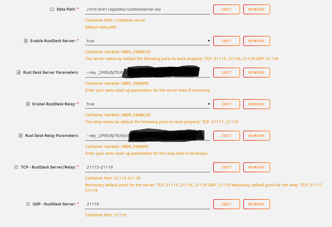

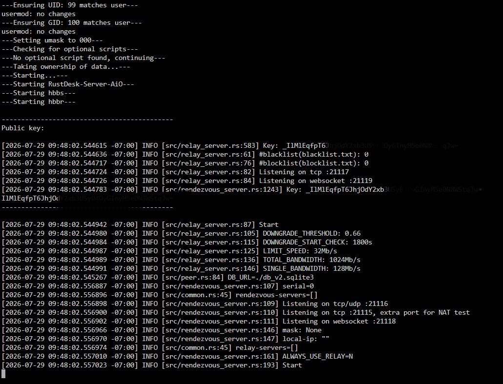

Good day all... I hope this is the right place to post this. I've been using RustDesk-AIO on unraid for a couple of years now, but started getting "not encrypted" errors when connecting to clients, I looked around and most answers were the related to the keys. I tried to reneter them but seem to have screwed thing up more. here is a SS of the log, I've blacked out the ends of the keys listed... I only re-entered the keys on the config page, so hopefully you can help with this. Thanks

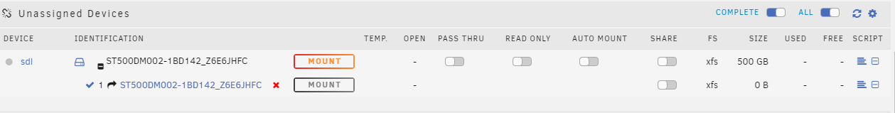

Log states: Jul 26 12:51:49 Tower unassigned.devices: Adding disk '/dev/sdl1'... Jul 26 12:51:49 Tower unassigned.devices: Mount drive command: /sbin/mount -t xfs -o rw,noatime,nodiratime '/dev/sdl1' '/mnt/disks/ST500DM002-1BD142_Z6E6JHFC' Jul 26 12:51:49 Tower kernel: XFS (sdl1): Filesystem has duplicate UUID af97fc56-3528-4125-b30b-215ec979551b - can't mount Jul 26 12:51:49 Tower unassigned.devices: Mount of '/dev/sdl1' failed. Error message: mount: /mnt/disks/ST500DM002-1BD142_Z6E6JHFC: wrong fs type, bad option, bad superblock on /dev/sdl1, missing codepage or helper program, or other error. I'm guessing it's the duplicate UUID? Can I clear that and see the files that were on it? If so, how do I clear it safely? I just need to copy the files off the old disk to the array.
Hi, New to this topic and not sure what I need to do to post my problem. I have been upgrading my unraid machine and swapped out smaller drives to larger ones. At sometime during the swapping I have lost files, entire directory's. I connected one of the old replaced drives and it shows in UD but will not let me mount it.
