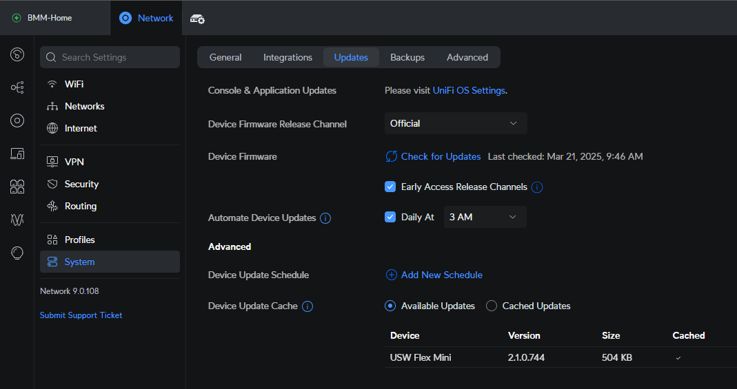

You can manual follow unifi device software and firmware release here:
https://community.ui.com/RELEASES

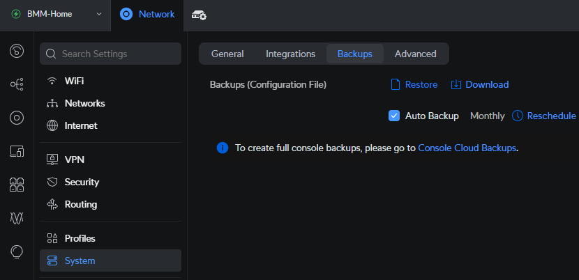

Once your SSO setup the network control docker. Restore the NETWORK BACKUP ONLY!
so on teh cloud key you need to make a backup outlined here:
you may need to restart and reinstall the docker image.

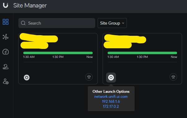

To rephrase, in https://unifi.ui.com/ the site IP is now wrong.
The IP there, 192.168.1.6 is from my old Cloudkey, not 192.168.1.245 which is my Unraid server. The status of the site is connected, it sees it but has the wrong local IP. The one on the left is the one that has been there and the one on the right is from adding the site again last night. I can't find a setting to update the 192.168.1.6 address to 192.168.1.245 so that unifi.ui.com picks up the correct setting.
Regarding the migration, I did it about a year ago. I can't remember if this has been broken the whole time or just a long time. It was a lower priority and I'm just now getting around to it. Yes I'm running the containers in bridge mode rather than a dedicated IP. I thought at one point that was recommended for this container but I haven't double checked that. The Cloudkey was down before I brought up the container as suggested. The old "site" for the Cloudkey was still in unifi.ui.com and showing as disconnected until I deleted it recently so the container didn't fully take over the identity of the Cloudkey site, unifi.ui.com saw them as separate and knew the Cloudkey was down but could tell that the container was up. From my notes when I did the migration, here are the steps I followed and my reference.
Actual migration between controller steps
I did recently have to re-poke my Unifi Gateway with the correct inform address to get it adopted again. The container has recently been upgraded to 9.0.108-unraid
As I said, it seems, I need to update a setting somewhere in the config to have the new local IP address so that when I add the site to unifi.ui.com it picks up the unraid server/container address. Hopefully that clears things up as far as what happened and what setting I'm trying to adjust. Thanks.

My question is regardless of what is displayed when you connect to that, does it connect to the cloud key? or does it connect to the controller.
as I've heard of unifi not having a correct display, but that is ubiquity/unifi side, not the controller's side.
As you did a restore. I'm not surprised if the ip changed in the controller and the api key that connects to unifi is displaying wrong.
If its connecting to the cloud key there's your answer... its not the controller...
If its the controller, then its unfi api side and you are better off starting over then trying to dig into a docker over files and configs...
I would recommend reaching out on unifi support forum and contacting them is this is not the dockers fault or issues. This is entirely on how unifi and there api function for remote access via unif account and SSO.
