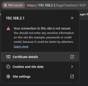

The reason I mentioned lets encrypt as you will need to re-use and inform unifi to use the certs if you try to reuse the old certs / keys:
https://community.ui.com/questions/Unifi-Migration-Best-Practices-related-to-Portal-and-SSL/c8b93a8b-8e5f-441c-a868-2cc2067b1ea6
Can it be done yes, but its easeier and better to resign new certs...
As I believe, you are trying to suppress cert warning such as theses:
on chrome going to the top:
you can export the cert the new docker is using..
with the export you can import the cert into pfsense to re-register the website.
review:
https://www.ssldragon.com/how-to/install-ssl-certificate/pfsense/
This May also be of some assistance:

6 hours ago, PeteAsking said:
@beanmeister you realise you can just import a certificate to a machine right?
Yes I did know you can import a certificate to a client browser.  What I did not realize was that the Unifi controller, by default, comes with a certificate to allow you to just import and trust it.  At least that is my understanding from your response.
I just remember when the Unifi controller stopped supporting regular http, there were instructions for using LetsEncrypt which was more hassle then just issuing my own using pfSense.  So I got the impression that I needed to configure the controller with a certificate to access the new https admin page.
Anyway, I will give your import suggestion a try when I install the reborn docker, after migrating all my drives off reiserfs (yes, another long over due task that I have procrastinated from doing).
Edited by beanmeister
Again, thank you @bmartino1 for all the links.  I do believe from all your links, I will figure out the commands to get the Unifi controller to use my own certificates.  I think the trick is to run those commands within the docker container since the Unifi controller is running inside the docker container.  I can attest that the configuration backup file does not contain certificates information.  I will definitely have to set up the Unifi reborn controller docker container with my certificates again.  Kind of like moving the controller from one server machine to another.
If I can't get it to work, then I will just fallback to importing the default certificate that comes with the Unifi controller like @PeteAsking suggested.
Hmm..
Yes thats right, if it didnt used to come long ago with one, it was probably before my time.
Good luck which ever direction you choose to go. Good luck with the reiserfs move.
Just ask again if you are still stuck somewhere with something.
Yoo hoo!  I am now reborn and running my own certificate!   I just had to copy over my P12 certificate file and run the keytool command within the docker container to import it into the keystore.  Thanks for the help everyone.

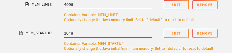

Hi All, Just recently started to use this unifi controller. Since it uses so many common ports on my unraid, I thought I'd try to create an extra ip on my unraid br0 to run the controller from. It worked great, but has recently stopped working. The UI isn't responding. we had a power outage that briefly impacted the access points but not the controller server.
The only error in the log:
Exception in thread "Thread-37" com.ui.analytics.ooOOOOOOOOOOOOOOOOOOOOOOOOOOOOOOOOOOOOOOOOOOOOOOOOOOOOOOOOOOOOOOOOOOOOOOOOOOOOOOOOOOOOOOOOOOOOOOOOOOOOOOOOOOOOOOOOOOOOOOOOOOOOOOOOOOOOOOOOOOOOOOOOOOOOOOOOOOOOOOOOOOOOOOOOOOOOOOOOOOOOOOOOOOOOOOOOOOOOOOOOOOOOOOOOOOOOOOOOOOOOOOOOOOOOOOOOOOOOOOOOOOOOOOOOOOOOOO.C.OoOO: Failed to send crash reports or parse response
did you edit or change the memory limits for the unifi docker. this is a java error OOM and a Thread memory leak...
note teh extra parm
should not go lower then 4G
this application requires a min of 4 GB of ram...
and did you change:
as these are already at the min...
reading the error more there seems to be a issue with your docker network and network communication:
Caused by: java.net.SocketTimeoutException: Connect timed out

I have the Extra Param as 8G and the other mem settings at their default. I have alot of ram so I'm happy to increase it if you think that will help. when I start the container, there is a brief moment it will show the login in the webui before it crashes, so I think the networking is alright. It isn't using any VPN. I do use Adguard home for DNS resolution and block all attempts to talk to DNS servers on the internet. but that hasn't changed since it was working so I'm unsure.
It sounds maybe like something corrupted somehow but I cant explain why. Are there any backups at all?
If you dont take manual backups there might be some under appdata/unifi-controller-reborn/backup/autobackup
can you check?
