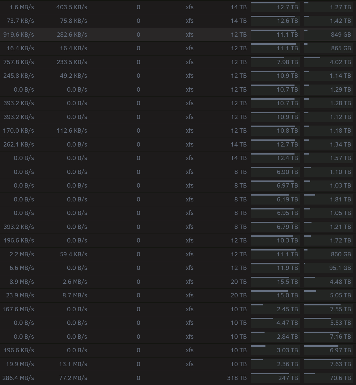

  4. Use case is simply drives get full and I am trying to let this tool move stuff to more recently added drives to spread the "load" out across more empty drives. Many of the media sets/folders I have run 1-2TB (ripped bluray) in size but generally individual files would be 10GB or less. I run unraid because I like whole files per disk instead of striped so they can be easily recovered/moved/etc without rebuilding a raid array, but I have no need for the whole media set to be on a single drive since media should be interacted with via shares/logical structure not via direct disk. I think performance is likely better if files are actually stored on multiple drives wouldn't it? I think that is what I had in mind for a largest first sorting order, take the largest folders and spread them out more evenly. I'm not sure why it would be important to keep all files for a show on a single disk, but of course I understand many have different priorities and I'm just not familiar with that use case. Image attached of my current drive status for example. I just noticed when I have a drive with say 500GB free the plugin (set to 1TB free goal) would go to work on the largest folder which might be 1TB and it will just toil away on that for 2 days trying to move the entire 1TB folder to a new disk so when it is complete that source drive now has 1.5TB free. That's fine to have extra free space, just wanted to make sure that what I was seeing is expected. My server is highly utilized for many things and my disks never idle so I care a lot more about performance than power savings. All of my shared run high water allocation and automatically split any level directory. Most of my array storage is for ripping bluray, then I use tools to mux those to mkv to watch via plex, for TV shows I usually up reencoding to AV1 because the production quality just doesn't justify the huge storage, so there is a lot going on. Primarily I just wanted to make sure I was understanding how the script is supposed to work and that it matches what I was seeing. I am not expecting you to change its functionality to fit only my use case, it seems I might be the minority anyway, but I wanted to share how I use my server and your tool since you asked. In any case, again thank you for the tool, it is greatly helpful already!

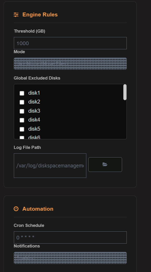

  14. Ignore the grump, the new UI is fantastic! I do have 1 issue with the UI though, my drop down items show weird as pictured. Also, how do I stop a running job?
