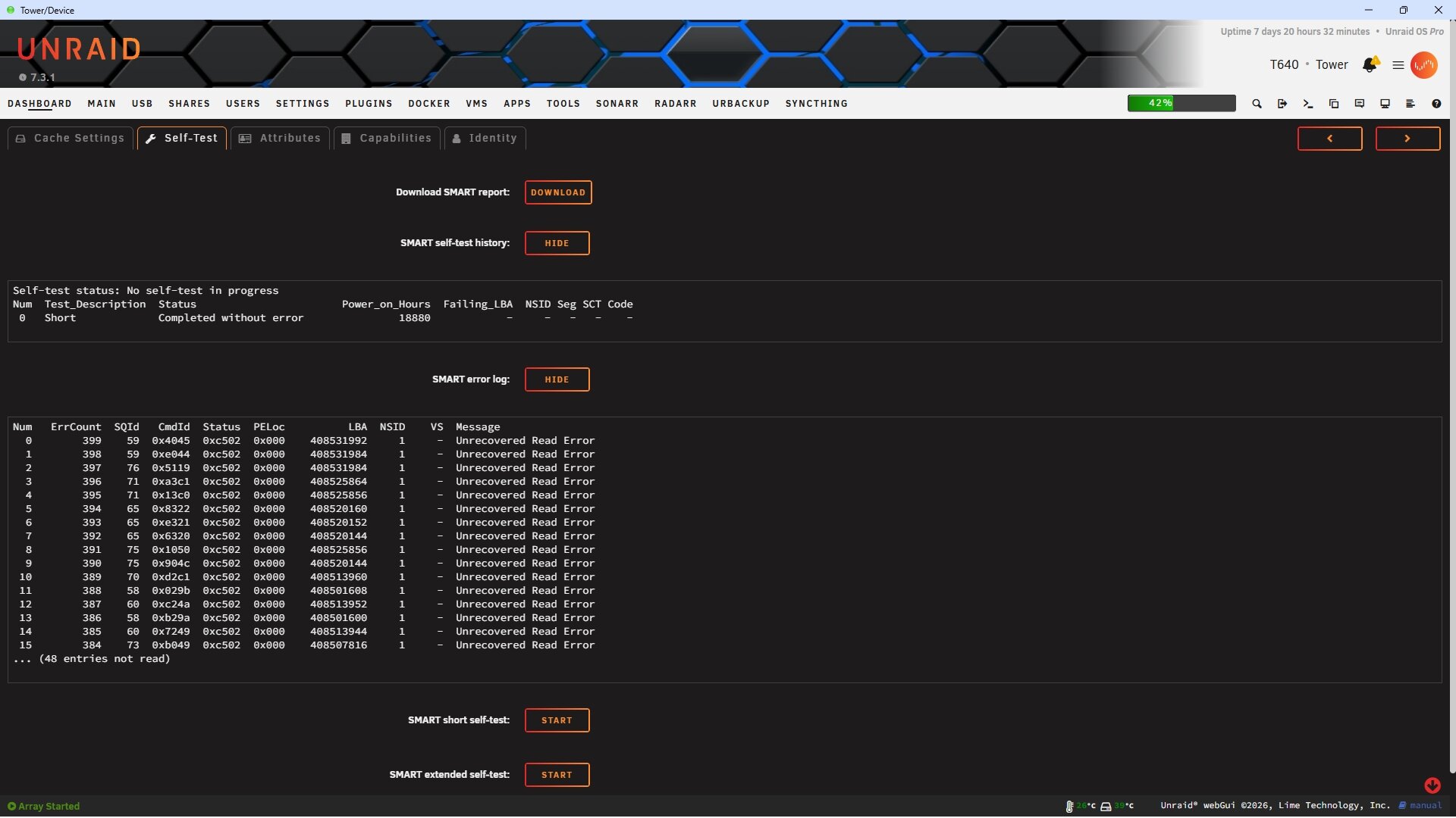

Awesome, thanks. It appears that I may need to do that. See below... Good to know, thanks! I ran the long SMART test and it reported "Completed: failed segments". The report is attached. It seems there are quite a few "Unrecovered Read Error" entries. I probably need to initiate a warranty replacement with Samsung. Bugger. tower-smart-20260606-1955.zip

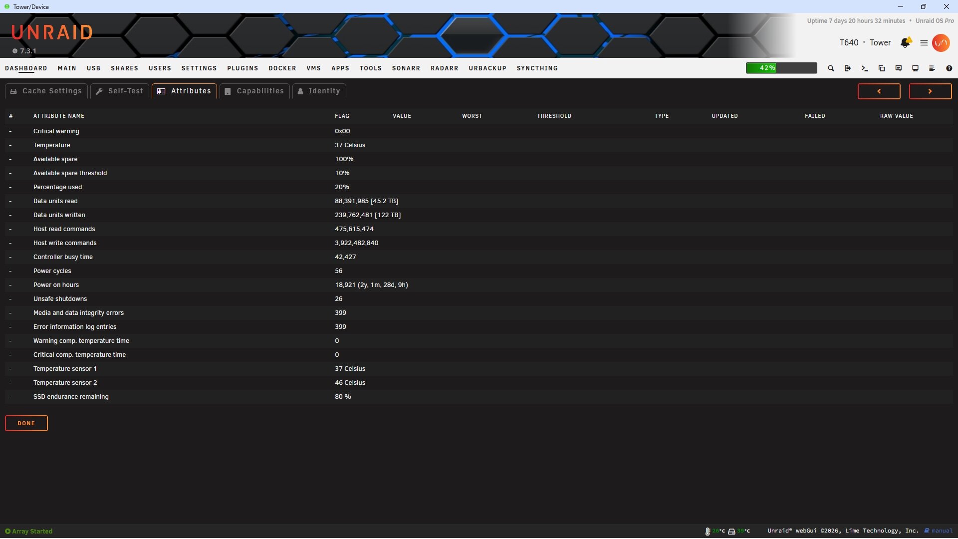

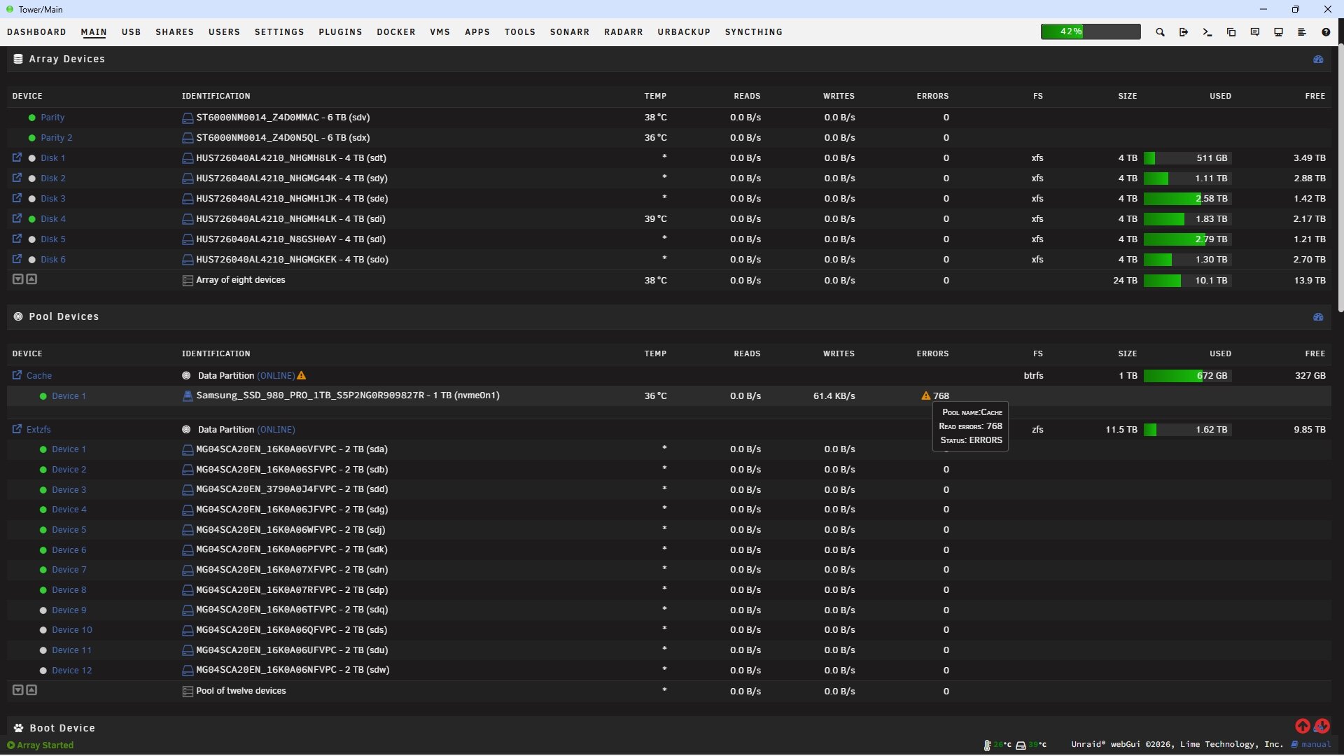

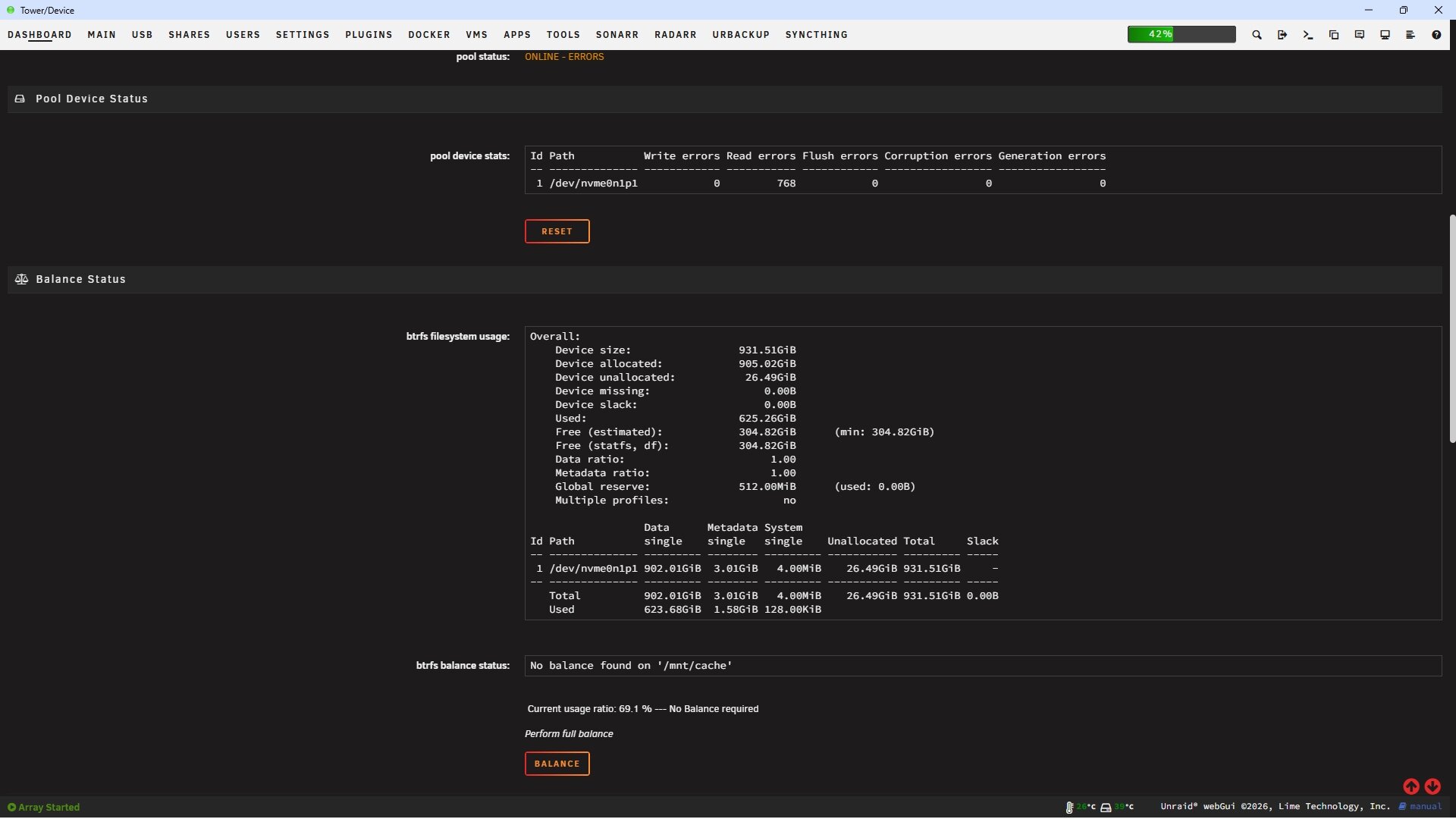

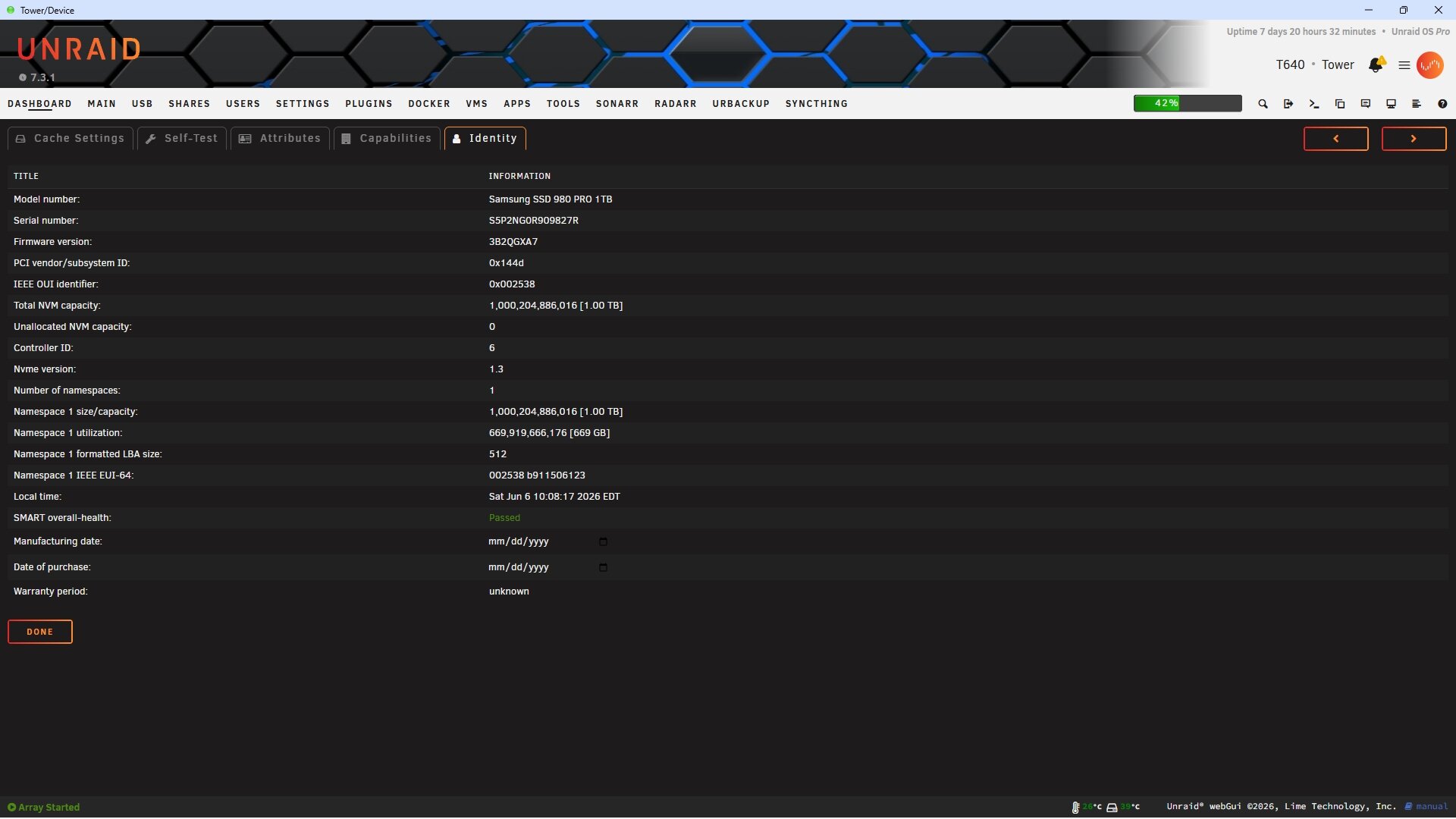

Recently, my cache drive has begun to report errors. I thought perhaps the NVMe drive was beginning to fail (Samsung 980 Pro 1TB), but it passes self tests. I don't want to start a warranty claim process if it's not the drive. Any way to find out what's happening? The error messages aren't very helpful, at least not to me. See attached screenshots. EDIT: SMART report added also. EDIT2: added obligatory diagnostics. ;) EDIT3/Resolution: it was the drive. Samsung replaced it under warranty. tower-smart-20260606-1008.zip tower-diagnostics-20260606-1025.zip
