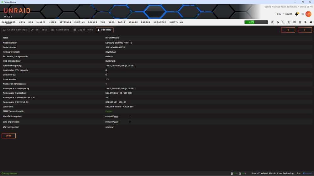

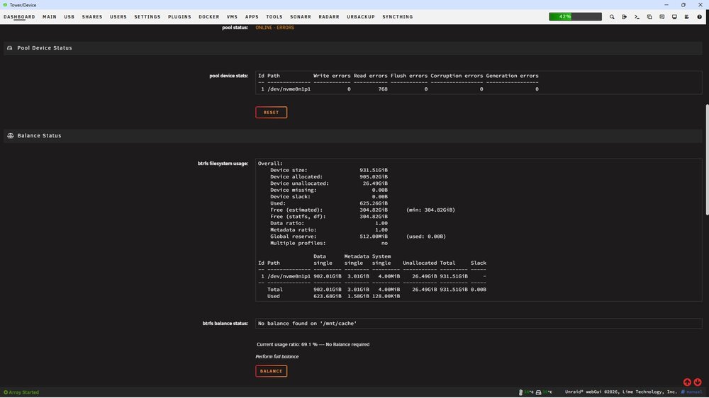

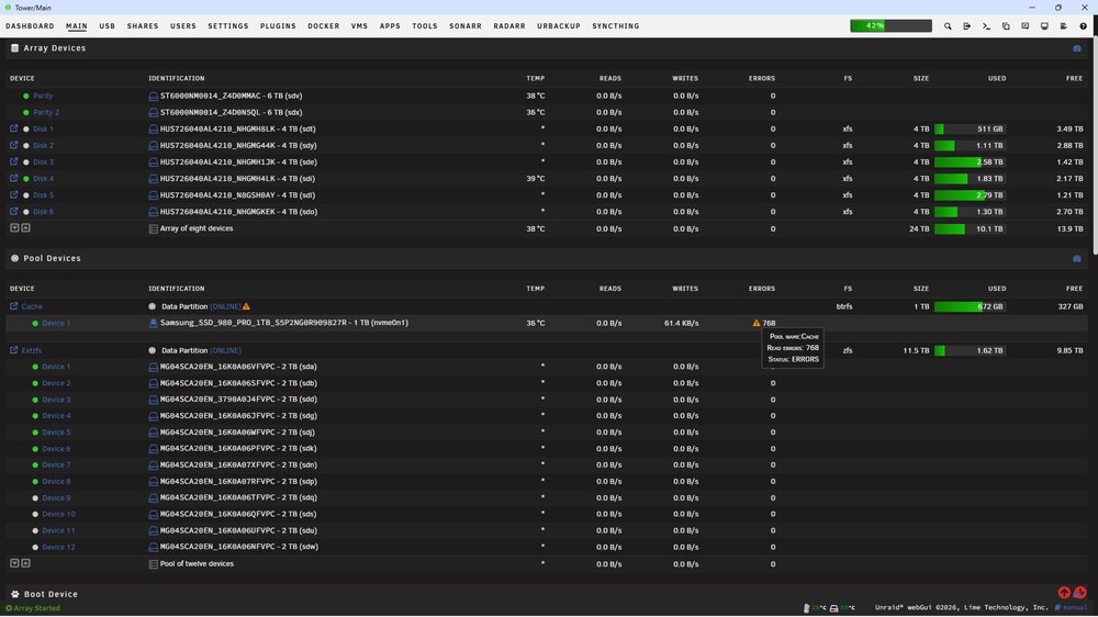

Recently, my cache drive has begun to report errors. I thought perhaps the NVMe drive was beginning to fail (Samsung 980 Pro 1TB), but it passes self tests.
I don't want to start a warranty claim process if it's not the drive. Any way to find out what's happening? The error messages aren't very helpful, at least not to me.
See attached screenshots.

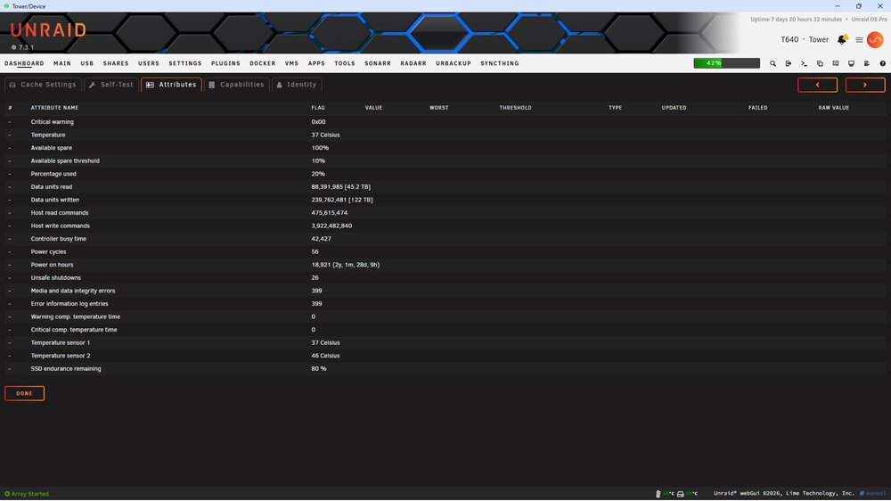

EDIT: SMART report added also.
EDIT2: added obligatory diagnostics. ;)
EDIT3/Resolution: it was the drive. Samsung replaced it under warranty.

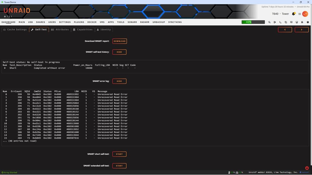

Your drive is failing. The self-test passing doesn't mean it's healthy – it only checks if the drive responds, not whether all sectors are readable.
Look at the SMART error log: 399+ Unrecovered Read Errors, all pointing to the same LBA range. That's permanent bad sectors. Back up your data now, this can fail completely without any further warning.

The Unraid 7.3 correlation is interesting and worth keeping an eye on. But Unrecovered Read Errors in the SMART log are written by the drive itself, not by Unraid. Software can't generate those entries.

It is worth pointing out that if you want to use a self-test on a drive then only the extended self-test is really indicative of health. The short test is primarily about testing the electronics - only a small number of sectors are tested.

Good to know, thanks! I ran the long SMART test and it reported "Completed: failed segments". The report is attached.
It seems there are quite a few "Unrecovered Read Error" entries.
I probably need to initiate a warranty replacement with Samsung. Bugger.
That means the test failed, and the device should be replaced.
