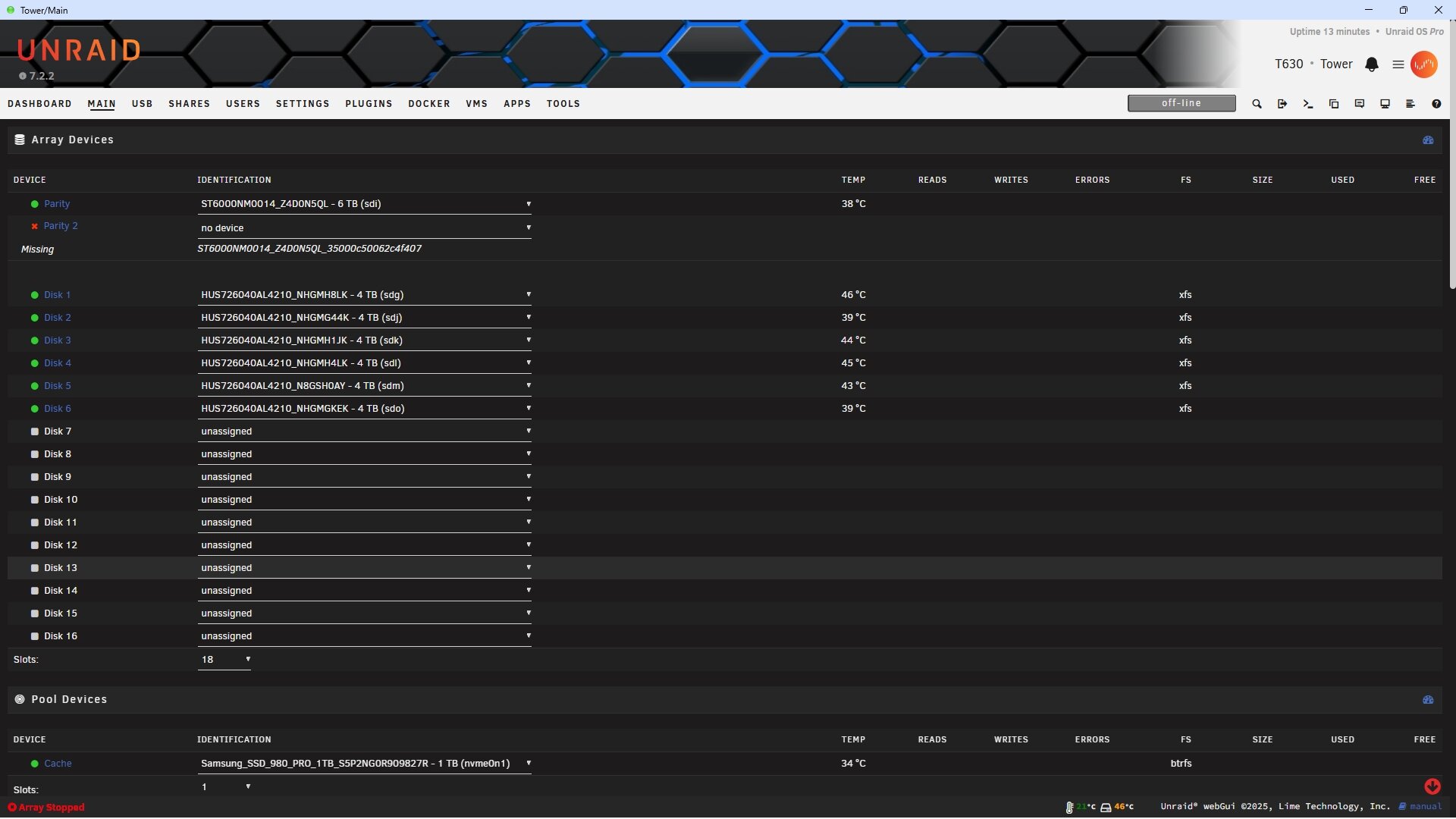

  3. Any of what you mentioned is possible, I guess. That worries me that you're seeing flash drive repairs. :/ I certainly didn't do anything manually, it must have been some sort of auto repair. What did you see about the RAID controller that made you suspicious of it? Just the fact that it is present? It should be in HBA/IT mode, and only passing the drive data through to the OS. I'm not using any of the actual RAID features, unless I did something wrong. ;) I'm not 100% sure of the drive assignments, more like 85-90%. What happens if I do the new config thing, and I get it wrong? Will it corrupt my array data, or will I just maybe have to rebuild the parity from scratch?

  5. I assume you mean is it going bad? I don't think so, but I really wouldn't know how to check. All drives are showing as physically online, by which I mean that the lights on the front of the chassis are indicating that each drive is connected and online. Also, the error appears to be something specific to unRAID, just from the message it's showing me on the [main] screen. I mean, why does it show that the Parity drive is xxx5QL, but then it says that drive 5QL is 'missing'? I thought maybe that drive got assigned to the wrong parity slot somehow, so I moved 5QL to Parity 2, and assigned drive xxxMAC (the one that I'm fairly sure was one of the parity drives before all this happened) to Parity. Now it says that Parity is "wrong" and is looking for 5QL, even thought that drive is in the Parity 2 slot. (see new screenshots for clearer explanation). I tried flipping the order around, and it doesn't like that either. I'm fairly sure that the correct assignment should be drive MAC (sdh) in the Parity slot, and drive 5QL (sdi) in the Parity 2 slot, but it says these are wrong. At this point, can I just pick and arrangement and go with it? I know I'll have to let it rebuild the parity, again, but I just need this server back up and running ASAP. I did not apply any of these changes, by the way.

  7. So I recently migrated my server to new hardware. Everything appeared to be up and running well. I had expanded my parity from 2x 4TB drives to 2x 6TB drives, and the rebuild was complete. Today, I decided to complete the last step of the migration, by moving the GPU from my old server to the new one. I shut down the new server, swapped over the card, and booted it back up. No other hardware or software changes were made. Everything came back up fine, except that the array didn't start. (?!) I looked at the [Main] tab, and it says... well, see the screenshots, please. I don't understand. The drive it says is "missing" is the one that's listed right there as "parity". Parity 2, which is currently empty, was previously another 6TB drive of the same model, which is now listed down under unassigned devices, although I have no way of knowing which one it was, since I have several of those drives. I was still sorted out how to handle the expansion of the array, so they were just hanging out in reserve. 1) Why would it just drop a parity drive like that? 2) How can I determine which drive was Parity 2? 3) Can I just add it back in at the top? 4) How can I prevent this from happening again? EDIT: From looking through the logs, I'm fairly sure that (sdh) is/was Parity 2, since it's the only one that isn't flagged as 'pre-cleared'. I had run pre-clearing on the other drives to get them ready to add or swap in later. EDIT 2: This makes no sense. Am I seeing that it's expecting both Parity and Parity 2 to be drive S/N ...DON5QL? That's not possible, right? Has something gone glitched here?

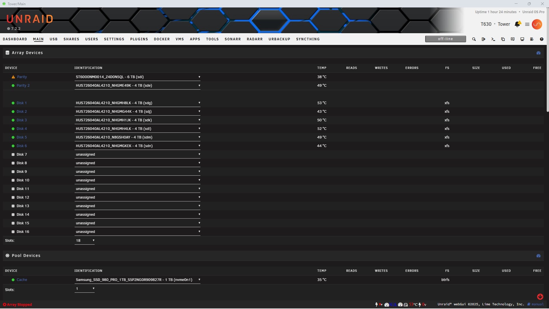

  18. The suspense is killing me... lol
  19. Does this help?

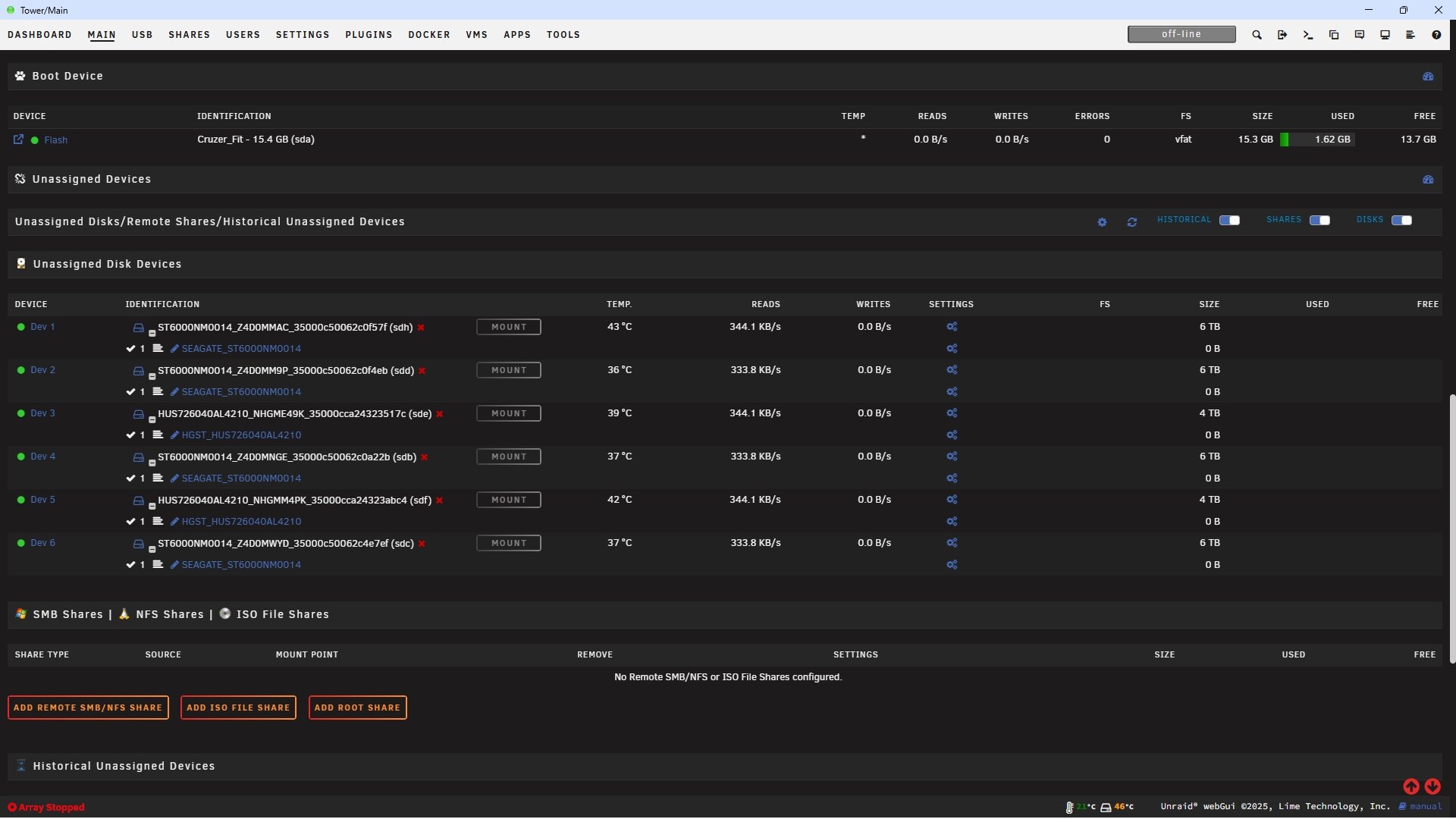

  20. Ok...the parity rebuild is stopped. So I'm getting confused again. At this point, my best option is to replace both parity drives with 2 of the new 6TB disks, correct? Do I need to let that fully rebuild a new parity set before I move on to adding any of the 6TB drives to the array, or can I do that now? I don't know what you mean by adding them to new slots, or how that's different than adding them to the array, or how either of those processes differ from replacing a 4TB disk with a 6TB disk. It's all becoming a blurr...

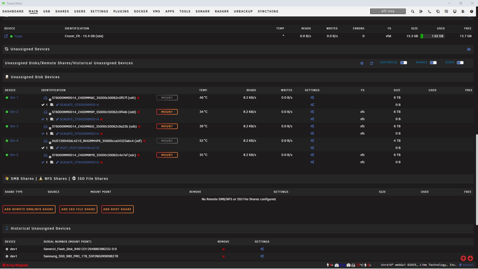

  21. In any case, do I need to stop this parity rebuild and replace the other parity disk, so it can build once? Also, can I add the new array disks at the same time?

  23. That would have been useful info for me to have processed earlier. Note that I said processed, and not necessarily seen. lol They do, but you want to hear something really stupid? I didn't have a way of labeling the drives, and wasn't expecting to move them, so now I don't know which ones are parity and which ones are data. 🤦‍♂️ I'll basically have to treat them as blank drives, and copy everything over again, once the array is rebuilt. At least it'll be internally, rather than over the network, which hopefully will be quicker.
