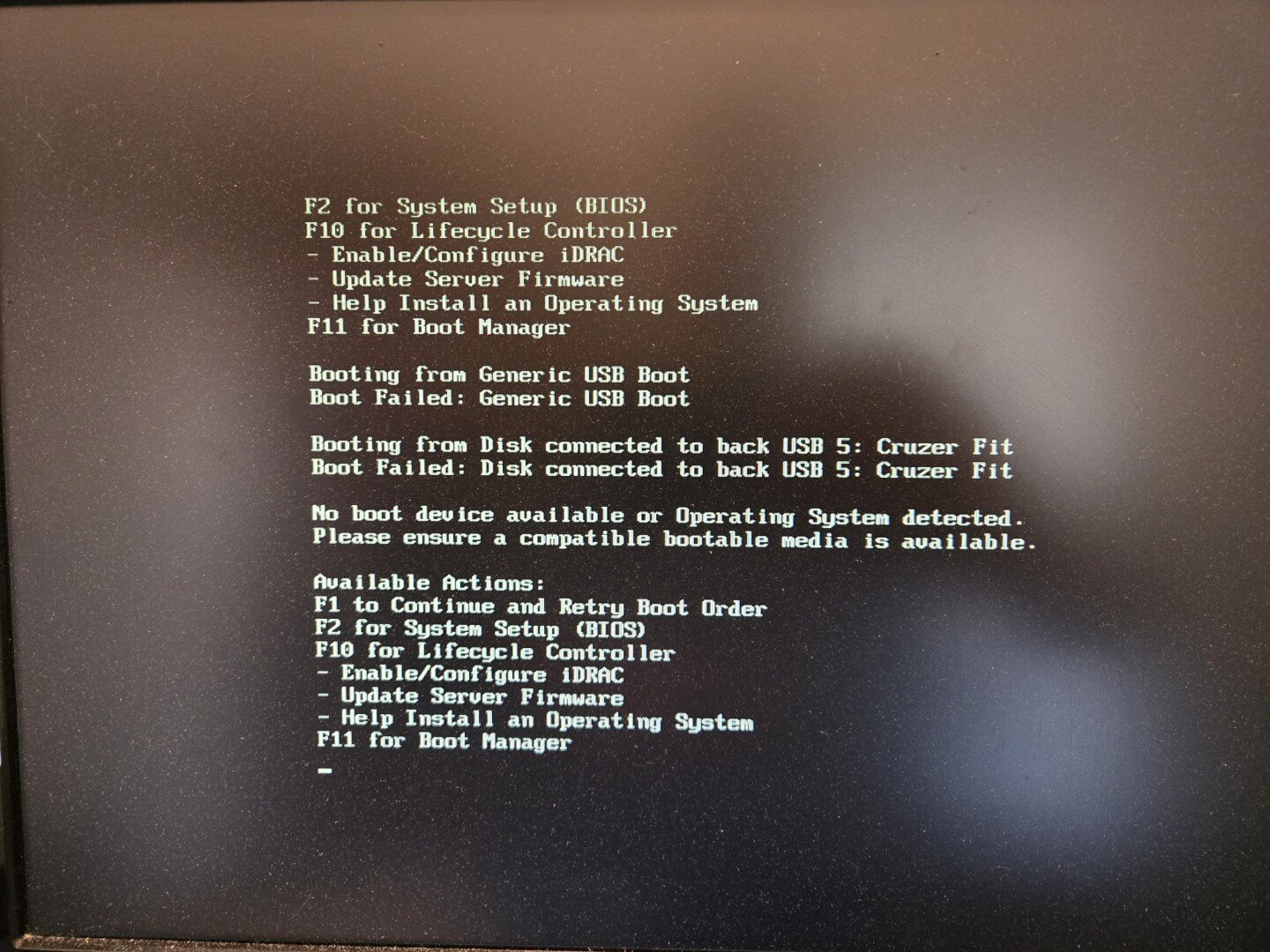

So I'm migrating from a Dell T630 to a T640.
I've swapped my hardware, and the flash drive from the T630 to the T640.
When I boot the T640, I get the image below.
I think the machine is trying to boot from the USB, or at least it says it is, but it says there's no OS detected.
What step did I miss?

Try another port
Also make sure flash drive will still boot original server

Try another port
Booting with flash drive in other ports (tried 2) makes no difference, it still fails with the same error.
I swapped the flash back to the old server, and it booted to the GUI/Launch screen. I stopped it there, since none of the other hardware was present.
What else can I try? The new server (T640) is set to UEFI boot, is that correct? I can't recall what the old one is set to, and it's a major hassle to check.
Try creating a new flash drive with the USB tool and see if it boots, you can use a stock install without a key just for testing.

I know it boots with a different flash drive, because I was running a trial on it (the new server) previously, until I decided to just swap everything over from the old one and go that route.
EDIT: Confirmed. I just put the "testing" flash drive (trial license) back into the new server, and it boots fine. There's something about the config of the flash drive from the old server that isn't playing nice on the new server. This isn't supposed to be a thing, since unRAID claims to be 'hardware agnostic', and says it will run on almost anything. Now, the first time I try to do a (seemingly) simple migration, it crashes and burns. :/

I sort of fixed it. I changed the boot type on the new server from UEFI to BIOS, and now the system boots normally into unRAID.
This seems to be what it wanted, so I'm not complaining. :) I asked that earlier, but I guess no one saw it.

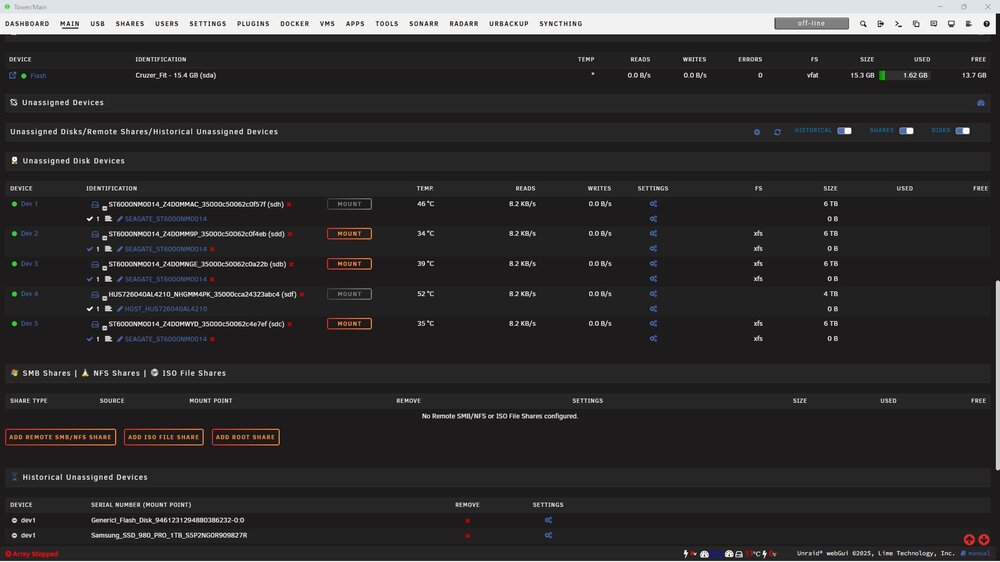

I have the old array available, and a bunch of new, larger disks that show up as unassigned. I was planning to replace the old drives with these newer ones, but my plan of moving all the data to the new drives (already done), then using them to build a new array on the old config isn't working. At this point, if I can just add the new disks to the existing array, and wipe all that redundant data, I'll be happy.
Any suggestions on the best way to do that? I have an option to [mount] 4 of the 5 new drives, but one is grayed out for some reason. Is that indicating a problem with that drive?

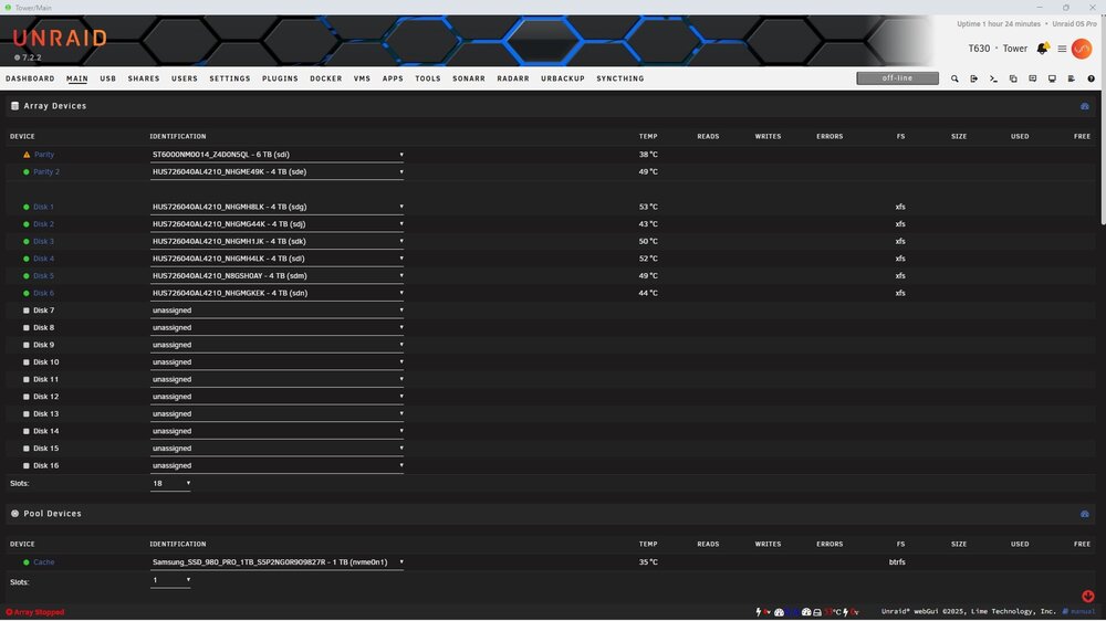

So I found the documentation for adding drives to an existing array.
It says that my parity disk(s) must be equal or larger than my largest data disk. Does that mean I need to use my larger disks as parity? Can I have mixed-size parity disks? For example, right now I have 2x 4TB parity drives. Can I add 1x 6TB drive, or do all the parity disks need to be the same size?

Do you think that reset is a better approach than just doing a parity swap to one of the larger drives, then after that finishes its rebuild, adding the new larger drives to the array?

I don't see how parity swap comes into this at all. You would just replace parity with a larger disk and rebuild it

The current (old) array is 6x4TB data drives + 2x4TB parity. The contents is...everything. lol It's media, work projects, photos, containers, etc...
The new array was planned to be 4x6TB data drives + 2x 6TB parity.
At the moment, I've dropped 1 of the 6TB drives into parity slot 1, and it's rebuilding. When that is done, I'll add the other 5x 6TB drives to the array. That will result in... a mess. lol
