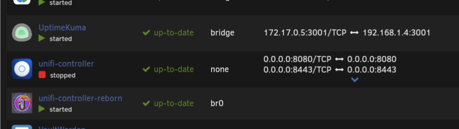

Ok that worked! when i click webui it shows blocked? but when I type it in manually it works! thank you very odd -
[Support] - Unifi-Controller: Unifi. Unraid. Reborn.
ssjucrono replied to PeteAsking's topic in Docker Containers
I agree something might be wrong with my network setup on unraid but not sure where to even start looking. I did type an IP in the template Also My old unifi controller works fine still so that seems confusing -

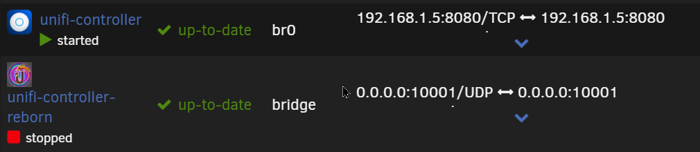

I have not done the set inform. I will try that. I did the set inform host but when I use custom:bro it shows up like this and I cannot access the webui -
rebooting hard rebooting my switch and AP didn't work. I also tried the custom:br0 with the IP I was using prior and the container doesn't seem to work like that? -

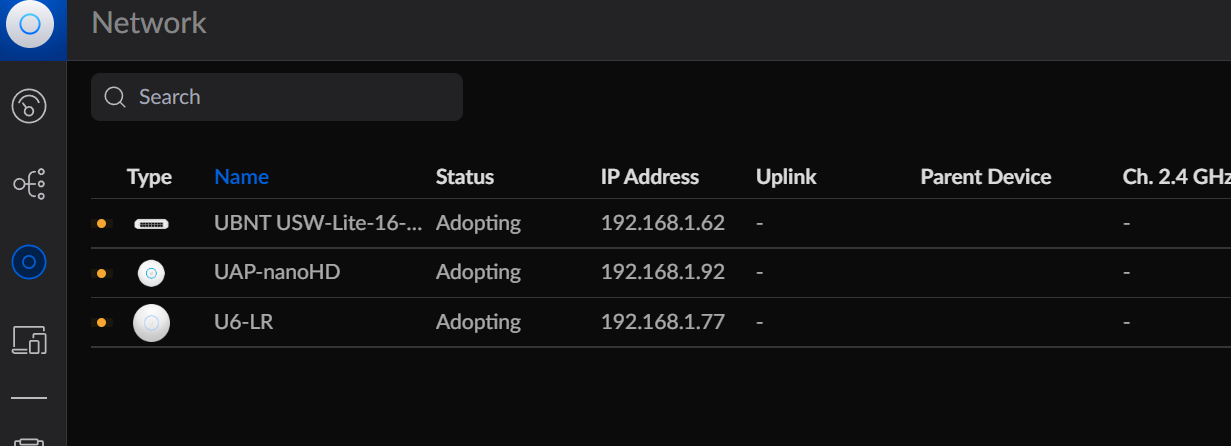

hmm I also did the restore and it seemed to work. Maybe I need to start over again. yeah deleted everything and the appdata folder and restored from backup and still just spinning adopting does it matter it has a docker IP in the GUI? -
now I am wondering how long it takes to adopt my unifi devices? IT just keeps trying over and over? sorry for all the newbie questions. -
