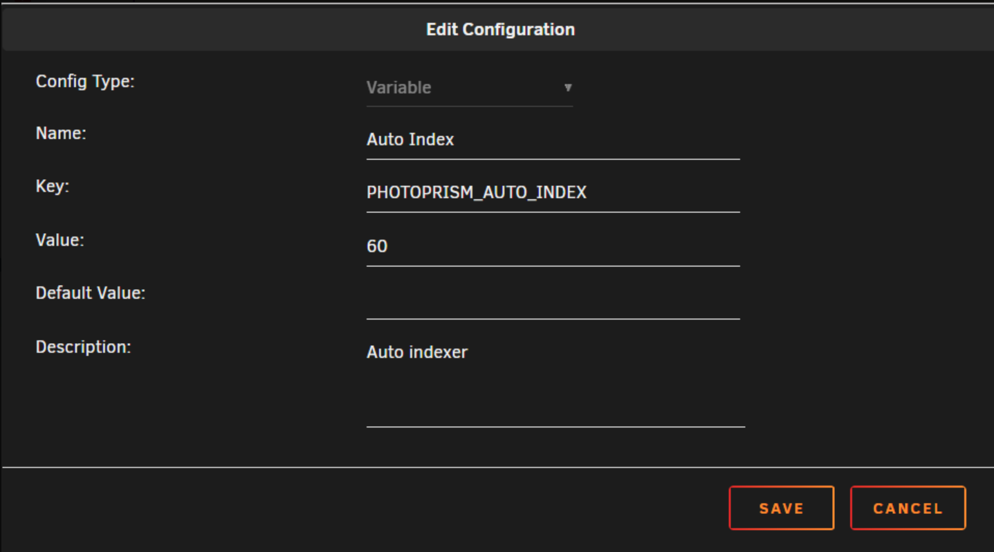

And how can i setup auto index?
This dosent work.
Any good ideas? :)

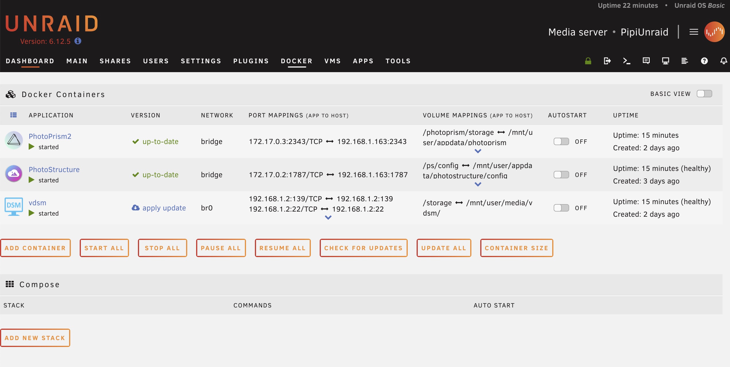

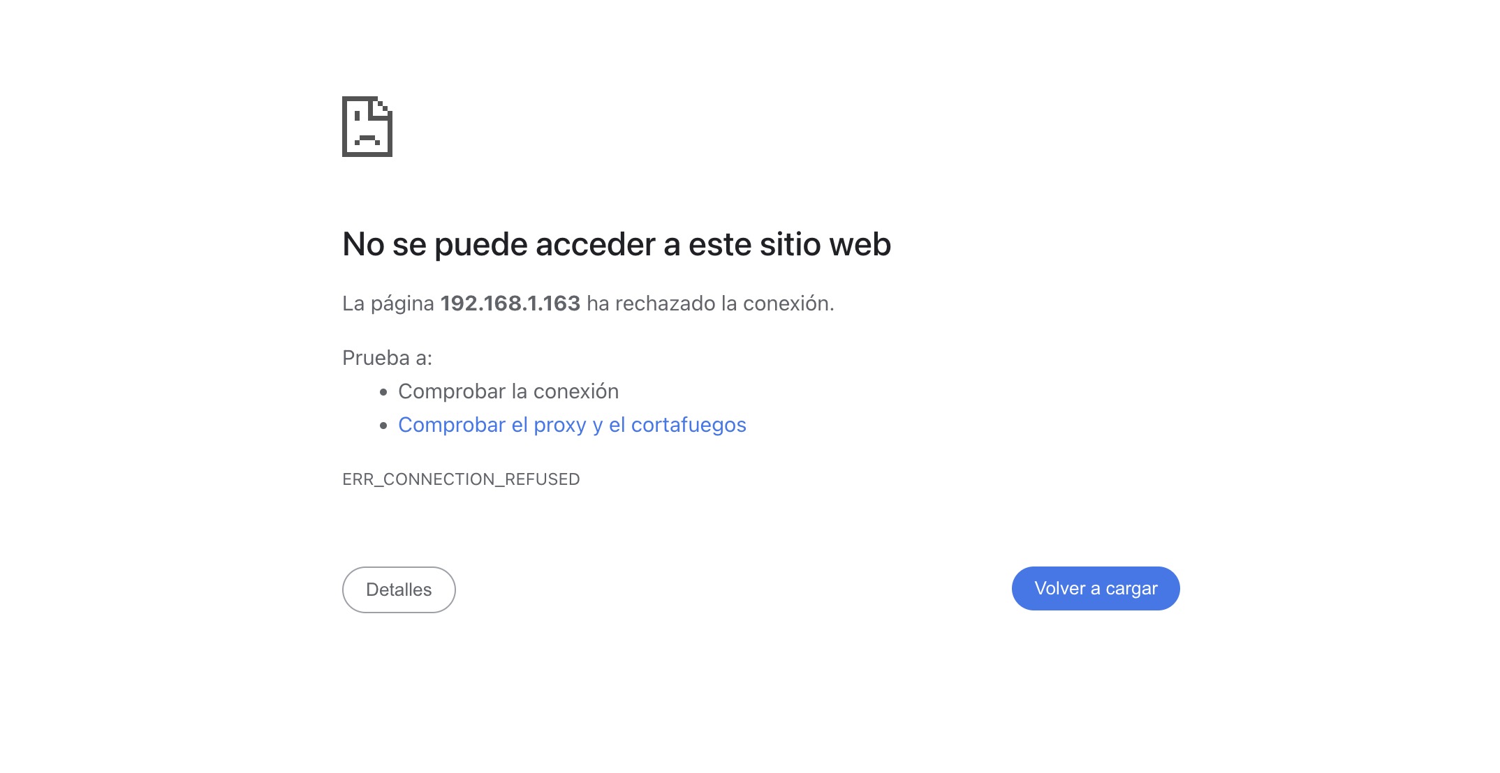

I've installed the PhotoPrism container and everything seemed fine, but when I try to access the WebUI I get the "Unable to connect" message in the browser (screenshot attached).
I've got other containers running such as Photostructure, and that one lets me access it and works fine, so it seems there's no firewall issue here.
I attach the log from Unraid, can someone tell me what's wrong?
log-photoprism-unraid.txt
You cut out the URL you've been trying to reach, but you probably forgot to add the port number (192.168.1.163:2343).
Sorry about that. No, I didn't forget the port, and I've checked that it wasn't being used elsewhere.
I had to use "Host" to get it working. Dont know why?
That works! Thank you @DanielPT If anybody over here knows why "Host" works and "Bridge" doesn't, please let us know, we're curious! ;)

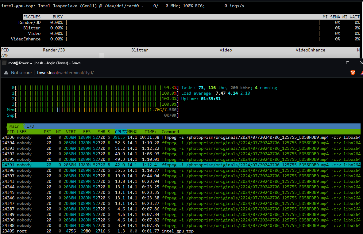

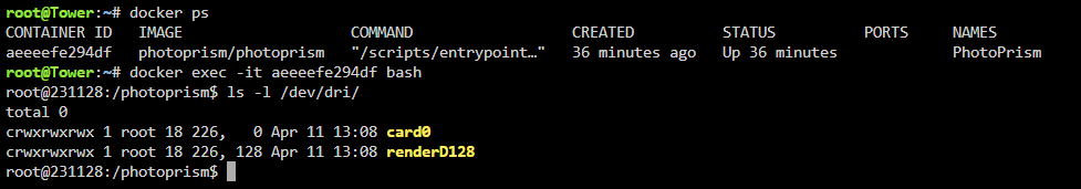

I am trying to enable "Video transcoding" using "Intel Quick Sync" but can't get it working.
What I've done so far:
1) Verify that my hardware support Intel Quick Sync .
2) Activate video transcoding inside photoprism container:
3) Share the device with photoprism service
4) Trying to watch a video (HEVC, 2704x1520) on photoprism website.
I can see from unraid dashboard and htop or  intel_gpu_top that the transcoding happens on the cpu on the the gpu.
Do you have an idea on what are the next steps?

I have not looked into transcoding with photoprism. I was really just testing it out.
