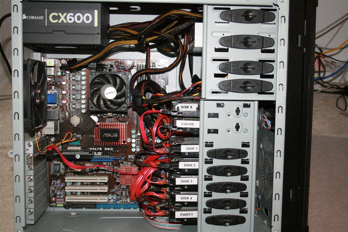

Edit to add: As a stop gap I am thinking of picking up a 4in3 cage and mounting it in the 5 1/4 bays and relocating a few drives. As you can see from the pic the cache and disk 5 have are left with no fan blowing across them.

It might just be my old eyes, but I see an awful lot of dust buildup on the metal grill behind the fan on the lower part of your server.
Perhaps a bit of server-maintenance is in order?  (as in clean out the dust clogging a third of the grill)

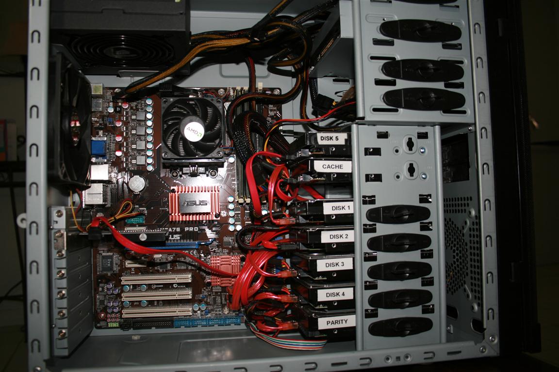

On of the problems (I think) is that the one fan up front can't possibly blow air across all 7 drives. It looks like it hits drives 1 - 4 pretty well, maybe a little of the parity drive too. Disk 5 and the cache are way out of the path of the air flow since they were floppy drive bays. Oddly enough my floppies never seemed to run hot  ;D

One of the problems (I think) is that the one fan up front can't possibly blow air across all 7 drives. It looks like it hits drives 1 - 4 pretty well, maybe a little of the parity drive too. Disk 5 and the cache are way out of the path of the air flow since they were floppy drive bays. Oddly enough my floppies never seemed to run hot  ;D
It does not need to blow directly on the disks, it only needs to pressurize the space in front of the disks.
You might be able to put a fan made for a higher static pressure in the case...  A fan designed for low noise is probably NOT what is needed.  One for a high static pressure is what is needed.
Also, make sure the fan covers all the holes in the front grill.  If the fan does not cover them all, there is no way to build up pressure in that space in front of the disks.  Make sure you close the side door of the chassis to make sure that air cannot flow around the drives.  It looks to me, unless there is some foam weatherstripping, that the lower drive rack is narrower than the upper, and that air will flow between the side of the rack and the server side when you close the side panel.  That passage must be blocked off.
I'd be inclined to add a panel made from a bit of card to cover the vertical gap that lets the air leak past the left side of the drive cage thus forcing it to go only between the drives.  I added quite a lot of card to my server to force the air to flow only where I want.  The result was well worth the time and effort and in my case meant better cooling from a less powerful 9and quieter) fan.

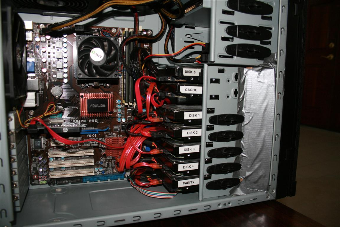

OK, who knew last nights pizza box was gonna come in handy  ;)
Closed off both sides like this after closing the openings in front of the two top drives.
Now, tape over the CPU side port on the case cover, button it up and run it through a parity check while watching CPU and drive temps. I'll bet $$ that you'll see a huge improvement.

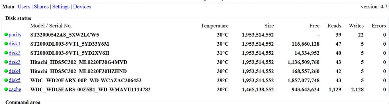

Not running a parity check at the moment but cache drive is already running 3 degrees cooler, will let it run for a bit and see where it goes.....then will close off cpu vent and compare...will report back in a little while.
In the short time I left it I did not notice a difference covering the cpu vent. I was having a problem with unmenu not working right so I stopped the array and rebooted. Not sure why but it triggered a parity check when it came back up.  CPU vent is still covered and I guess we will see what temps hit during the check.

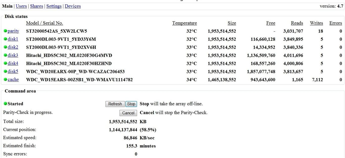

Well I was beginning to be rather unimpressed when temps crept back up to between 31 -32 degrees however I am rather impressed at the moment since I am half way through a parity check and the temp has only gone up to 34 Degrees on the cache drive, which still runs hotter then the rest.
That is still a full 7 degrees below the temp alert threshold that was setting off the over temp emails.

That is MUCH better.  Amazing what that re-purposed pizza box did.
