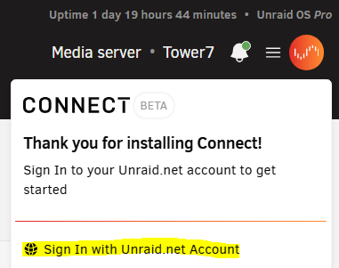

Now reboot the server, reinstall the Connect plugin, and try registering the server once more, make sure you are doing it from the dropdown:

I'm on version 7.2.3 and was also stuck with the "Sign In Failed" error. I was able to complete the registration as follows:
  1. in the terminal window, call unraid-api stop
  2. in the GUI (Settings -> Unraid API Status) click on "Restart API" (could have probably done this in the terminal window as well, but I'm an Unraid newbie)
  3. open the menu (orange icon) and click on "Sign In with Unraid.net Account"
