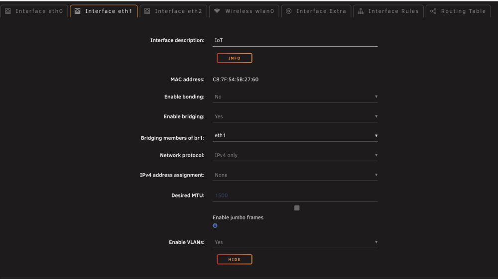

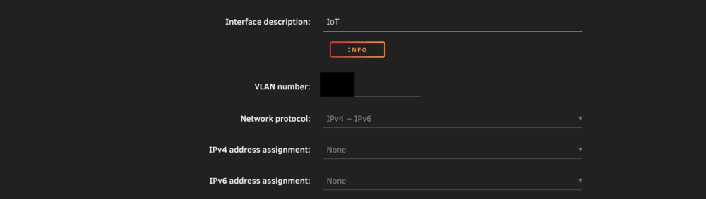

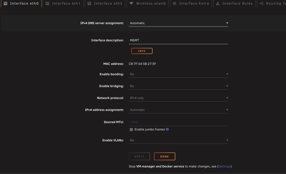

I attach my config for the NICs:
ETH0
ETH1:
Bildschirmfoto 2025-11-26 um 15.34.20.pngBildschirmfoto 2025-11-26 um 15.35.26.png

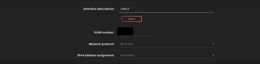

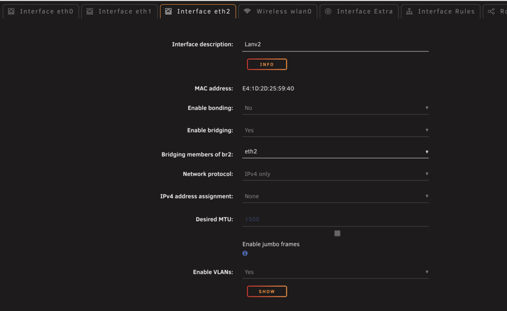

ETH2

it would be simpler to put eth1&2 on a untagged port.
If you have several interfaces unraid don't need to be vlan aware.
You can use one interface with sub interfaces in each desired vlan (that's what i do) or several interfaces, each one in the desired vlan.
